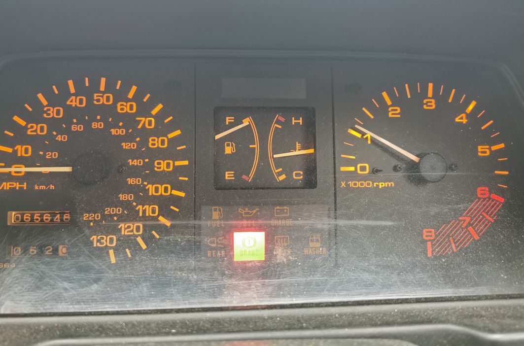

Six-cylinder Posted November 14 Author Posted November 14 A bit disappointed with the Mazda 323 GLX 1.5 today as I filled it with petrol and checked the fuel consumption for the first time. 33.1 mpg, I was hoping for 35-40 mpg. Maybe the fault is the engine bay is very dirty and it needs its air filter box painted. The roads are like trails of water today so it has had a good under body wash. Stinkwheel and RobT 2
dozeydustman Posted November 14 Posted November 14 Should do 40 on a decent long run. Hopefully it’s just a case of needing a new air filter and a mixture tweak. Six-cylinder 1
AxWomble Posted November 14 Posted November 14 Is it running cool? That knocked our old AX down from 47mpg average to 32mpg. Worth checking the stat isn’t stuck open and using an IR thermometer to check that the coolant is getting up to temp properly
Six-cylinder Posted November 15 Author Posted November 15 21 hours ago, AxWomble said: Is it running cool? That knocked our old AX down from 47mpg average to 32mpg. Worth checking the stat isn’t stuck open and using an IR thermometer to check that the coolant is getting up to temp properly It seems to warm up quick enough but reads just under half after 40 mins easy driving.
hairnet Posted November 15 Posted November 15 seems ok is the carb ok? slightly worn but ok otherwise
Six-cylinder Posted November 15 Author Posted November 15 53 minutes ago, hairnet said: seems ok is the carb ok? slightly worn but ok otherwise Idle is a bit erratic, sometimes 900 rpm, other time anything up to 1700 rpm.
dozeydustman Posted November 16 Posted November 16 I wouldn’t say that’s running cool. It’s between the 2 marks albeit not central. I would be more concerned if it was nearer the bottom or above halfway. Take it for a proper long motorway run and if the temperature starts dropping at speed, especially now the cold is drawing in, it’s probably a thermostat - that’s how most of my previous cars with temp gauges have behaved when the stat has stuck open. If it stays rock solid it’s just how that engine runs and might just need a tune up. Found some data online at https://www.automobile-catalog.com/performance/1986/1629980/mazda_323_1_5_glx.html Six-cylinder 1
