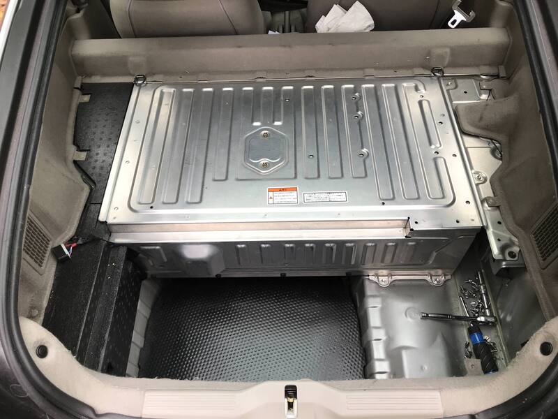

If you were wondering what's under the carpet in the back of the Insight, there's a big aluminium battery cover and under that is the battery on the right hand side and all the control gear on the left. Edit: spare wheel is under the dimpled black cover down at the bottom. There's quite a lot of empty space underneath and down the sides. It's not the best use of the space IMO!
