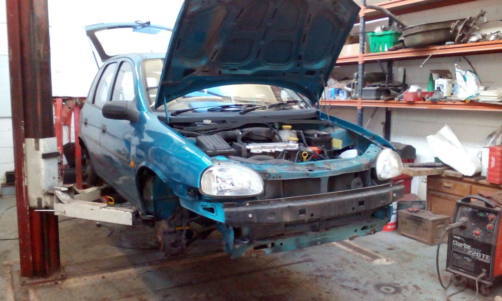

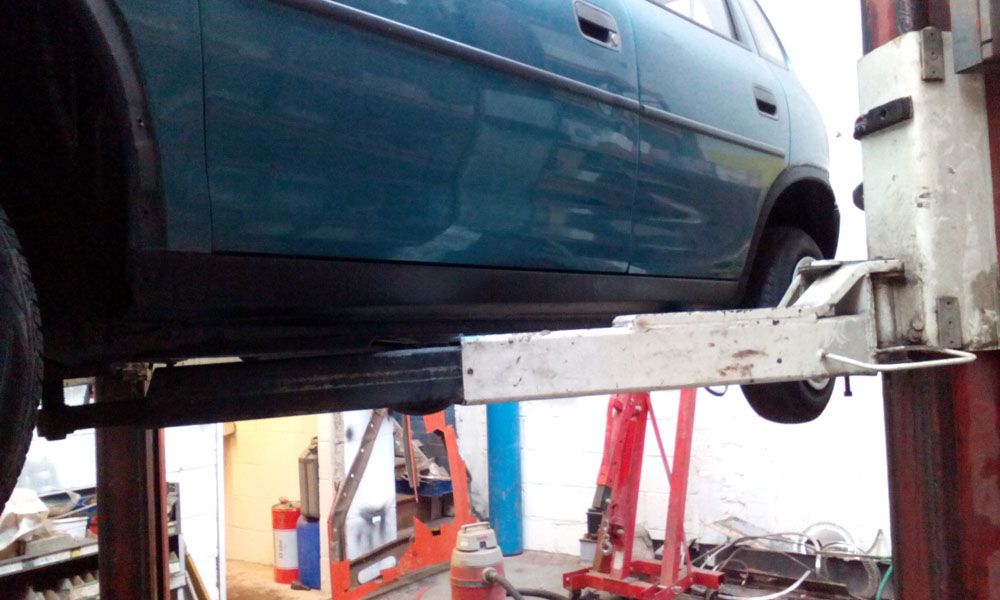

Pulled Nugget into the unit, up on the two post lift, all wheels/arch liners/bumpers off to inspect how bad the rot was.

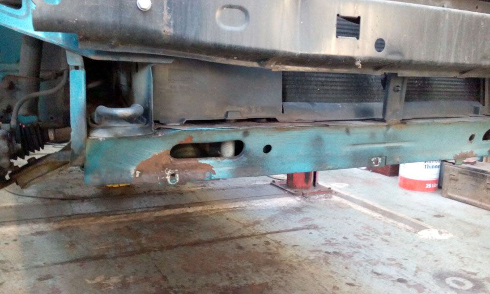

Rust under the front and rear bumpers wasn't actually too bad. Just surface stuff really.

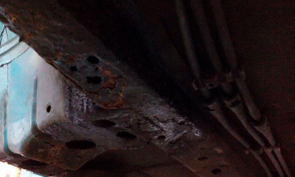

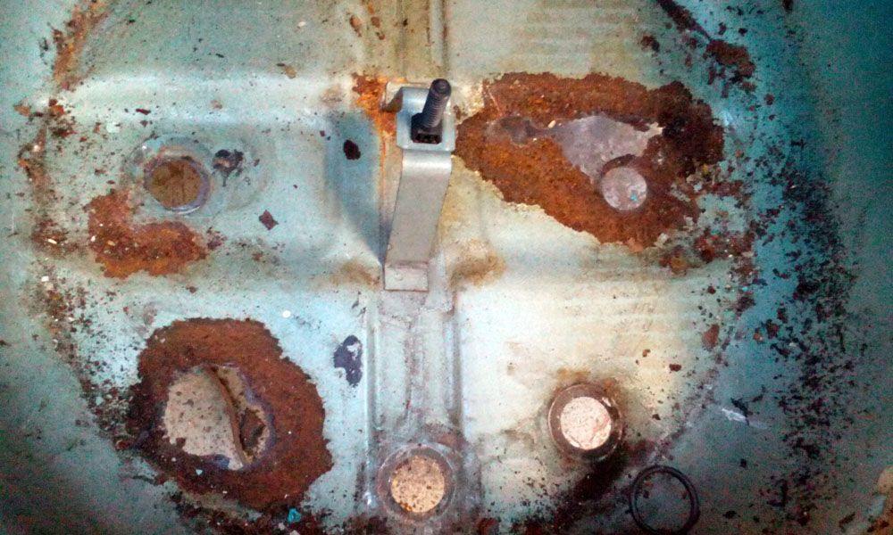

The spare wheel well on the other hand.. oh dear oh dear. This was taken after I'd poked at it for a bit with a screwdriver, as you do.

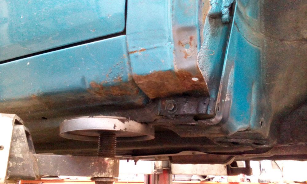

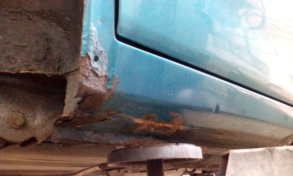

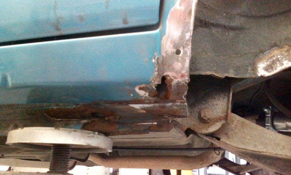

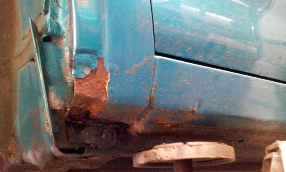

The sills were fairly bad at the front and rear of both sides, which is where they always go. Some large holes, some not so large holes. Nothing a bit of welding couldn't sort. Four pics of the sills.
Near side front.
Near side rear.
Off side front.
Off side rear.
Also some minor corrosion in the off side chassis leg at the front. I ended up plating it.

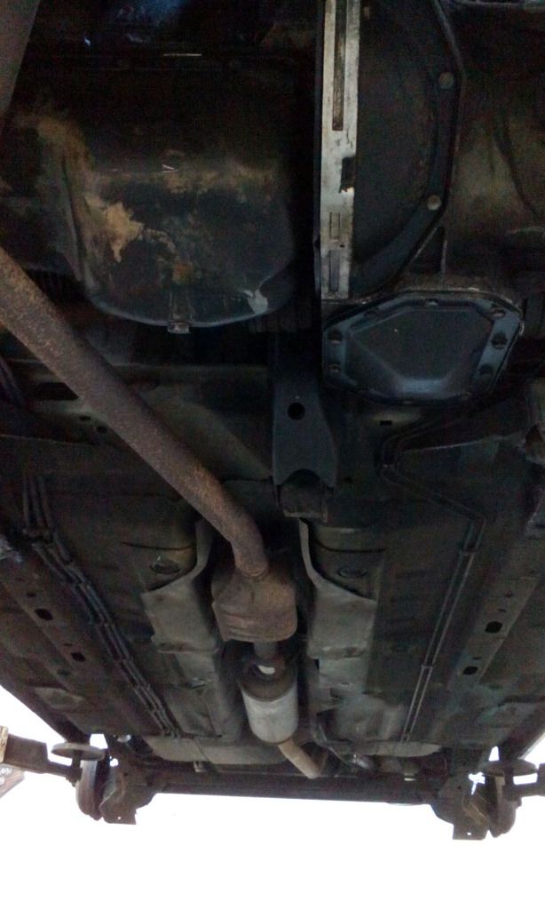

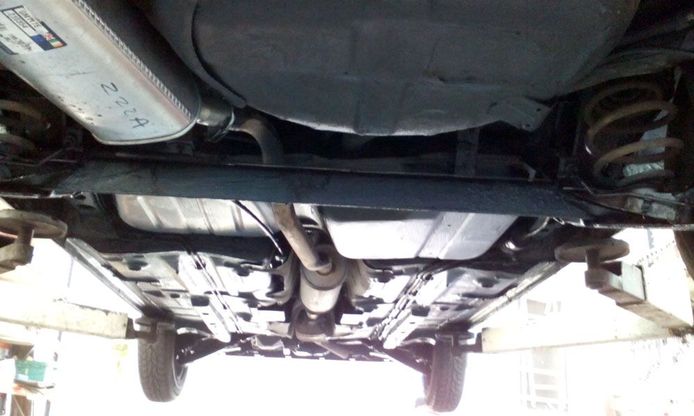

All-in-all Nugget is pretty damn solid underneath considering how old she is. This is a pic taken with just a simple clean and a hose down with water.

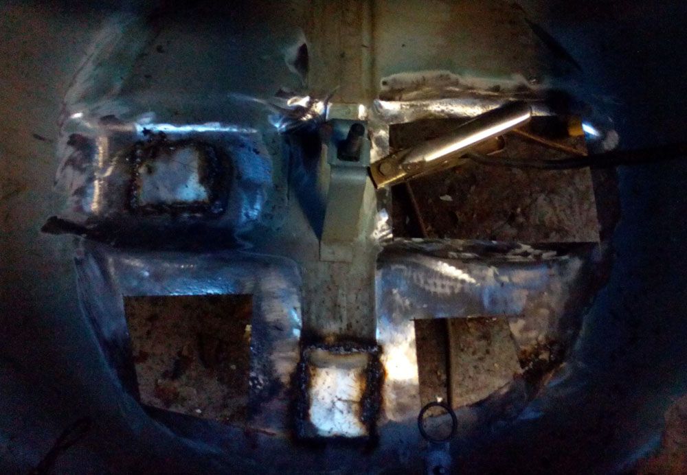

Cut the rot out of the spare wheel well and plated it up. Yes I know my welding is shit. I'm not a welder. It's functional and strong, I don't care if looks like a pigeon shat on it.

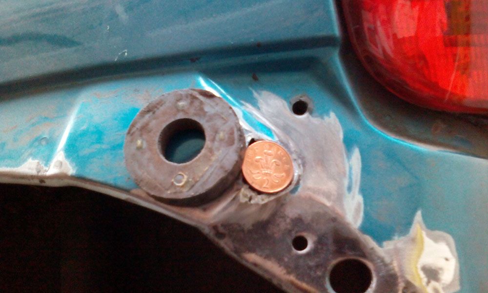

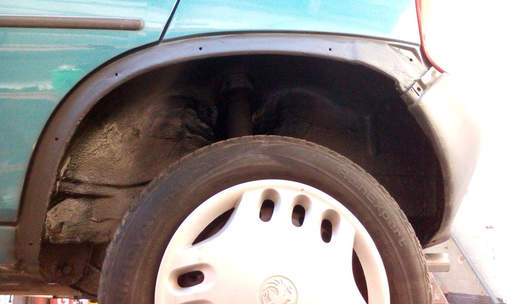

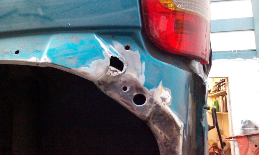

The upper parts of the rear arches were starting to go, so I tended to these holes as well. I couldn't be bothered making a plate for this, so..
.. yeah that looks about the right size. I've added to the value of the car.

Now that the welding part of the job was complete I proceeded to clean the underside up and stonechip it, with underseal on top of that. It went rather well.

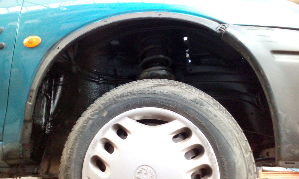

Front arch and lip. Bumper back on.
Wheel well fully plated up (and painted with proper body colour paint and lacquer on the inside) and underside undersealed.
