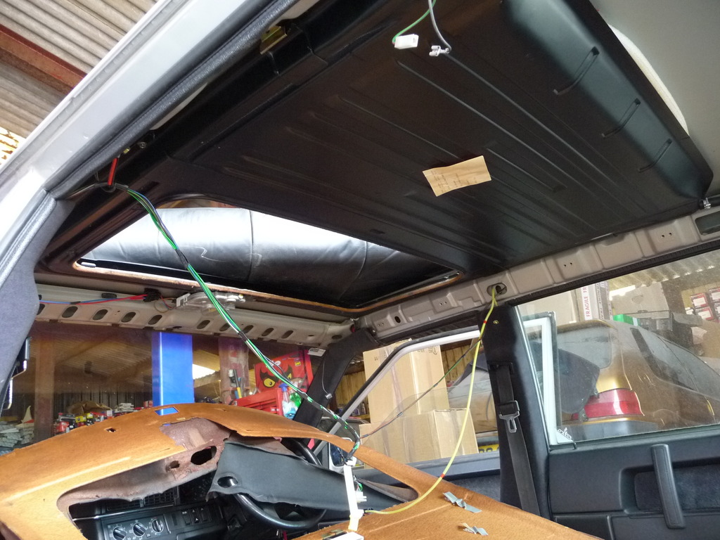

Yeah. Roof looks fine. Cool in fact. And for what it is, who cares? As long as it is running/welded. Or stick some fuzzy felt up there if it bothers you. post-18080-143193325953_thumb.jpeg
Eh? It looks flippin rubbish with no headlining. I think I am gonna try to fibreglass it.

I got the headlining sorted in the end. I went with the fibreglas idea which worked pretty well. I bought 500ml of cheap resin off the bay and a sheet of glass matting, fairly tightly woven.
I laid the headlining out on a big piece of plywood and put on a couple of layers of mat. Stippled loads of resin on, and rolled out the air bubbles as best I could with a roller. Did the same on both sides - although originally I didnt want any fibreglass on the 'visible' side I decided it was worth it for the rediced risk of busting it again during refitting.
That actually worked surprisingly well and gave it plenty of strength back in its fragile bits.
I brushed the rest of it with thinned-down PVA glue as well:
Don't know if that did any good or not but can't have done any harm.
Once it had had a couple of days to dry out properly I brought it in the house for stage 2:
bought a big piece of the pukka black headlining fabric off eBay for about £25. Spent another tenner on a couple of cans of 'trim-fix' glue and employed textiles expert Mrs Crab to help me make a neat job of it.
Looking good so far - I had been worried it might wrinke up on the curves round the 'bubble' for the rear passengers heads but we got it nice and tight and avoided any mess. Difficult to see the fibreglass repairs too, but theyre not completely invisible admittedly.
we trimmed a good 2" margin round the outside of the board and folded the fabric over and taped and glued it on the back to make a neat job, no pics of that though.
That was amazingly successful so, while on a roll we went up the garage and reinstalled it straight away:
To my surprise it went in farily easily, couple of hours and it was all done including cutting out and trimming the hole for the sunroof
Excuse the shitty phone pics, I forgot my camera
Anyway its all done and refitted and I have to say, looks the flippin bollocks!!!
This was probably the trickiest job left to do so i am super chuffed its done and has turned out so well. Cost about £50 in materials and a quite a lot of hours fannying about but I am well happy with the results. This thing should be hitting the road imminently!!
