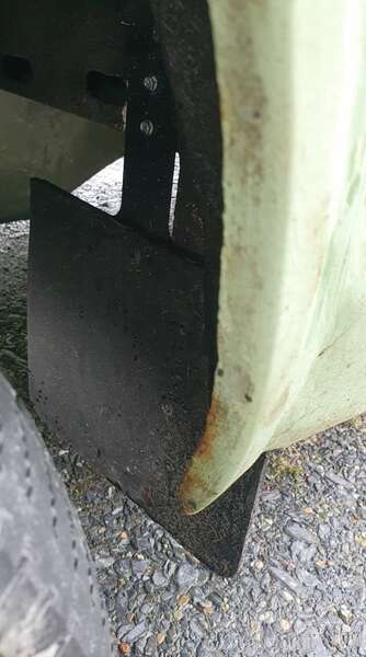

mat_the_cat Posted April 2, 2023 Author Posted April 2, 2023 Think I've got my money's worth from these! New ones were a slightly different bracket design, but look the same once fitted. And after driving round for a few weeks without one, it's clear they do stop a fair bit of shite being thrown all over the underside! mercedade, Tickman, cobblers and 2 others 5
