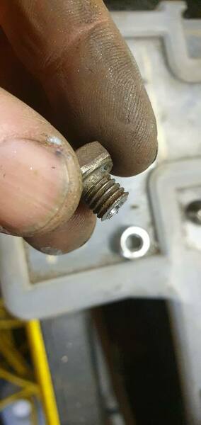

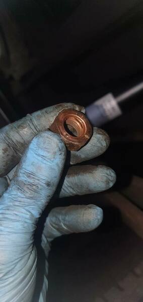

In 16 years only one fastener hasn't been reusable, and I'm impressed by the negligible corrosion on the damper bolts after 29 years and nearly 300k miles.
Even the nuts are copper plated to prevent seizing, something I've only ever seen on exhaust manifolds before.

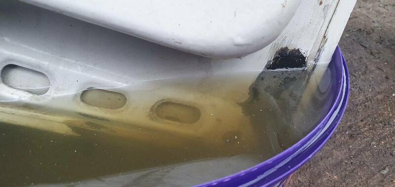

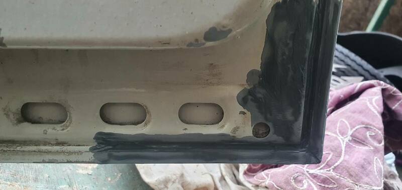

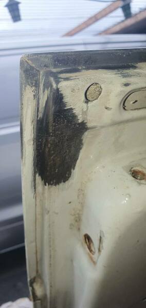

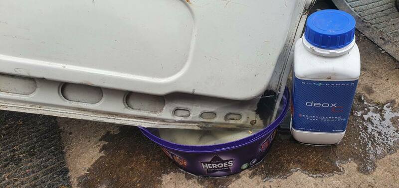

Cleaning up the rear of the door I noticed a few more rust spots. This is by far the worst, so not a disaster.

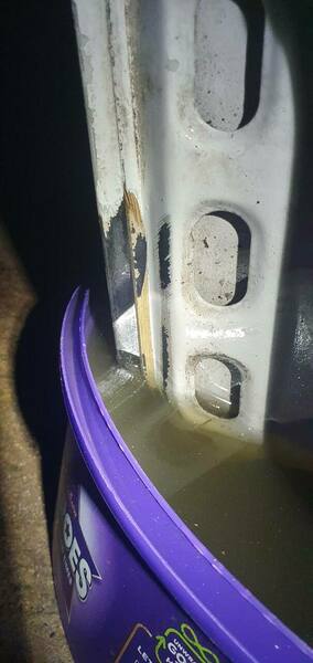

I was going to treat with gel, but then I realised I could just about dip the corner in Deox C liquid for speed and effectiveness.
After a few hours immersion, most of the submerged rust has gone.
Some of the deepest pits remain, plus the part which was above the liquid,so I've flipped the door round to get that in.
The area which was previously submerged has cleaned up nicely, so hopefully the whole thing will have by the morning.
  • Like 8
It took another day of immersion, but all rust now gone. The black spot you can see is actually a pinhole, so the metal is very thin. At least I know the inside is similarly rust free now too.
I've dipped the opposite corner in there too - there was next to nothing showing on the outside but I know it must have got into the seam slightly. Still, for a 25 year old door I'm not complaining!
The de-rusted corner has now been protected with a coat of Zinga; as an added bonus the pits left by the rust removal give excellent mechanical adhesion - it won't stick well to a smooth surface.
  • Like 10

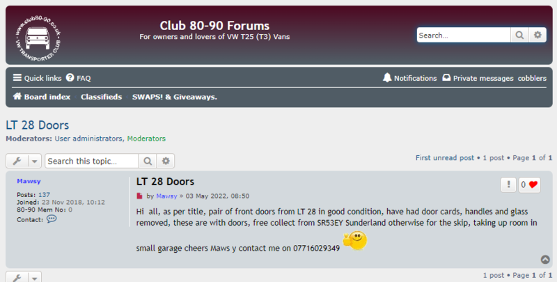

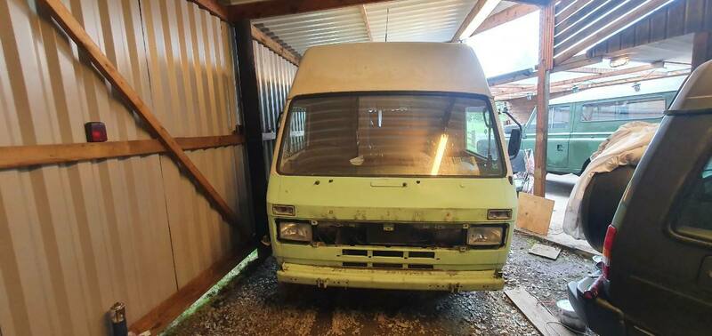

These may be of interest to you?
Bit of a trek for you, but you do have form for driving a long way to collect doors!
The front doors aren't too bad thankfully (although free is always tempting!)

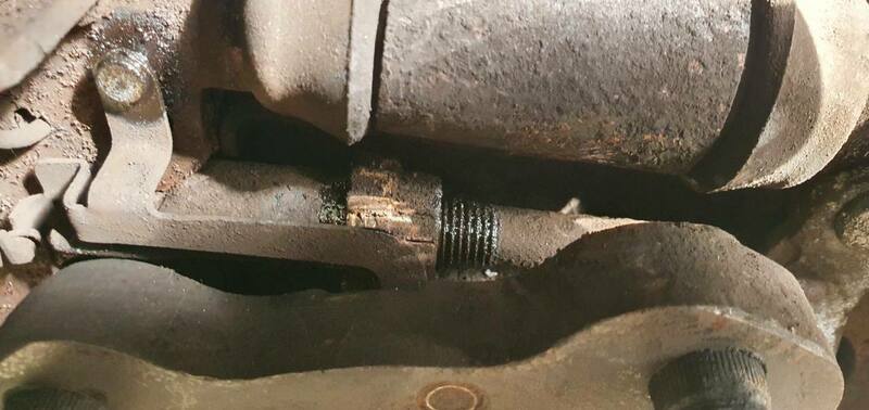

It's struck me that a possible reason for the long brake pad life could be the fact the caliper pistons are rusty!
This is pretty disappointing, as I fitted  new calipers in 2013, and I rarely take it out in the salty winter. The pistons don't even seem to have any plating, so have rusted at the first sign of water. The dust seals had popped off on this side, being (not) held on by a wire spring clip.
The new seals have a rigid portion, which is a slight interference fit on the caliper body. If the effort to fit them is an indication of how well they'll stay on, they should be ok!
Both pistons are now moving freely, so onto the original job of pad replacement. One side down!

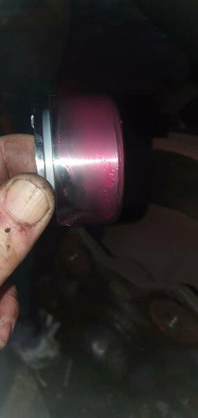

Inside of the caliper cleaned up ready for the new seal:
Piston lightly smeared with rubber grease:
This means that any moisture getting past the dust seals shouldn't corrode the caliper or pistons.
Job done!

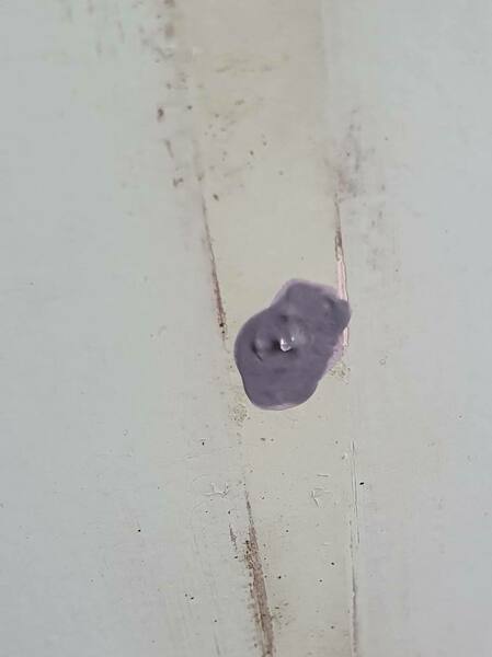

While I wait for that to arrive I did a little cosmetic job. When I bought the van it was being used as a motorbike race van with an awning channel roughly screwed to the side (see first post for a picture). We replaced the top piece with a roll-out awning, but left the the vertical channels in place as I didn't really want to weld up the holes and risk setting fire to the insulation.
But then I had an idea. First of all droll out the self-tapping screw hole and countersink it.
Then fit a sealed countersunk rivet.
Dipped in Zinga prior to riveting, and this is the result.

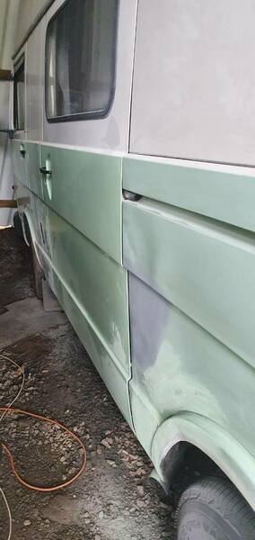

The front and nearside are painted, so am planning to do the rest before the weekend is out. Unfortunately working Friday though :-(
As usual, jobs spiral to become bigger than first intended. There was a couple of pinholed areas around the wheel arch, so had to let in new metal.
Not a pretty job, and as new arches are available I think it'll be getting a pair in the next 5 years or so.
Then the laborious task of flatting back, guide coat (using up my random off-white aerosol cans), flatting back again etc.
The repaired areas were given a coat of green for better coverage, then the whole lower half was rollered.

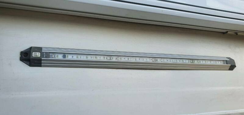

Inbetween coats of paint I did one or two little jobs, including sorting out the LED strip above the sliding door step. Id bought a roll purely on price around 10 years ago, and it didn't last at all!
The strip from Toolstation seems to last, so have soldered that in (a bit longer than the original too).

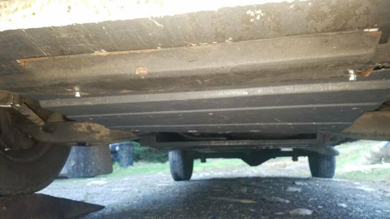

Remember I obtained a hard to find undertray around the turn of the year. I subsequently found I was missing the section which joins the front and rear halves together.
I've finally got round to making up an ally sheet to bridge the gap, using the old door skin from the Series 3 Landy.

About that engine oil leak...I couldn't just ignore it, so took a closer look. Bugger.
Thanks to several years running without any undertray, the sump has rusted and pinholed through! With the oil cold, it's too viscous to flow anything noticeable, but when warm it's a significant drip. Magnified by the heatwave we've been in!
Now I quite enjoy a bit of tinkering time on holiday, but even I draw the line at the time taken to drop the sump on a campsite, and then cycle to try and find somewhere who could weld it back up again. So I admit that I've bodged it.
One metal roofing screw (with built-in rubber sealing washer) later, I think it's a success! It's amazing what you can buy in a French hypermarket, right down to car batteries and filters. I guess it says a lot about how many folk still DIY on their own vehicles compared to the UK...
