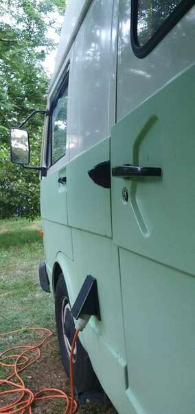

mat_the_cat Posted June 22, 2023 Author Posted June 22, 2023 We've made it nearly 1000 miles into France now, and all seems well. I loaded it up with the Stellar gearbox, and dropped that off on the way. Importantly I've got a new UK sticker to replace the old GB one! First night in France was in a quiet (and free!) aire we've stayed at before. Next to a lake and nature reserve, and the neighbouring campsite lets you use the facilities for a Euro. Having the battery monitor has enabled me to see exactly what is going on. It's possible to 100% charge the LB bank with the alternator alone, but takes way longer than I'd have thought. And if the AC is on, this drags the voltage down to a level which they will never fully charge, around 92-93%. I suspect this would have been a lot lower with the old 13.8V regulator installed. Today we visited a chateau in Savigny les Beaune, which had a load of Abarth cars in a museum on the grounds. As well as planes... ...fire engines: and literally hundreds of motorbikes! Well worth a visit if you're in the area. dollywobbler, Rust Collector, Dyslexic Viking and 13 others 16

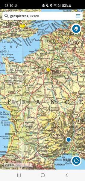

mat_the_cat Posted June 25, 2023 Author Posted June 25, 2023 That's the one, yes. We've now made it down to our destination, and looking at it on the map does seem like a long way from home in a 30 year old, high mileage vehicle. It might sound strange, but my confidence (in my own mechanical checks, as much as in the vehicle), really took a knock after the clutch problem earlier this year. To have something fail with no warning, which was impossible to check for, was not good in a vehicle that I'd always considered complain reliable. Starting to relax a little bit now though. Temperatures are high, and mountainous roads not ideally suited to a van, but suspension, engine and brakes have coped with the workout. This was us parked up at 1500 metres elevation for a night, and almost had to use the heater as the temperature dropped rapidly! We're a lot lower now, and night time minimums are mid-20s so rather warm! Our dog is enjoying it too, especially when she can smell the barbecue! As ever in France, further south there are more interesting spots, although less each year. Asimo, AnnoyingPentium, CreepingJesus and 14 others 17

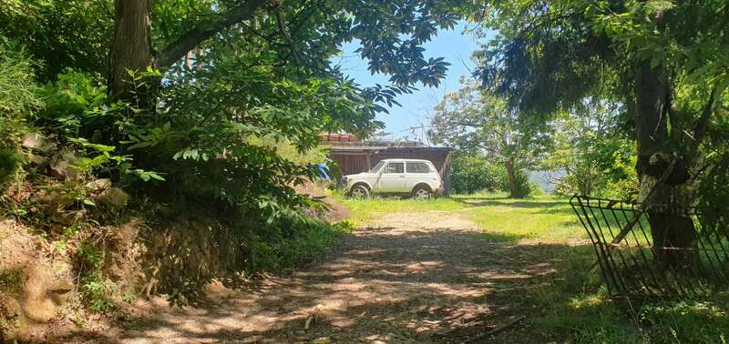

mat_the_cat Posted July 23, 2023 Author Posted July 23, 2023 Nothing to add apart from a photo from the holiday... Dave_Q, cobblers, Coprolalia and 5 others 8

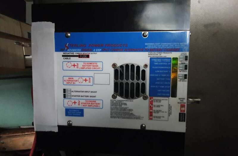

mat_the_cat Posted September 15, 2023 Author Posted September 15, 2023 Update on the Sterling charger is that it really does work a treat. Charging from 95 to 100% previously took around 300 miles to complete, but now it's ~40 miles. Before I fitted the battery monitor I'd have had no idea, both of the state of charge and the slow charging rate. I've also discovered that the Afterburner controller draws around 0.3A, which is fairly significant when parked up for a few weeks. We've recently had to say goodbye to our dog so the house feels rather empty, so we've been getting out and about a bit more than usual. Some lovely quiet spots to sit and watch the sun set. mercedade, rainagain, High Jetter and 5 others 8

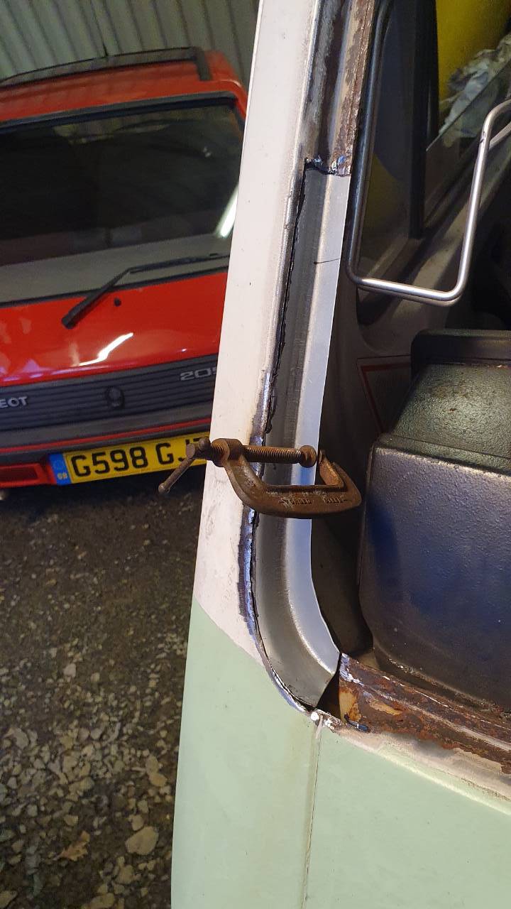

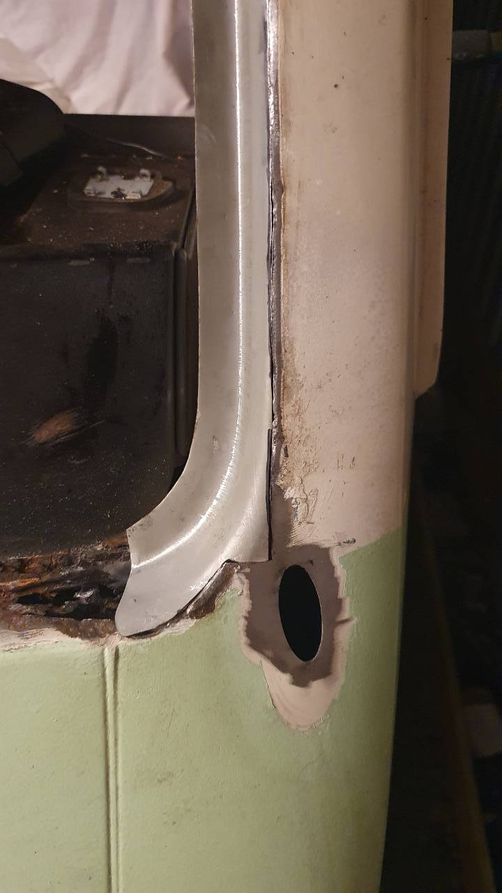

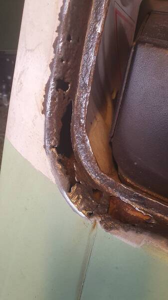

mat_the_cat Posted March 16, 2024 Author Posted March 16, 2024 Not one to rush a job I've made a start on the A pillars. I was right, there was more rust hidden! But I've already bought the A pillars, which I initially thought would be all I needed. However the lower panel has also holed through in places, so will need to find one of those, or make up a repair strip from some angle section. I've cut out the worst of the rot now but am leaving the lower bit until I know what I can replace it with, as that will dictate where I cut. Also need to fix the welder before I can do anything! At least it makes it easier to replace the aerial now! Matty, RayMK, Sunny Jim and 13 others 16
mat_the_cat Posted March 22, 2024 Author Posted March 22, 2024 Big shout out to https://www.weldingdirect.co.uk/ who had a new control board on the shelf for a 10 year old Chinese welder, and only £26! Back to the LT, and I cut back a bit more of the pillar which had been thinned by rust. It's very little extra work to weld in a larger section, compared with battling constantly blowing through. I didn't want to use the whole repair panel though. Reason being to weld in the top it would be quite tricky welding in the roof gutter, and potentially difficult to seal well again afterwards. So I wasted most of the panel and just cut out what I needed. Unfortunately I had to leave it there as despite wearing goggles I got something in my eye, so writing this post from hospital. Popsicle, JMotor, rainagain and 12 others 15

mat_the_cat Posted March 23, 2024 Author Posted March 23, 2024 This is the 5th time now for me! The first was my own fault for only wearing glasses rather than goggles, and once was unlucky when I flipped the welding mask up too early to get a faceful of cooling sparks. I've even taken to closing my eyes whenever possible. For the section below the windscreen I did wonder about buying a complete panel again: https://coastalmotorhomes.co.uk/volkswagen-lt-front-scuttle-panel-1975-1996.html But it's a little different cutting up a £30 panel versus a £100 one! There is a little curvature in both directions, but I'm pretty sure it will be simple to make it out of a standard angle section: https://www.the-aluminium-shop.co.uk/galvanised-steel-angle? I generally prefer welding in proper hot-dip galvanised steel, especially when overlaps are involved. I do tend to use weld-through primer, but I figure that if moisture is going to potentially sit between two layers, it's going to be vastly better to have a layer of zinc metal rather than a layer of paint. Just have to be a bit careful with the fumes, and grind back a bit before welding. Talbot 1
mat_the_cat Posted March 24, 2024 Author Posted March 24, 2024 I've now trimmed the repair section for the other side. I'd wanted to have the joint on the curved section under the seal, both for neatness and also to minimise distortion. However on the passenger side I needed to cut out that little bit more, as the metal was quite thin. I've also cleaned up both sides ready for welding; I've since painted with weld through primer but didn't get a photo. Coprolalia, MorrisItalSLX, Back_For_More and 10 others 13
mat_the_cat Posted March 25, 2024 Author Posted March 25, 2024 Primed and ready to weld in: Ideally I'd have left the aerial off, but access is incredibly restricted behind - the original poked through from the back and was tightened from the outside, but all I can find to replace it need tightening from the rear. I'm hoping I can reach the back to tighten, but don't rate my chances of actually threading the nut on! Then began the long process of welding it in, swapping sides regularly to allow to cool. Driver's side is done... ...but I ran out of gas when the passenger side was almost complete I didn't quite cut it perfectly at the bottom, so need to bridge the gap with weld. RayMK, Sunny Jim, Dick Cheeseburger and 6 others 9

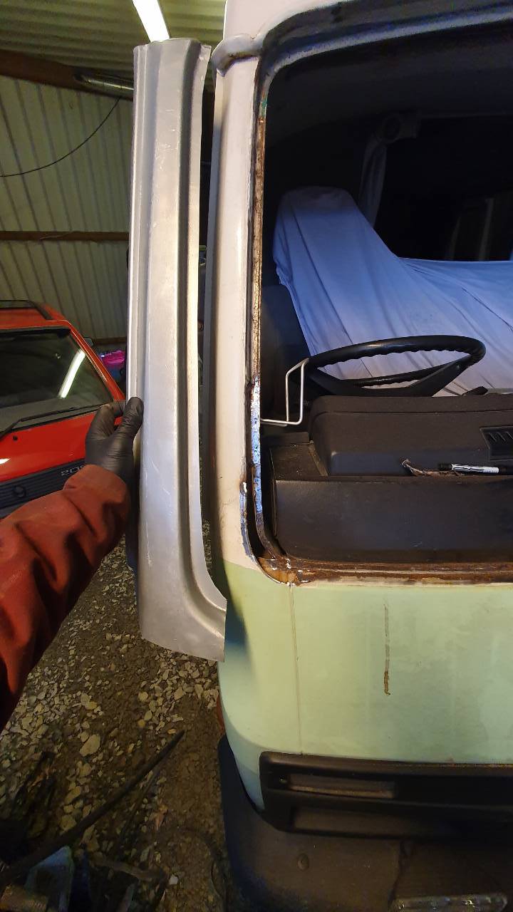

mat_the_cat Posted March 29, 2024 Author Posted March 29, 2024 I've finished off both pillars now, and cut away the rusty lower lip. Ahhhh. The inner panel is in a similar state. I will have to rethink my plan, but reckon I'll have to cut out more of the front panel for access - which means it'll be more difficult to neatly weld in a length of standard angle section. However I can probably use that to weld in a functional repair to the hidden panel, and buy the proper repair panel for the visible outer repair. juular, rainagain, RayMK and 6 others 9
Minimad5 Posted March 29, 2024 Posted March 29, 2024 Well done for not just slapping a load of filler on this 👏 Neat looking repairs too juular 1
juular Posted March 29, 2024 Posted March 29, 2024 11 hours ago, mat_the_cat said: I've finished off both pillars now, and cut away the rusty lower lip. Ahhhh. The inner panel is in a similar state. I will have to rethink my plan, but reckon I'll have to cut out more of the front panel for access - which means it'll be more difficult to neatly weld in a length of standard angle section. However I can probably use that to weld in a functional repair to the hidden panel, and buy the proper repair panel for the visible outer repair. Liked for the doing it properly approach. If you cut off more of the outer panel, can you not weld it back on once you're done, then continue with the angle section repair? If you cut it out with a thin 0.8mm disc it'll fit back together beautifully. JMotor and mat_the_cat 1 1
Dick Cheeseburger Posted March 29, 2024 Posted March 29, 2024 Neat work, Matt. I'd be inclined to relocate that aerial though... Asimo and mat_the_cat 1 1
mat_the_cat Posted March 29, 2024 Author Posted March 29, 2024 10 hours ago, Dick Longbridge said: Neat work, Matt. I'd be inclined to relocate that aerial though... Go on, why...? I have fitted one to the roof and end up twanging it regularly so planning to go back to the original position.
mat_the_cat Posted March 29, 2024 Author Posted March 29, 2024 10 hours ago, juular said: Liked for the doing it properly approach. If you cut off more of the outer panel, can you not weld it back on once you're done, then continue with the angle section repair? If you cut it out with a thin 0.8mm disc it'll fit back together beautifully. That's something I didn't consider, but I'm finding it tricky to bend the angle section to the curvature required. It could be done easily with a stretcher, which I don't have. I think I'd have to make several slits and weld them back up afterwards, so it could still be done although I'm tempted by the lazy option!

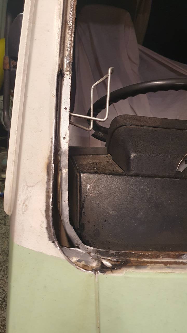

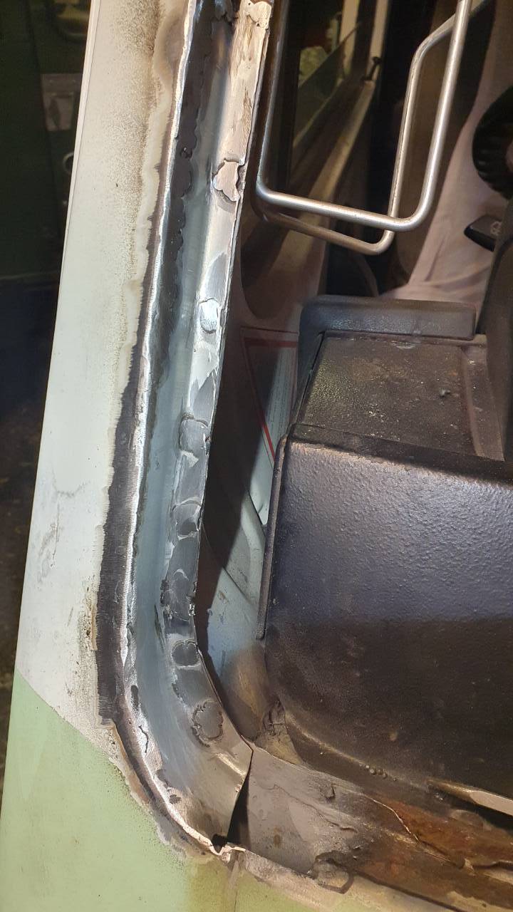

mat_the_cat Posted March 30, 2024 Author Posted March 30, 2024 The inner panel is now cut back to decent metal, revealing rust which had crept between the layers of the lip. Before cleaning it up I welded the marks from the spot weld drill. I wanted to make sure the metal was full thickness so when it comes to welding the layers together I can crank up the current without risking blowing through. It took a while to remove the rust, as it had pitted quite deeply in places. There's a little bit of light rusting on the inside, which I've treated with phosphoric acid to hopefully stop it getting worse. I'll inject with cavity wax after welding, obviously. One casualty was the angle grinder I use for knot wheeling - only a cheap one so really a disposable item. Lacquer Peel, Dyslexic Viking, JMotor and 8 others 11
mat_the_cat Posted April 5, 2024 Author Posted April 5, 2024 Work on this has slowed slightly for two reasons. Firstly we are now having guests staying in the Airstream, and I don't think they would appreciate angle grinding during their stay. And secondly my welder had failed again! A different fault, but I traced it to the new board I'd been sent. I contacted the supplier, rather expecting them to suggest that another fault in the welder must have damaged their replacement board. But fortunately they sent a replacement out to me but agreed it was rather puzzling. To my surprise the next day two arrived!! They decided to send two from different batches just in case there was a more widespread issue and i suffered another premature failure. Over and above as far as I'm concerned. Back to the van and I actually managed to do a better job than expected in curving the inner repair section. I started by cutting a few slots in it, but when I started flattening out the 90 degree angle to match the original, found it naturally started curving in the right direction! I drilled out to match the position of the original spot welds... ...and have begun the steady process of welding it all into position. I did bite the bullet and go for a new panel in the end - I think this will enable me to do a neater repair and hopefully avoid needing to use filler. It's still a zinc coated panel so should be better at resisting rust, even if not hot-dip galvanised as the inner layer now is. Dyslexic Viking, juular, mercedade and 10 others 13
mat_the_cat Posted April 6, 2024 Author Posted April 6, 2024 The inner panel repair is now complete. So I then made a couple of holes in it! Just so I could inject some cavity wax into it, as it's far easier to do it from above - and it also is so penetrative, it highlights any pinholes in the welding. I've hacked up my new panel, and sat it in the correct position... ...before beginning the slow process of trimming to match what I've cut feom the van. Dyslexic Viking, Coprolalia, juular and 14 others 17
