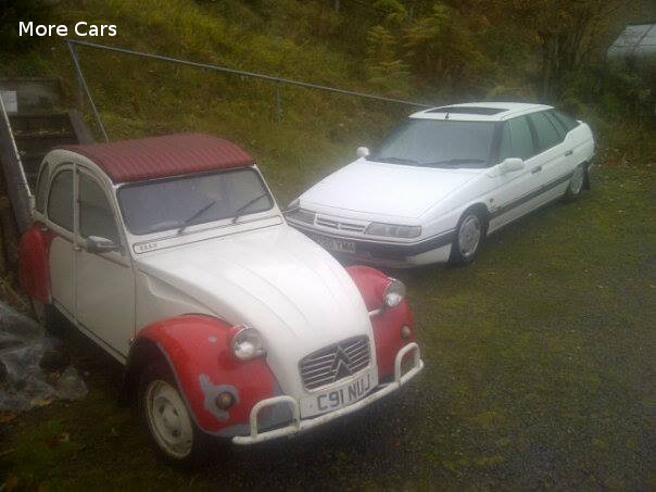

Anyway, here's a murky shot of the fleet this morning. Nice pair.

That's not murky, that's soft focus.  Get a room, you two.

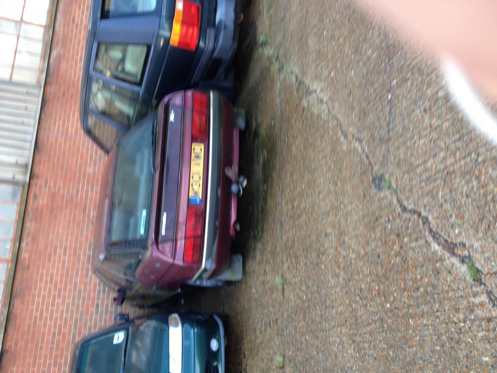

I walk past this old girl most days to work and its stuck in an old rail yard.
It's is a pez 2 litre turbo Xm which and has only done around 70000 miles..
I do see the guy who owns it from time to time and he's a smashing bloke and I know he's thinking of getting rid of it as he hasn't used it for some time as you can see from the pictures.
if you want I could have a word with him next time I see him as it maybe good for some spares or if your very brave to put back on the road.
