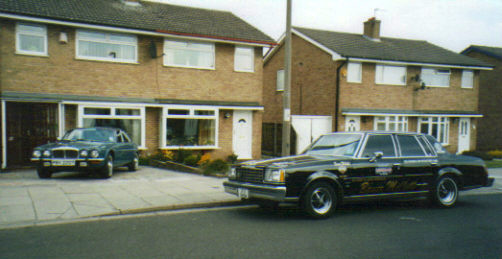

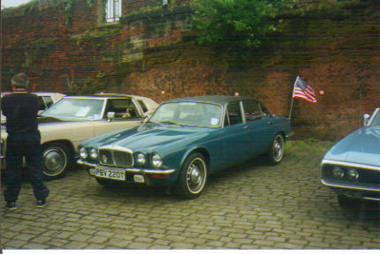

eddyramrod Posted September 22, 2014 Posted September 22, 2014 Here's the one I had 12 years ago...1978T Daimler Sovereign LWB 4.2 auto, as intended. I loved it, but the AED, as mentioned in an earlier post, was constant trouble, and you do have to keep your eyes on, well, every bit of metal, for emerging rust. If you can see it, of course, it's too late. 14mpg (if driven like a granny) was a bit of a shock, but I hardly ever saw that as I tended to drive like I was filming The Sweeney. 6am commute down country lanes...It's the far side of 16 ft long, so yes, fitting it in a garage is a challenge, but mine lived outside all the time I had it, in Southport which meant constant exposure to sea air. Also, I used it as my daily, winter and summer. It was a very lovely place to sit if you could get in! I had a problem with the driver's doorlock freezing up in the winter, so much so that instead of putting my windscreen protector over the screen at night, I would hang it down the rear edge of the driver's door, trapping it top and bottom so I'd have a chance of getting back in when I needed to.I only sold it because I'd bought a Buick......and couldn't afford to keep both. And we all know what I think of a Buick! So it won, and the Daimler moved on, to a customer of the garage who'd been dealing with it for me. Not long after, it reappeared in the yard, where it sat for years gradually disintegrating. You do need to have a bit of budget backup to take on one of these. I didn't, and it seems neither did the new owner. I believe the poor thing was eventually scrapped.That black one looks delightful, with the simple proviso that the standard steering wheel needs refitting immediately. Buy it, Waxoyl it, keep it on your driveway, use it daily. That's what they're for! cort16, Skizzer, danthecapriman and 1 other 4
