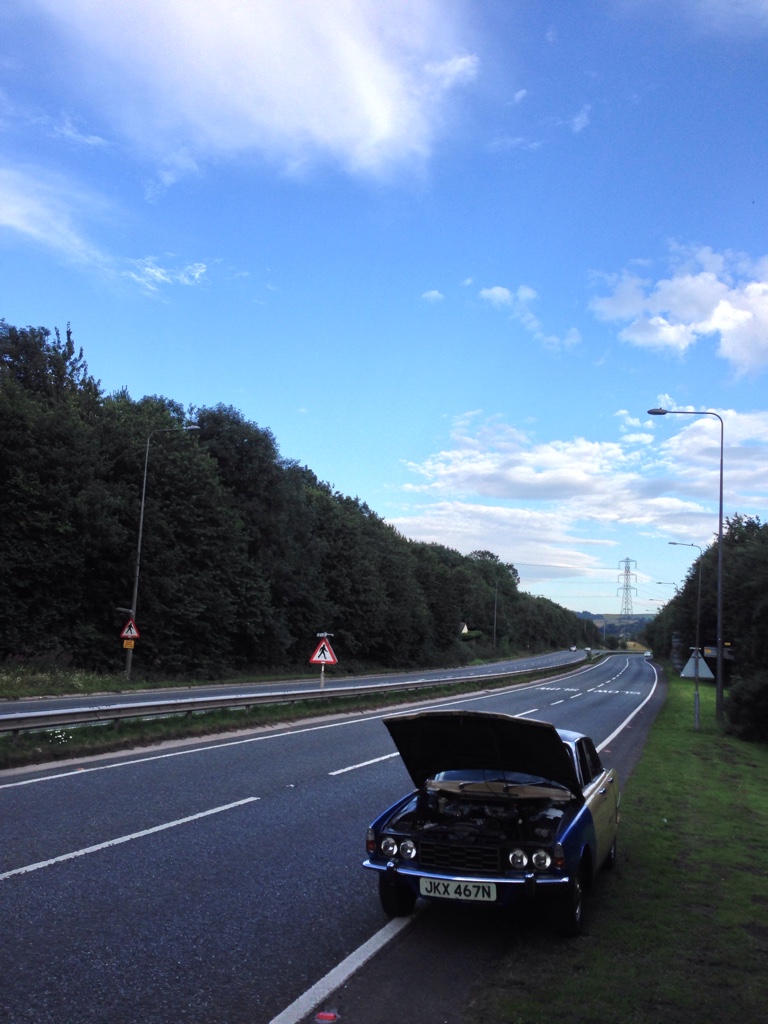

No, it just started losing power. Revs fine in neutral, but as soon as it's under load it goes to bits.
It limped off the motorway but is currently abandoned in a layby. Because it vapour locked again while we were trying to diagnose it. (Eye roll)

You're getting the composure of your pictures quite nice. I reckon a few more breakdowns and you'll have cracked it.
The last pic is so lovely that I couldnt help LIKEing it.
Its a shame tat the subject matter is so infuriating.
What the picture doesn't tell is that this happened on the test run after an electric fuel pump was installed today. The car did perform beautifully for about an hour, then all of a sudden started to play up again. The diagnosis revealed, that there is definitely petrol arriving at the fuel pump, the pipe from the tank is not blocked or anything. Also, when petrol is actually arriving at the carburetters, it runs like a fucking new car. But sometimes and rather suddenly, no petrol arrives at the carbs, or rather, very little. When this was acute, I felt the fuel pump and it was a bit too hot for my taste. On my car, it's only ever merely lukewarm at best. Equally suddenly, the petrol resumes flowing and the car ultimately performed flawlessly from where the pic was taken to home. Much head scratchage is currently happening. I can't bring myself towards believing in new fuel pumps being borked.
