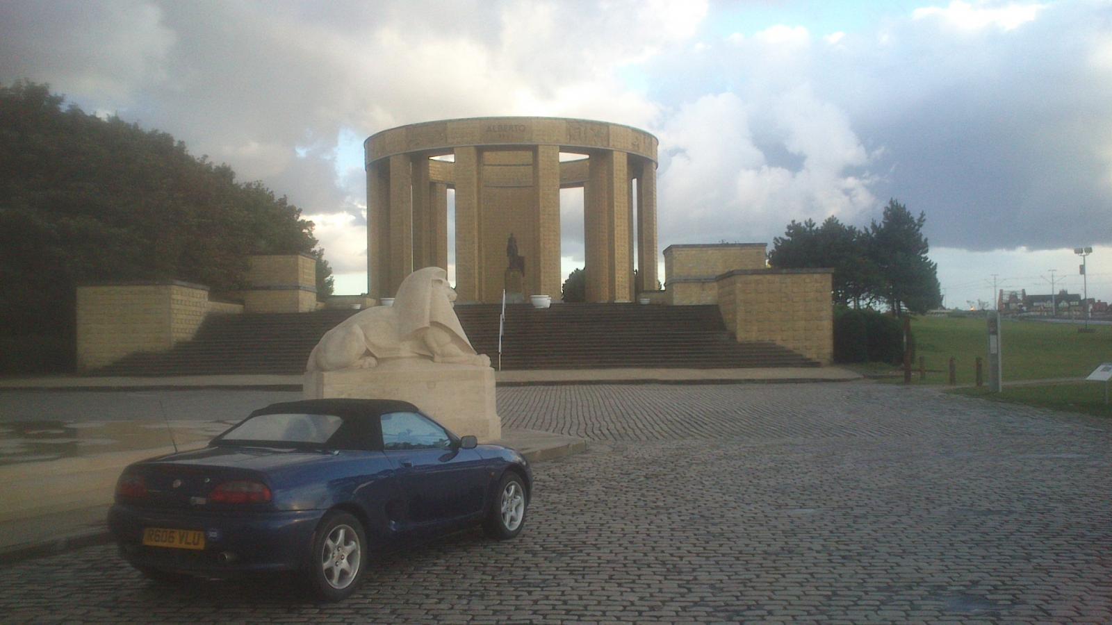

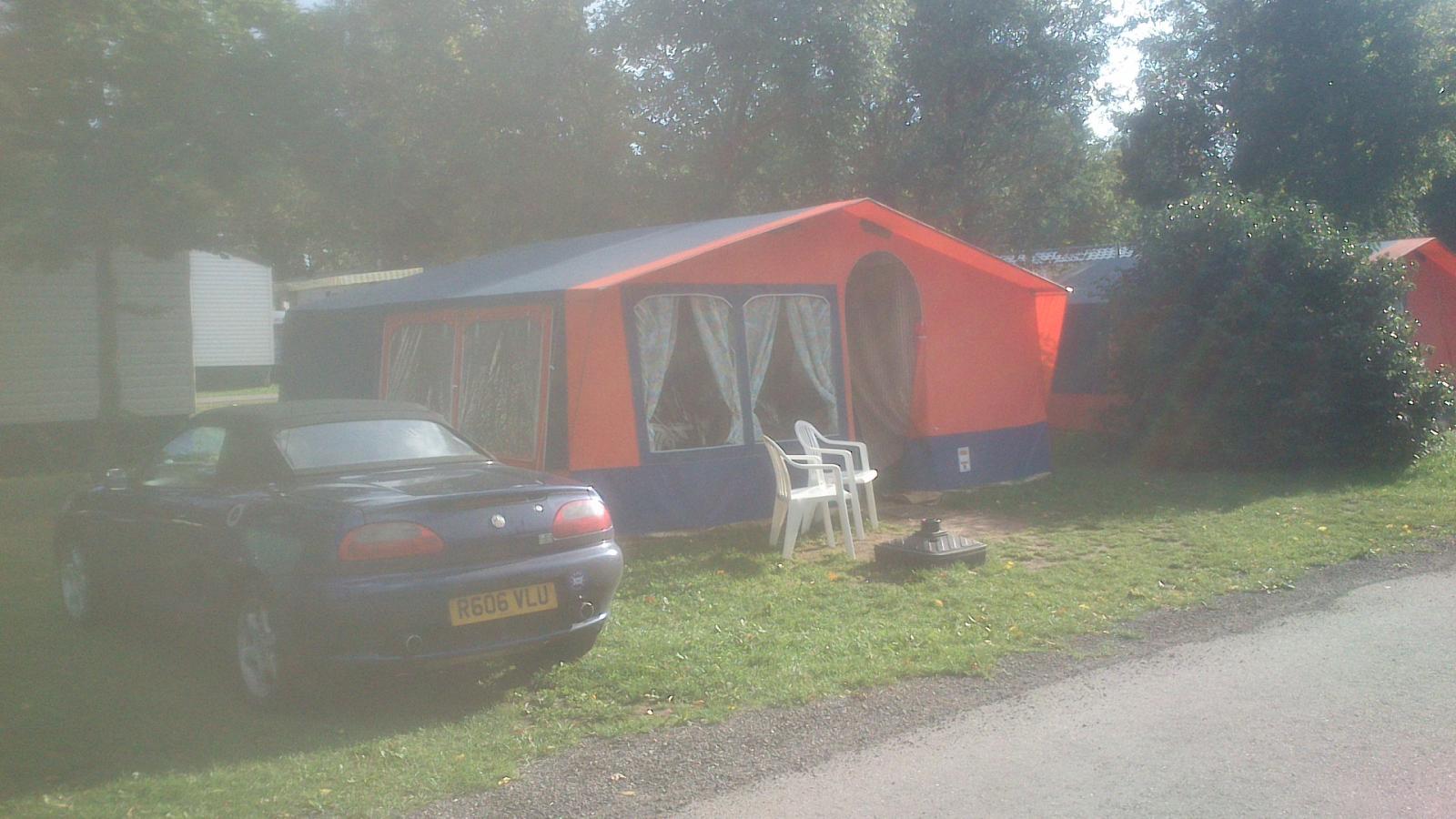

Barry Cade Posted August 25, 2014 Posted August 25, 2014 Right. The garage in Fife which did the last work on the car was me. MKK motors was my place when I went on my own. I am also an Ex Rover tech and know my way around MGF's and K series...I bought the car as an MOT failure just about non runner with 3 buckled wheels,a lot of electrical issues and a non functioning clutch,a torn hood and no handbrake and went through the whole car ready for a blast to the Frankfurt Motor Show last year, Fife-Dover-Frankfurt-Calais-Fife in 9 days. It never EVER missed a beat, crawling through London,120+ on the Autobahn...no breakdown cover and only a litre of oil,water and a couple of tools just in case of an issue.Please people... Instead of repeating the countless pages of woe written about these cars, listen to folks who have actually driven them,lived with them and looked after them... Triple layer, quadruple layer, ladder.....PISH. Payen gasket works. The best gasket in the world won't fix airlocks,a blocked rad or leaking underfloor pipes...This is what kills MGF's. Hardly anyone ever bleeds them properly, or can even be arsed to take off the engine cover to service them properly... I hope you enjoy the cars as much as I did, give it plenty of caring looking at and drive the thing instead of looking at the dials. Belgium Saarburg,Germany MKK Motors and a customers K Series. Taff, STUNO, laser wheels and 6 others 9
