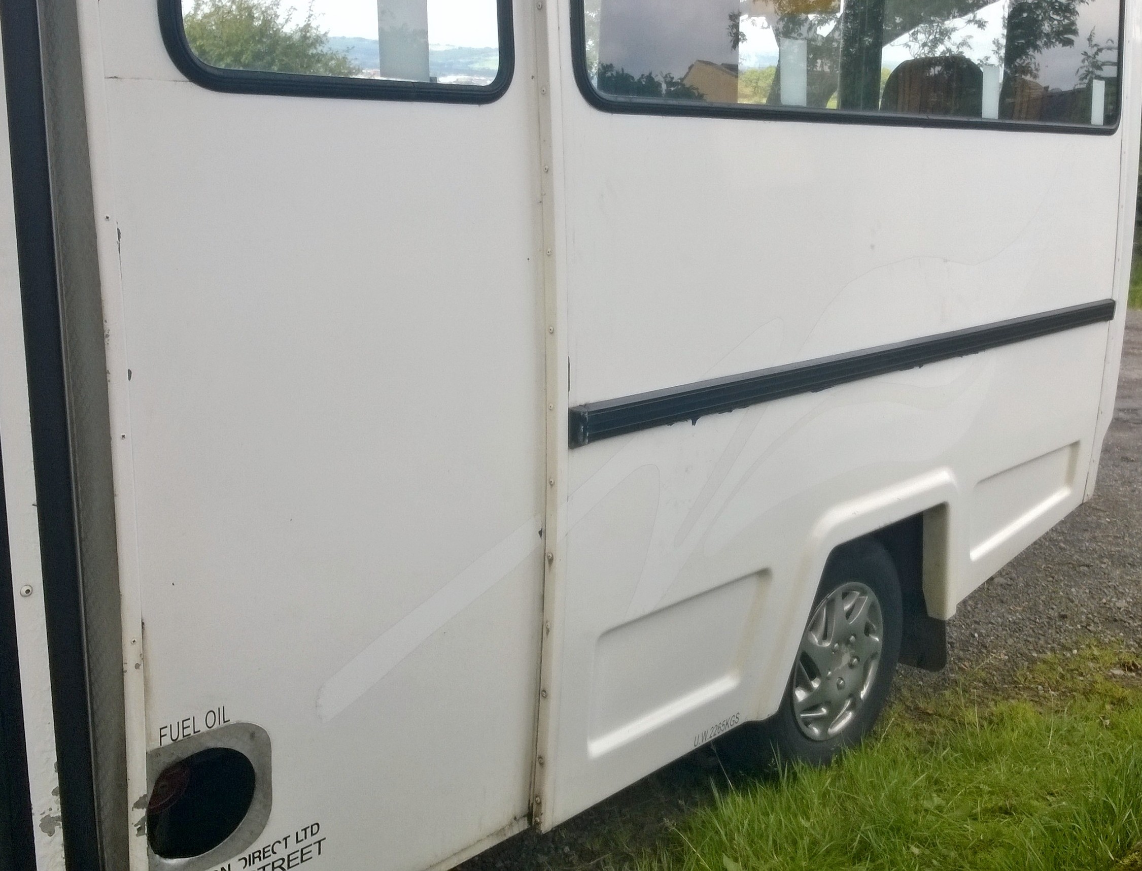

Spent 30 mins today with a hairdryer starting to take the graphics off. Pretty straightforward really.
Still got the high up ones and interior signs to come off.

Final sticker removed today, using Lady Moogs hairdryer whilst she was at work.

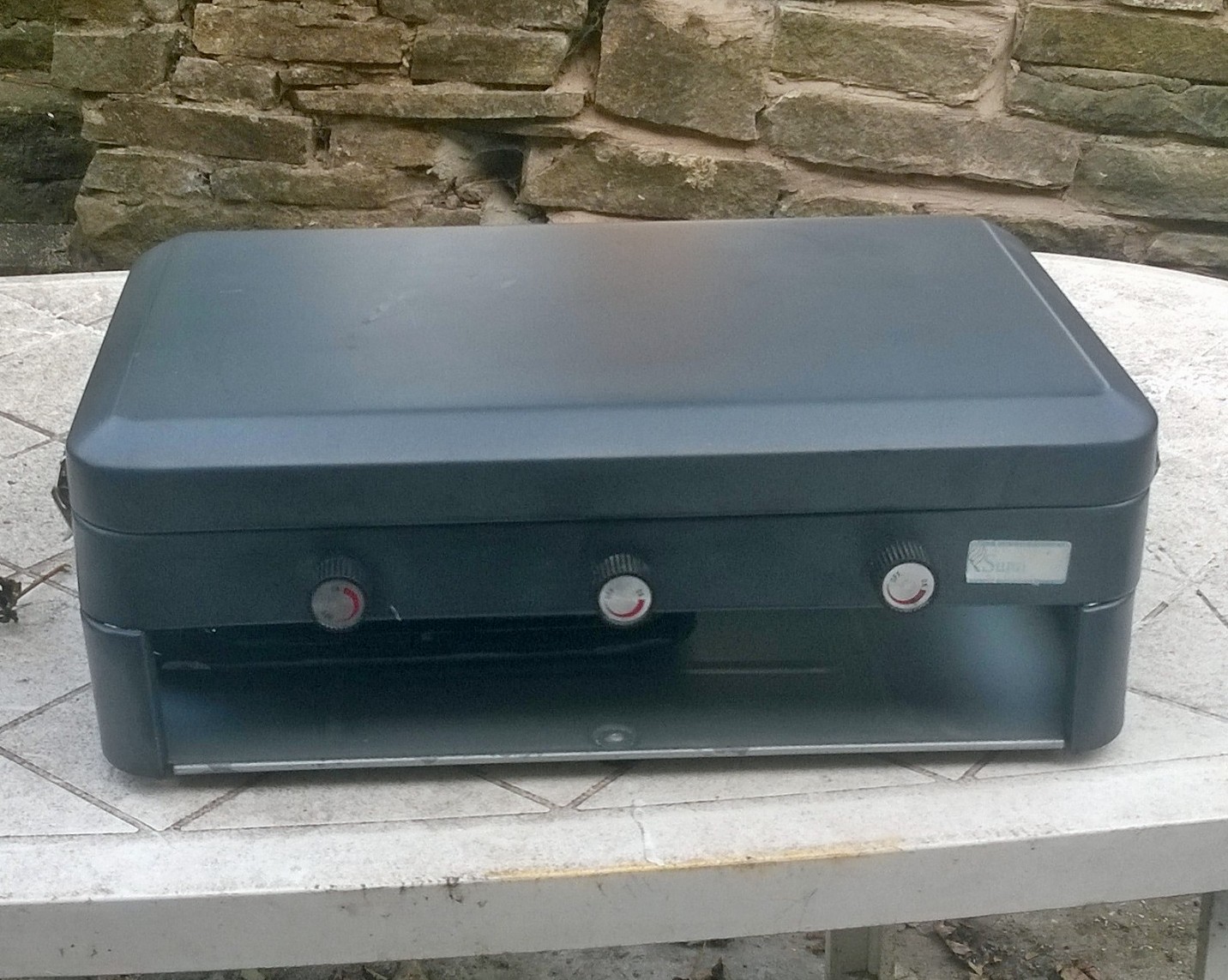

Scored a sink, tap and draining board from ebay for £14 delivered. Won this gas cooker for £20.
Going to create a modular cooker/sink in short term.

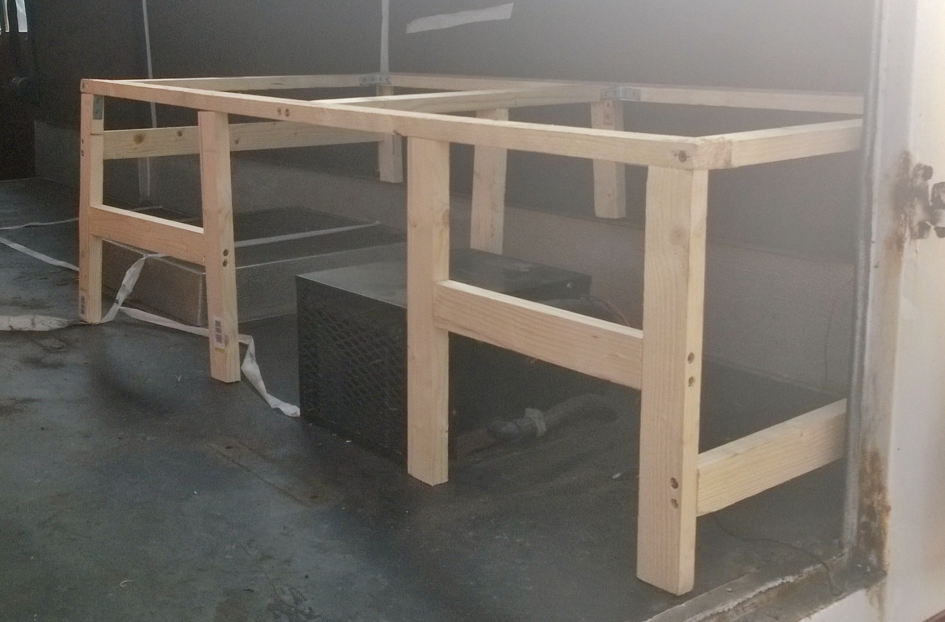

Then started building the bench/bed. Going to have two benches with the table being the middle of the bed. Width wise it is around 170cm so just making the benches 130cm long.
Only had a rusty saw and manual screwdriver, so took me around 2 hours to get this far.

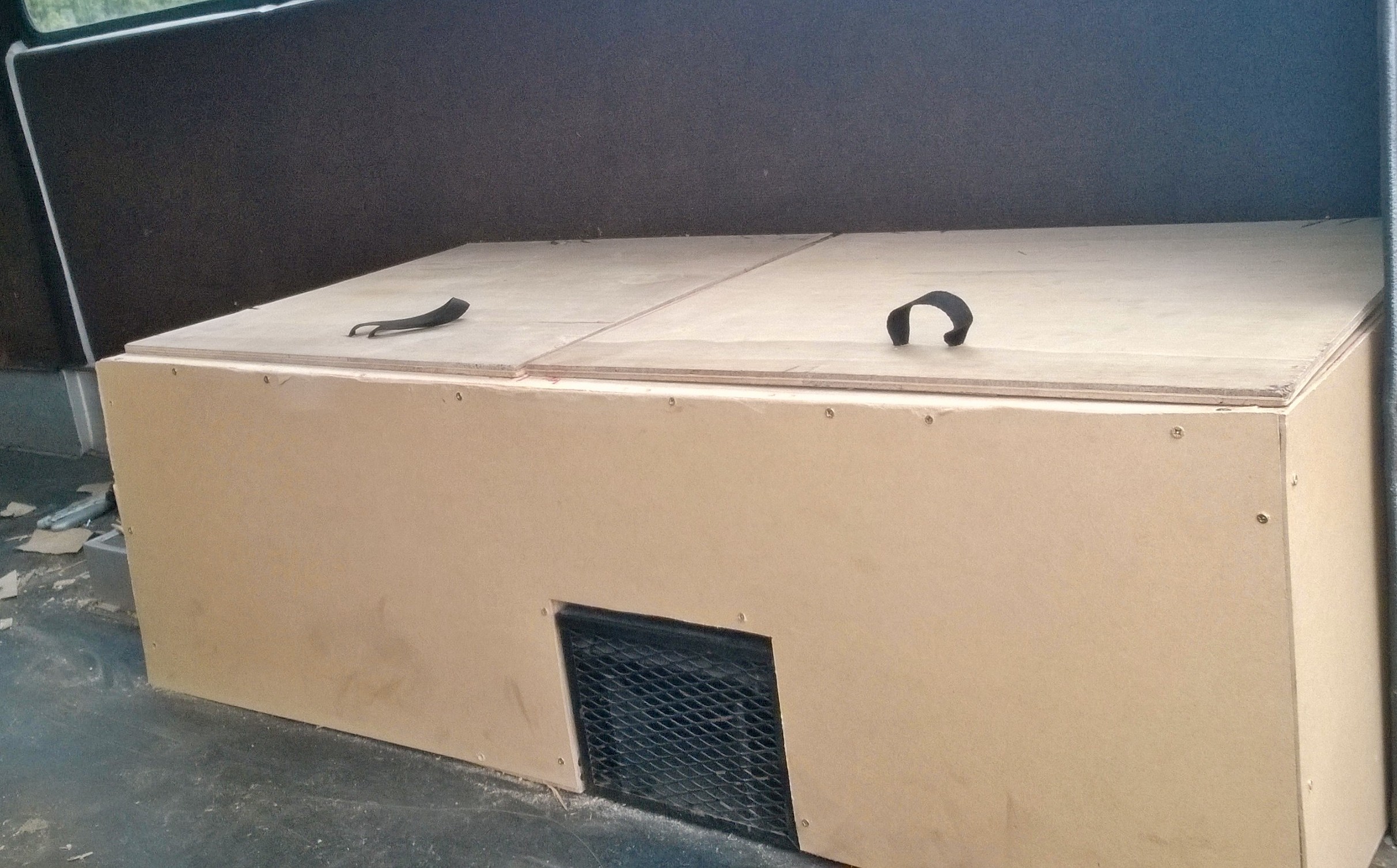

Boxes complete. Screwed directly to the floor. I have managed to build in the cabin heater :)
Not perfect but not bad.
