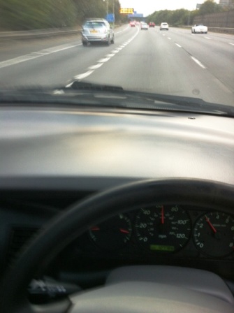

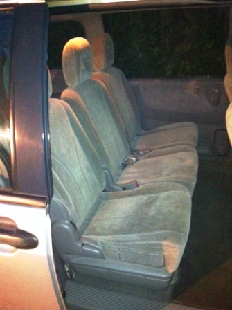

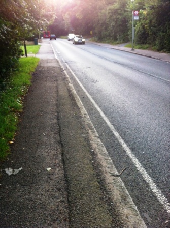

r.welfare Posted August 21, 2014 Posted August 21, 2014 It's been four and a half years since I last did this, but today I went on a trip to collect a car. Reading station, 5pm. Smelly Festivalgoers out of shot. Paddington, 5.30pm. Heading towards the Circle and Hammersmith & City Lines, to then change at Kings Cross for the Northern Line. Never realised it was such a hike. Citroen H van-mounted coffee vendor might be in shot. 6.30pm. That there North London. The wilds of Zone 4. Totteridge to be exact. 7.30pm. M4. You might be able to make out the car is very low-geared - that's about 65mph at 3,000rpm. 8.15pm. Home. It's an imaginatively-named Mazda MPV. Let me state here and now that I only have one child and therefore don't really need a 7-seater. But we've got some DIY jobs coming up and clearing my in-laws house, so it will come in useful. And it was damn cheap, considering it has 5 days shy of a year's ticket. Admiral obligingly set me up with a multicar policy that became almost disgustingly cheap when I complained about having a premium hike due to a non-fault accident (cf. Avensis, last year) that we didn't even claim on our policy for. The lovely Welsh lass on the phone mirrored the 12 years NCB from the Honda onto this. Interestingly, that newfangled DVLA MOT and tax checker site also says it's taxed until 31 January, even though there's no disc in the car. So I was able to cruise home without worrying about ANPR. No pez station shot because it actually had 1/2 a tank in. Aside from the low gearing it drives pretty damn well. "It's only got one advisory for a slight exhaust blow", the old boy selling it bellowed at me as the Mazda idled on his drive like a Lancaster bomber, "it's on the join, it just needs tightening up". Hmm. We'll see about that. It does quieten down when warm though. 2-litre petrol in this one, same as the 626. That explains the low gearing, it's only got 130bhp to propel nearly 2 tons. Of course, there are a number of reasons why it was cheap. There's no history whatsoever, although the V5 states only 2 owners from new and the last had it 10 years. Therefore I'm playing cambelt roulette until my nerve goes. Then there's this: My crap photography shouldn't mask the fact the nearside rear wheelarch is right of shape. Also the sliding door on that side is badly dented. If it's a long-term keeper I'll try and score a secondhand replacement, hopefully in the same colour. Then, because Mazda, there is of course this: I managed to peel a load of the lip away by hand. Anyone in the Home Counties good at welding and fancy earning some ££ if I bring it to your magic tickling stick? Let me know. I'll even do all the stripping and prep. Inside it's quite nice. The old boy said "Oh yeah, the aircon works" but buggered if I believe him. I do reckon the pollen filter is absolutely clogged as the air throughput is shite, will need to check that out tomorrow. The a/c light does come on when you press the button. It might be low on gas. It might be buggered. A visit to Kwik-Fit beckons. I like the two-tone steering wheel, as it happens. Some middle seats. They are not green - blame my iPhone camera - but a lovely sort of grey mousefur. I can get the nearest seat's backrest to flip forward but not sure if it's meant to tip. A handbook is on order from eBay. Back seats. I clambered in through the boot and found that the legroom is OK, although I'm only 5'10" and particularly short in the leg. You even get separate heat/vent controls in the back here, there are two vents in the roof!!!1!. They think of everything. Also I found a bag of mouldy Maltesers in one of the cubbyholes. I didn't eat them, even though I hadn't had any dinner yet. So there you are. Immediate plans are:Put some tax on itClean and polish itCheck the oil, coolant, air filter etc and give it a basic service if requiredDrive it for a month or so to see if it's alright or notFit some reversing sensorsHave a go at knocking the nearside dent out on the wheelarchKwik-Fit trip to see if the a/c is really deadThen if it's a keeper:Cambelt and waterpumpRefurb the wheels (maybe)Replace the nearside sliding doorGet the wheelarch welded upThink about selling the Accord... Conrad D. Conelrad, Micrashed, brickwall and 14 others 17

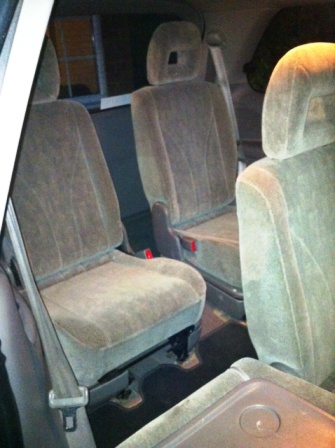

Conrad D. Conelrad Posted August 21, 2014 Posted August 21, 2014 I want to draw pattens in that upholstery with my finger. loserone, Junkman, brickwall and 1 other 4
r.welfare Posted August 21, 2014 Author Posted August 21, 2014 I might "do a Partridge" on one of the seats tomorrow with my finger to see if it works, then photograph the results for posterity. sporty-shite, brickwall, Conrad D. Conelrad and 2 others 5

Split_Pin Posted August 21, 2014 Posted August 21, 2014 I've never seen or heard of one of these cars before. The interior looks like it came out of the factory one colour and time has tinged it to another.10/10.

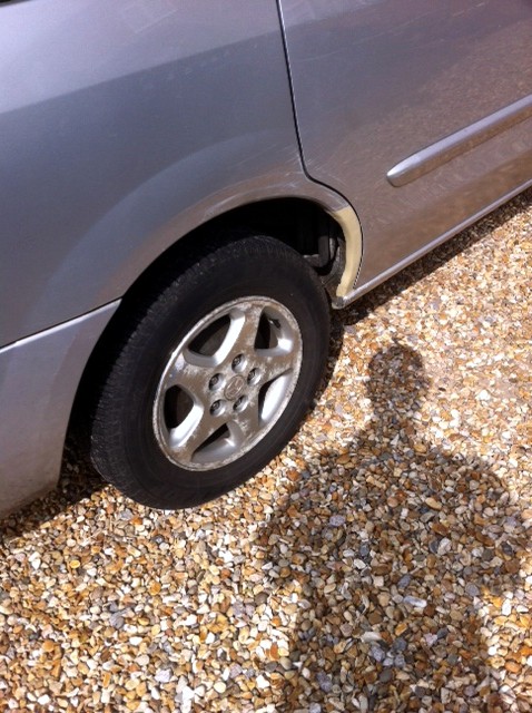

r.welfare Posted August 22, 2014 Author Posted August 22, 2014 Premacy after, which is 323-based and smaller. This is 626-based. Premacy also rusts, surprisingly. This one is a 51 plate. More petrified sweets removed from the interior this morning - I had to move fast to stop my six-year-old stuffing a hairy Maoam in her mouth. Sadly, you can't draw a cock in the upholstery with your finger. I did try. Epic fail on hammering out the dent on the nearside rear. Need a slide hammer I think. I'm going to wob up the offside rear arch for the time being with some P40 and P38 followed by some POR-15. At least the underneath appears rust free. What is it with Mazda and rust? I read somewhere it might be to do with acidic lubricant in the seam sealing process. Pollen filters removed and they were hanging. Now I get a decent throughput of air. Might even be (a bit) cold. Service kit on order from ECP, let's see how wrong they get it given it's hardly a mainstream vehicle.

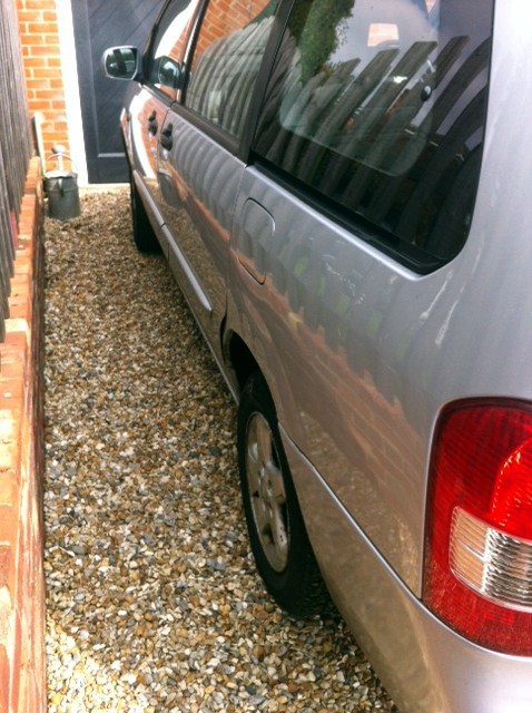

r.welfare Posted September 13, 2014 Author Posted September 13, 2014 Been a while since I updated this. So, some stuff has happened and some hasn't yet. First, bodywork. The rusted offside rear arch has been ground back, treated, then artfully reconstructed with the deans of bodywork excellence, messrs P38 and P40 and a squirt of high-build primer. I'm sure it will bubble up again (although I'm going to sand it smooth and cover it both sides with POR-15) but it'll do for now. I've just had an aerosol of topcoat delivered which will no doubt be way off shade because Mazda changed the pigment every 6 weeks. I'll be trying to get some more of those scuffs out with the buffer/1500 grit sandpaper first. On the nearside, you may recall the van was primarily cheap because of this: Oh yeah. Well, despite nobody having heard of these things being on the market there were actually three being broken on the Bay in the same colour. An afternoon of ringing round ended up with a drive to Bristol to collect an undamaged door for 60 quid, complete with everything except the door card, which was handy. So it now looks like this: It's a crap angle but in essence while the door is now fine, the arch is still knocked in and seems quite difficult to hammer out from behind. I'd like to get it a bit closer to the right profile before getting busy with the P38 and primer as before. The trip to Bristol was not undertaken without some considerable angst re. the road tax. Car was still showing taxed but disc AWOL. Decided to wing it re. ANPR "good" vs. failure to display "bad" balance of probabilities as I didn't intend to park up anywhere. Situation resolved itself last weekend when the DVLA site updated to confirm what I'd thought - previous owner had cashed the tax in. So on Monday I went and got a proper disc (none of this laser-printed shite) at the post office and I've been driving the car daily since. What are my further driving impressions? The exhaust is blowing like mad; I found a rusted sleeve round the downpipe which I removed which revealed some splits in the pipe itself (but no rust). I covered the downpipe liberally in Gun Gum which has now cracked like the Chernoybl sarcophagus, so the next stage is to get an exhaust bandage. Did a bit of servicing so new plugs (electrodes of the old ones were white), changed the oil and filter, air filter and pollen filter. Props to Euro Car Parts for actually delivering the right stuff. The air and pollen filters were minging and the oil filter a Mazda one; can't really tell how long since it was changed. I Streetviewed the previous owner and it's fair to say it wasn't a hugely salubrious address, so I suspect maintenance has been lacking. Engine's a bit oily on the outside, so I get a whiff of it now and again when sat idling: Still playing cambelt roulette for now but looking at the manual the rocker cover gasket gets replaced when you change the belts, that might solve it. Going to de-gunk it all for now and see whether it gets any worse. Speaking of manuals: I spit on your Haynes. £10 delivered. You can find an American version of this manual for free online, but it doesn't cover the 2-litre engine. I'm actually pleasantly surprised by the motor. Yes, you have to wind it out to make "spirited progress" but it doesn't seem to mind and it's OK just pootling up through the gears. Stuck some parking sensors on the back (colour coded 4-sensor kit, £7.78 delivered from eBay!) so at least I shouldn't clout anything with it. Unlike the previous owner. The only other problem I have is blue smoke at a cold start. Reading up the piston rings can be problematic (huh! Just like most other Japanese turn-of-the-century petrol engines) so the bores get some oil in them. This must entertain my neighbours as I pull off the drive at 6.45 every morning in a blue cloud of exhaust buzz; perhaps they think I have bought a Trabant. Not really sure what to do about that. Doesn't seem to have used any huge volume of oil yet in any case. And that's the story so far. Next installment hopefully this week when I've got some time to finish off the bodywork (including getting a topcoat on), and fitting some new rear shocks: The offside one on there at the moment is almost crumbling away from rust around the top "cap", if that makes sense. KruJoe, mouseflakes and Sigmund Fraud 3
