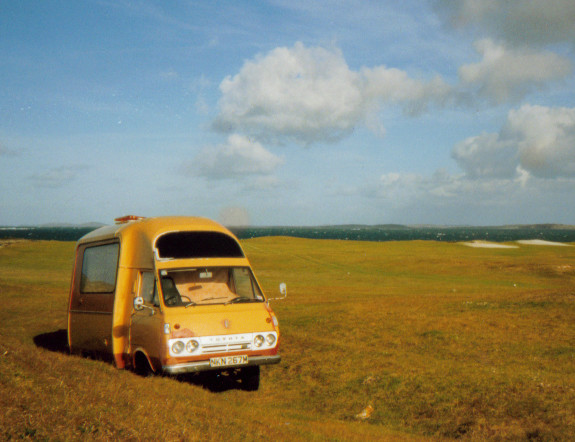

mouseflakes Posted August 16, 2014 Posted August 16, 2014 I woo'ed Mrs Flakes by driving us round Ireland in this... On the last morning there we were about an hour from Cork and two hours from ferry departure when it felt like the brakes were very weak. Stupidly, I thought I'd check the fronts at the roadside. They were drums all round on those old Hiaces. The brake cylinders were mounted on the backplate with their axis along the vertical. I wanted to check the piston wasn't seized so I eased the one facing upwards out. This left the rubber cup and backing disc behind in the cylinder, so I pulled out the rubber cup to be sure - as you do. The result was that the spring beneath the cup suddenly expanded, shot upwards and then plopped back down into the fluid-filled cylinder - but the backing disc was no longer on top of it. I then spent a frantic, sweary half hour or so, thrashing around the roadside verge trying to find where the hell the tiny part had pinged off to. Time was ticking away and we were going to miss the ferry. For the umpteenth time, I sat back down in front of the hub and tried to work out the likely trajectory of the disc from the top of the spring. This time, I picked the spring back out the cylinder to check how compressed it was before it released. This is when I discovered that during its brief moment of freedom when it sprung out, it had managed to perform a perfect 'one-eighty' and had plopped back in upside-down, with the backing disc still attached, but hidden from view beneath the brake fluid left in the cylinder. We made it to the ferry just in time, but I did have to drive at stupid speeds to make it (stupid speeds in a top-heavy '72 Hiace are roughly between 32 and 43 MPH). Lacquer Peel and forddeliveryboy 2
