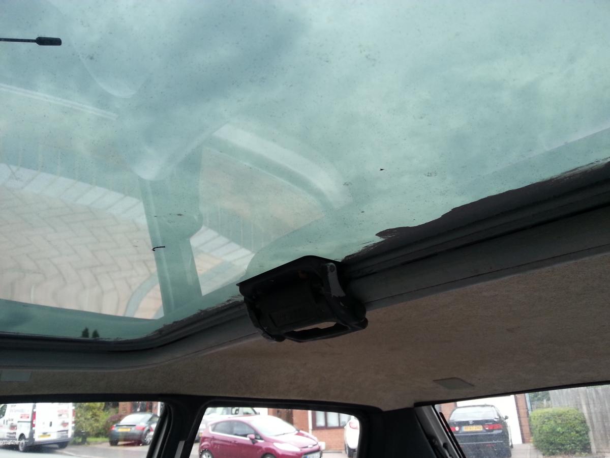

Right, then: the 205 has one of those flip-tilt glass sunroof jobbies.  In theory.
Clearly, the previous owner has sorted the inevitable leakage by sealing it shut with some kind of gunk possibly more suited to heavy-duty marine applications.  This has worked, but it looks shit.
Does anyone know whether such sunroof cassettes are still available, or recommend someone who might be able to repair/replace/undo my bodgery?

With that type, water can get in only two ways. Either between the seal and the glass or between the frame and the roof. Removing the frame and cleaning, reapplying sealant then refitting the frame will/should cure that bit. Then it's the seal to glass area. Either increase pressure on seal with some form of bodgery modification or replace the seal. I realise seals may not be available but with some searching something should be available. They're not complicated things. Hinges and clasps may be available, or similar ones. Sunroof fitters/manufacturers?Marine supplies? Sealing washers through fixing holes may be another area to look.

I often find,cleaning the rubber seal and then smearing with vaseline or similar,
can work wonders.
One of my Vivas has a glass sun roof in it for the last 20 odd years,
even that was secondhand when I fitted it.
Never leaked,but does get the above treatment from time to time.
Go on Yell.com and search for local sunroof places. You may find that there is someone locally who could fix this
There's the trick been tried on here before where you smear silicone on the rubber, where the glass would sit. Cover with cling-film and close the sunroof overnight. Open again, peel clingfilm off and you should have a perfect match to the glass.
I just bought some clear mastic from screwfix and sealed mine up that way, seems to have improved thing, mostly and as it's clear you can't see it so much.
