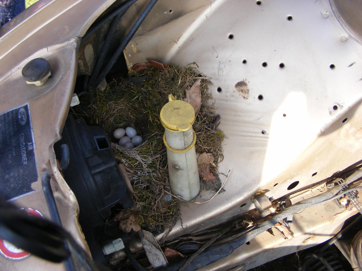

Next step was to get it running  , i took the plugs out and filled the bores with diesel  and left it for a week . When i went back to it i tried a socket on the crank pulley and gently moved the engine back and forth until it had done a few turns on the socket  so i was happy it was  not seized , so i fitted a distributor and timed it up  but as the car had air con i had to move the a/c compressor out of the way just to get the belt cover off .
 The next bit was messy as put a battery on it covered the plug holes with rag and turned the key and after a few turns the oil light was out .  The electric fuel pump was also missing so i fitted a replacement then poured some petrol in and primed the fuel system .
After a few turns the engine started and sounded ok but as there was no water in it as the rad had rotted out i turned it off
