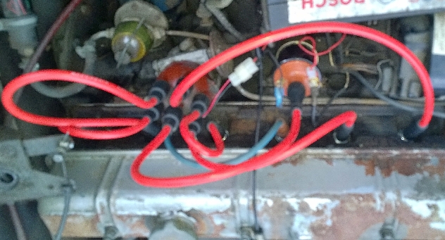

Whipped battery off and put it on charge and ordered an Acuspark, rotor arm, sparkplugs and HT leads. Fitted them all (apart from HT leads as I need to make them up and not sure how) and I can haz spark. Bit yellowy but still a spark to the plugs. But it still wont start.

Give the old adage that 90% of fuel problems are actually ignition related, I think I'd be tempted to explore that side of things a bit more before messing with the carbs. It does sound like the spark is weak, so finding why might be a good move. A jump pack of jump leads might be handy, just to give it the best chance.

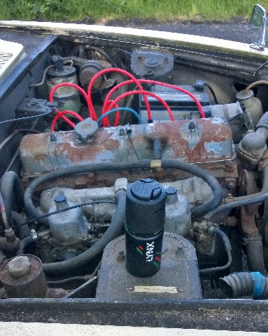

Yes think so. Will get pics
Pics - new ht leads, ngk plus and acuspark.

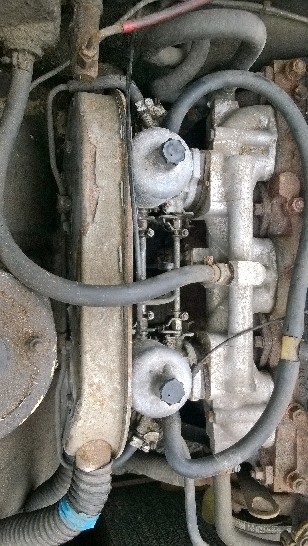

Decided to be brave and took off the carbs. Never having played with any before i was scared to break stuff. I needn't be, they are pretty straightforward. A mix of HBOL and interweb let me take them apart.
Float bowl had orangey crud in them so emptied that out. Blew threw the jets and they don't seem to be blocked. Put them back together and lobbed then on the car. Took 4 attempts to do so as i kept forgetting to do things (still forgot the choke spindle but cba to dismantle it again)

SU's are so simple that there's very little to fix. Proving the fuel is getting to the jets, the float chamber level is right and the pistons are free to move they should work. If your choke isn't operational that won't help as pumping the pedal does nothing with SU's unlike most other carbs.
Sounds like sticky float needles to me. Try tapping the flaot chambers with a block of wood a few times. If they are stuck, there's a reasonable chance that, once freed, they'll start to flood the engine, with fuel everywhere!

Took both carbs off again (getting good at this) and comandeered the kitchen table. Both carbs were stripped and float bowls dismantled. Scraped all the gaskets off and cleaned them up. Took the float bowls off, jet out and blew through. Massive (relatively) bit of crud shot out.
Cleaned, reassembled and refitted (includng choke bar)...and...... cough cough... brum!

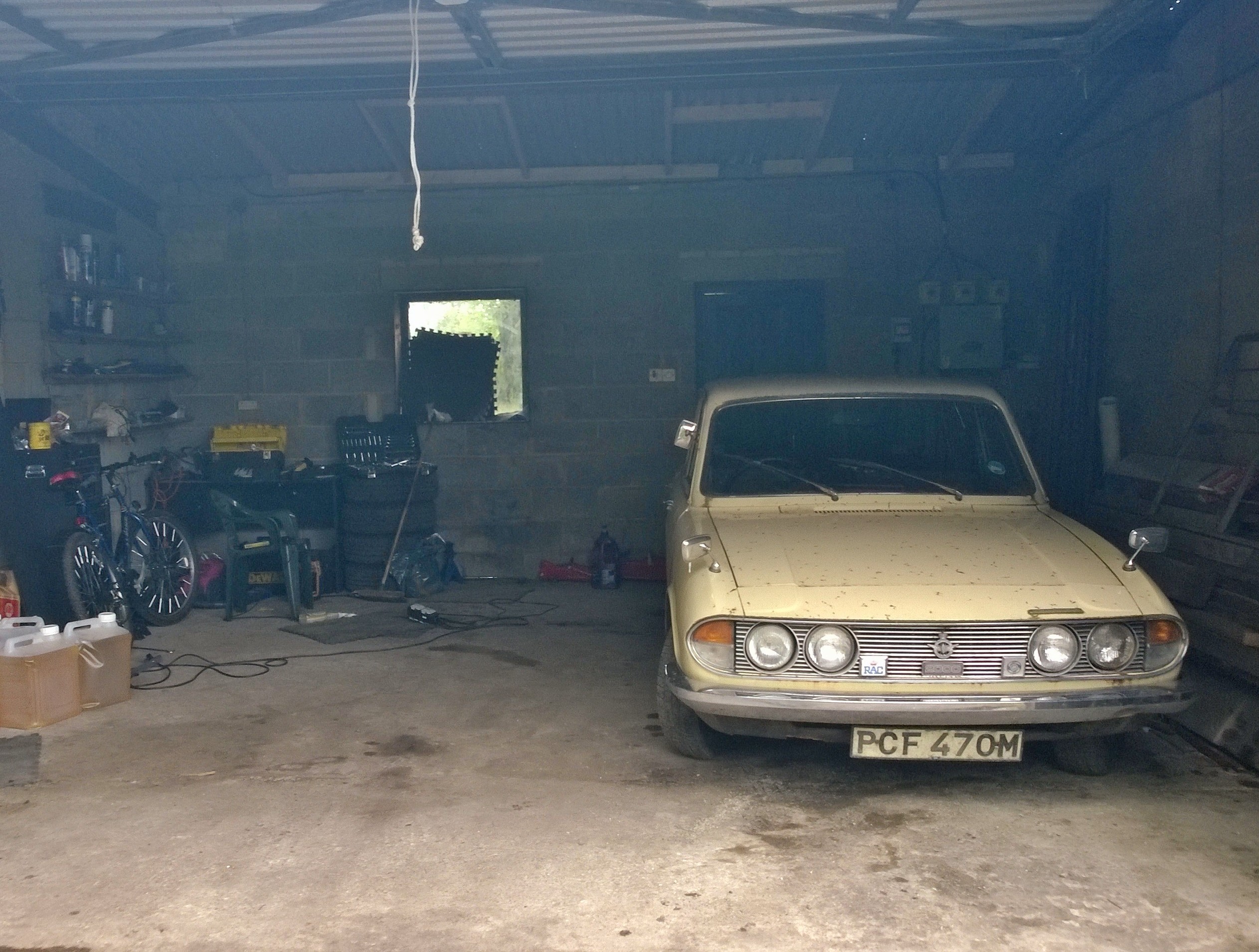

Tucked up in the garage for now. I will get under it in a months time to start evaluating what i need to do.

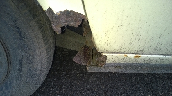

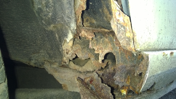

At first glance it needs both sides sills done, the front sub frame has crumbled,  all the wheel arches are requiring work and there are lots of bubbles that I think once poked will expose hidden stuff. Scooter said it had been undersealed which seems to have trapped the rust in.
