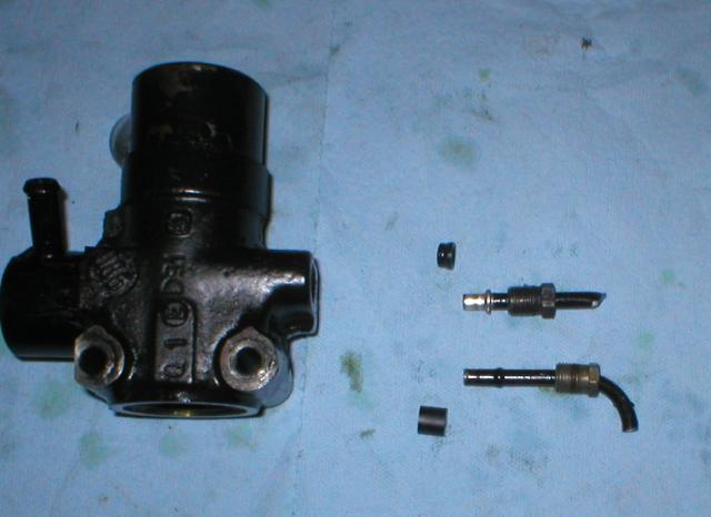

There are little rubber tube seals on the end of the LHM pipes (the smaller ones at least) you have to hook the old one out of the casting and fit a new one to the pipe.
We keep those in stock.
That's what's gone wrong at that then.  We could see the little rubber tube in the other hole and it clicked together without a problem once it decided to actually line up properly but the other seems to have spat the tube out somewhere, never to be seen again.  It's the only thing holding us up now.
