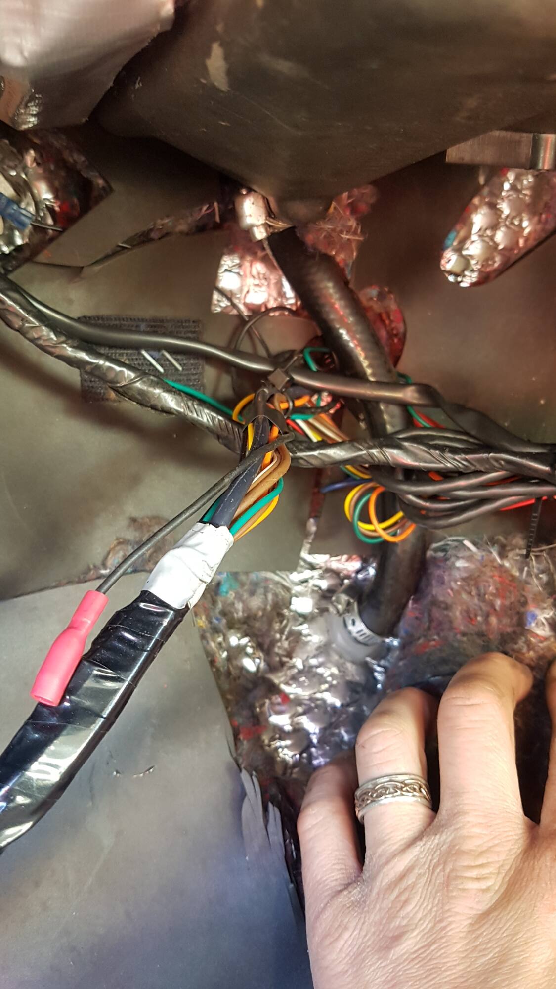

The underbonnet side of things was actually quite spacious compared to the interior! I've put everything back together now, so a few photos below.
The feed for the centre face vents dictated the RH position of the evaporator:
Another piece of ducting to the passenger face vent limited how far forwards it could sit, and the blower motor casing is only a few mm away on the LH side:
Now ready for the glovebox to be re-fitted. Note that I've had to relocate the thermostat to the side, to allow for a small duct pointing down towards the passenger's lap!

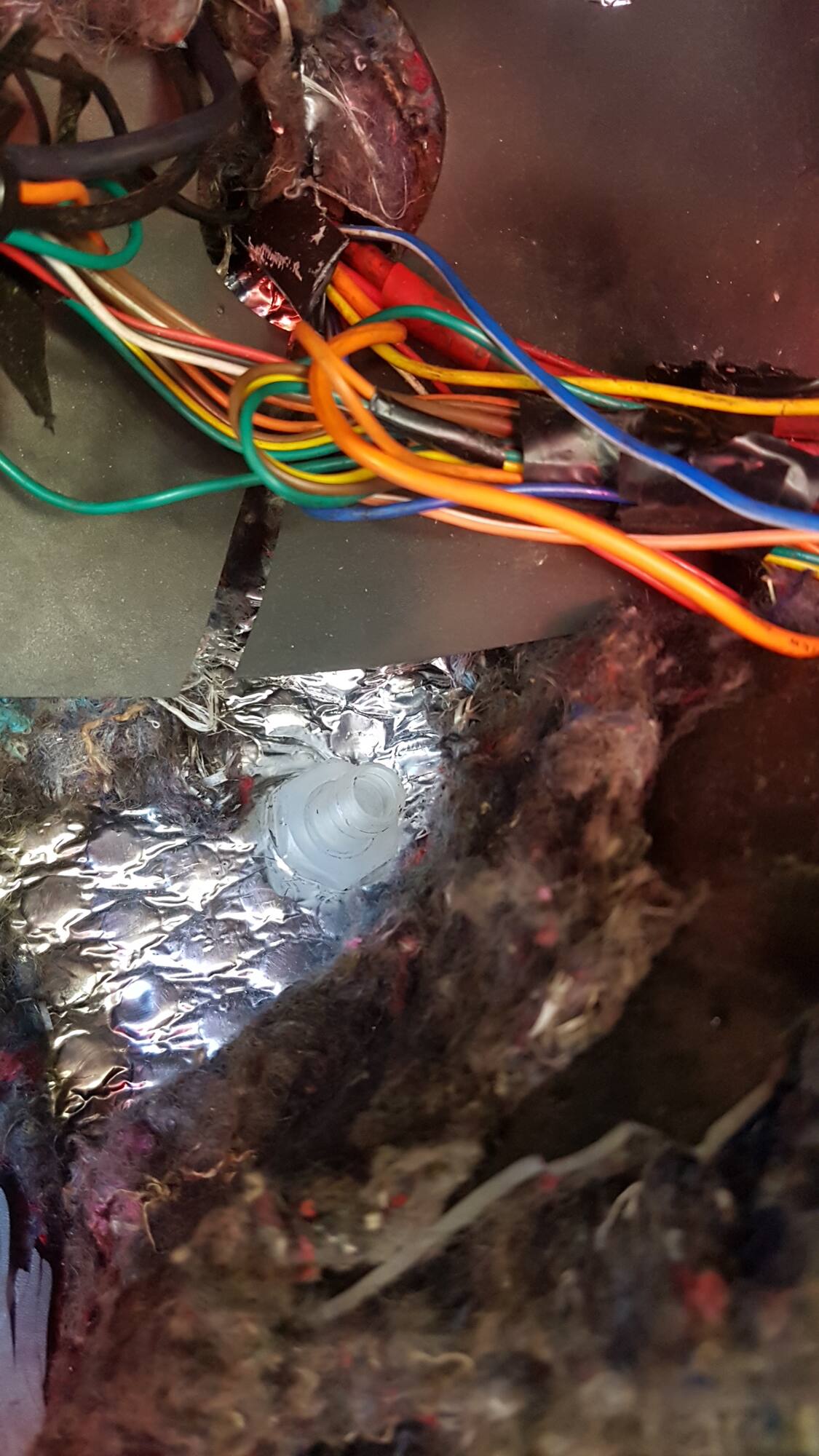

I've drilled the bulkhead to fit a plastic hose stub, for draining moisture which condenser on the evaporator.
Then ran a short length of hose to the moulded drain. Silicone hose was used because it makes the car faster...

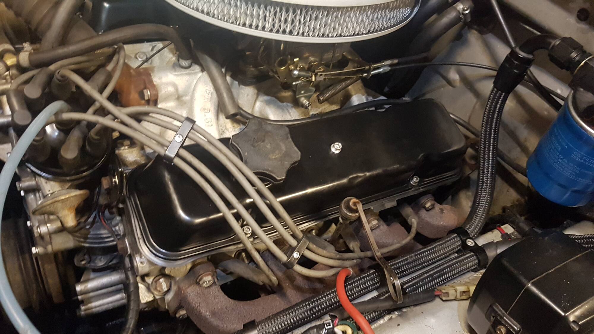

Generally working well, but I need to sort out an oil leak from the rocker covers, as the Rover gaskets are not an ideal fit. Heavy rain today, and as my Friday treat it's becoming a habit to take this to work.

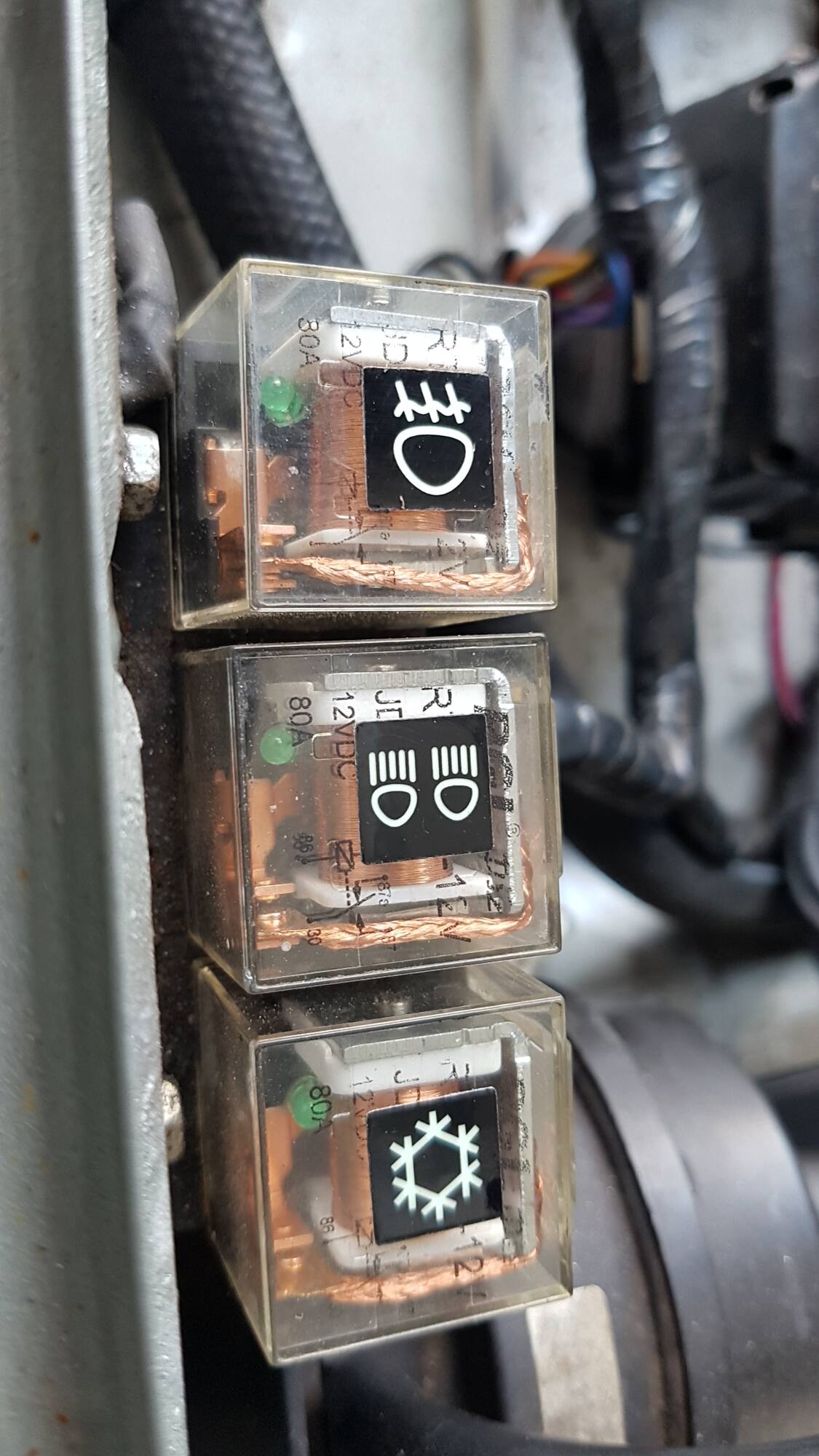

Because I'm a sad bugger, I thought I should label all the underbonnet relays, for ease of identification and fault-finding. I've already swapped them all out for ones with an integral LED indicator, so in the event of a fault I can at least see if the relay is being switched.
Little things, but it makes me happy.

The Rover gaskets are too large, so don't sit properly and have a tendency to pop out. Even torquing them down partially, and then trying to poke them in as I tighten the screws fully, didn't really work effectively. The new gaskets are now in place, and so far seem to be sealing.

Nice job on the relays.  Labelling and switching them out for the ones with the power indicator is definitely something on the wish list for the Jag given that it has about three thousand of them dotted completely and utterly randomly all over the car.  About 60% of which aren't mentioned anywhere in the handbook.

350 miles later, after a trip down to the Field of Dreams, and all seems leak-tight. Although the same could not be said at 3pm Friday afternoon when I wanted to be setting off! The last time I drove it was in some absolutely scorching weather, 30 degrees C, and I'd been driving it hard uphill - then I came to some roadworks. Not wanting to turn the engine off and lose the AC, I kept it running for the duration. This turned out to be around 15 minutes while they unloaded a gravel truck, and it was too much for my welded repair on the crack in the heater tap.
I noticed the smell of antifreeze later in the journey, and when I took a look it was weeping slightly (I think so was I at this point...) I thought I'd better have another go at fixing it before barreling down the motorway, so off it came. To try and get a better weld I used a blow torch to bring the moulding towards its melting point.
And beyond, as a gaping hole opened up :-( No photos of this, as I was definitely not in the mood! An hour or so later I had slowly managed to build it all back up again, and it held air pressure well in a bucket of water. I replaced the tap and proceeded to pack my camping stuff and a change of clothes.
I topped up the coolant and set off, with more than a little trepidation! I took the lack of smell as a good sign, but daren't look at it on the journey, until safely there late on Friday evening! Both coolant and engine oil stayed where they should, so up went the tent while I brought Aldi's finest red wine up to an acceptable drinking temperature.

Nice relays!
I've got to look into a new set of relays for my BX GT air con swap, i like the idea of labels and LED indicators. I know not much about electrics and less about relays so i have some research to do.
