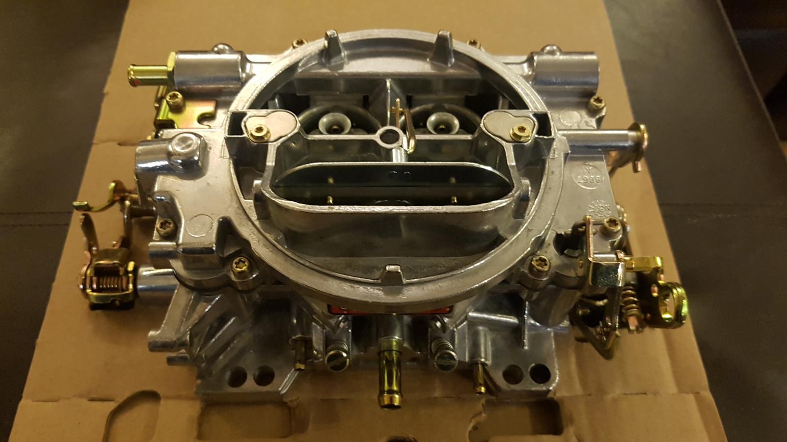

Plans for the winter are to replace the carbs with either a 4-barrel Edelbrock, or possibly fit fuel injection. Plus generally tidy up the engine bay, and get the cruise control working again. Mileage is a shade over 198k, so should hit 200k miles next year :-)
Indeed. I'm concerned the Edlebrock 1404 may be a little too big for optimum drivability (for a 3.5 litre), but from reading around seems easier to tune and keep so.

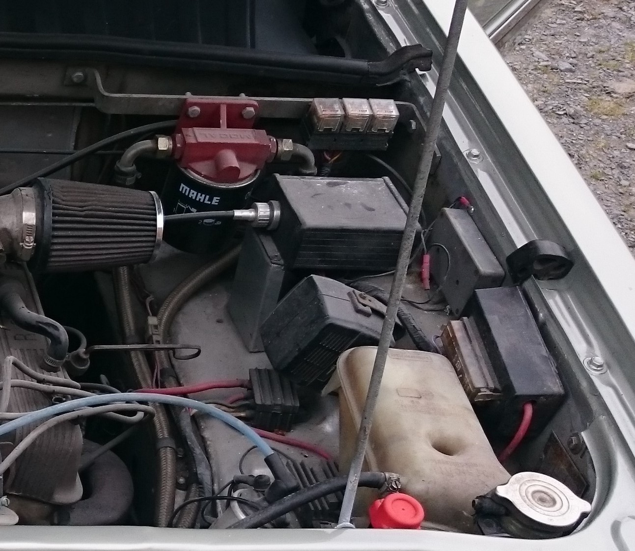

Tidying up the engine bay has commenced! This is what it looked like before; you have the relocated oil filter vying for space with the electronic speedo drive unit, the cruise control servo, an aftermarket alarm siren, and a bank of relays. Plus an auxiliary fuse box tucked behind the header tank, which I was unable to easily relocate at the time due to the length of the wires
It all looked a bit of a mess, and not like a 'factory' installation.
So with a bit of jiggling things around, I've managed to fix both the cruise control and speedo drive tight to the bulkhead, meaning I could do away with the steel bracket I'd made for the oil filter head. That I fixed directly to the bulkhead, so I was able to move the alarm. The fuse box was replaced with a new unit, complete with LEDs indicating whether a fuse has failed, and was fixed in a more accessible position after extending a few of the wires.
I still need to wrap the loom, but have run out of loom tape so that will have to wait for another day. I may tidy up the paintwork a bit, but not a top priority.
