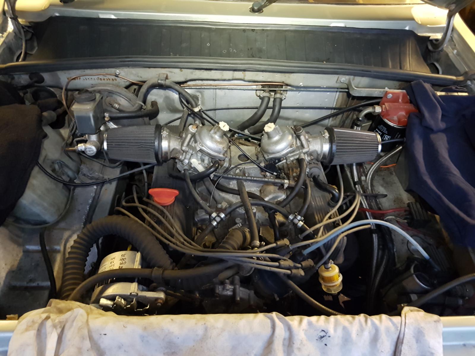

Then made a start on the engine; I ran it up to temperature for the last time :-( so I could drain the oil more easily, and it also helped with softening coolant hoses etc.

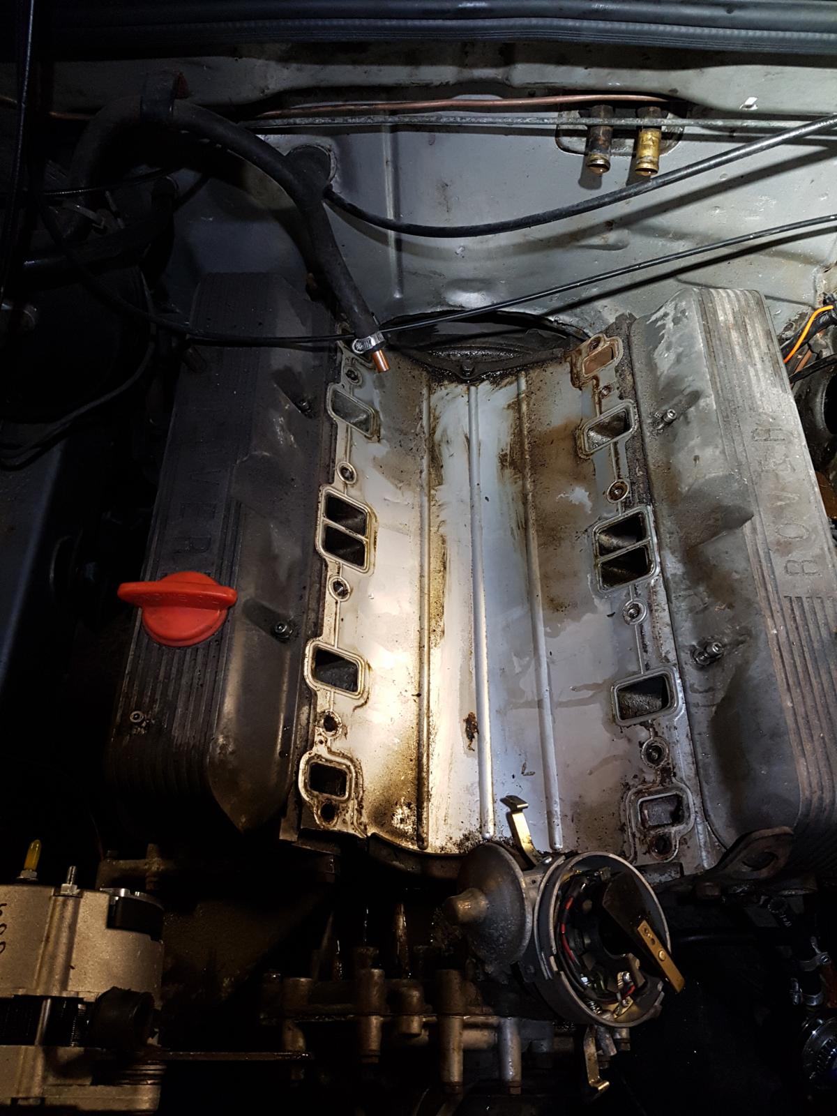

I thought I would take off the inlet manifold first, both for making the engine more manoeuvrable and also to take a look inside. Nearly there now. Valley gasket is the old-style tin type, which aren't renowned for making a great seal so will be swapping to a composite type.
Here you can see what a good fit the transmission tunnel is for the bellhousing and R380 'box. Although the top bolts are somewhat awkward to access!

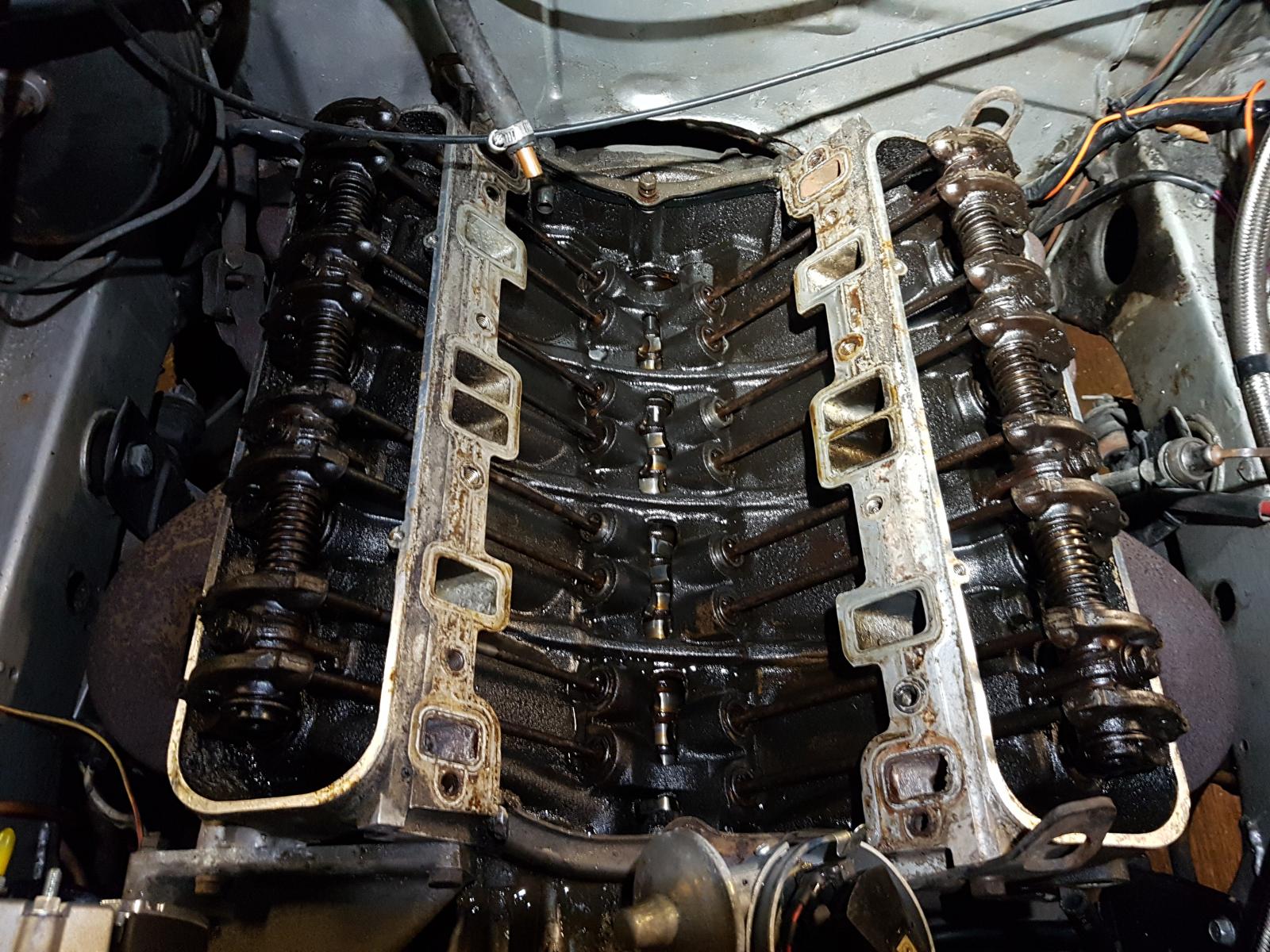

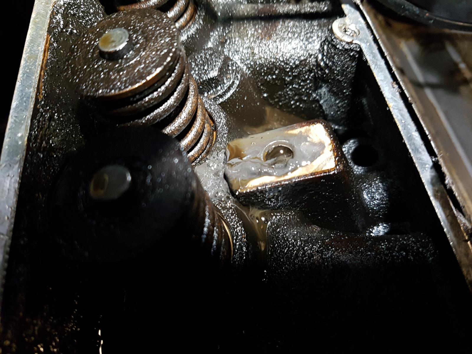

And this is what greeted me after taking off the rocker covers and valley gasket:
I would say that's indicative of an engine in poor health, although going by Google images not as bad as it could be! Certainly compared to the green Discovery after around 140k miles, it looks a hell of a lot worse!

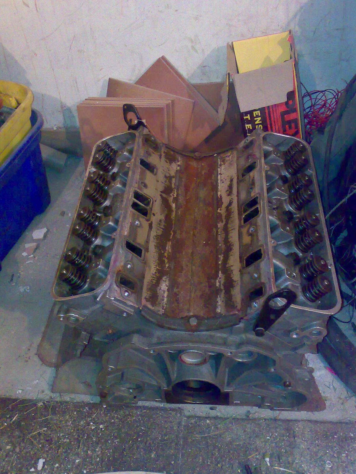

I'm really regretting a decision I made a few years ago though - I used to work at QH and they had a brand new, never run RV8 block and heads as part of a water pump test rig. My boss agreed to swap for a scrap engine, and my plan was to build the new lump into a nice engine. Sadly finances got in the way, so I had to sell it to help pay bills.
ARRRRGH! I stumbled across some old photos today, just to rub my nose in it!
Oh well :-( I don't even know what capacity it was, as the engine number was just EXP S50.

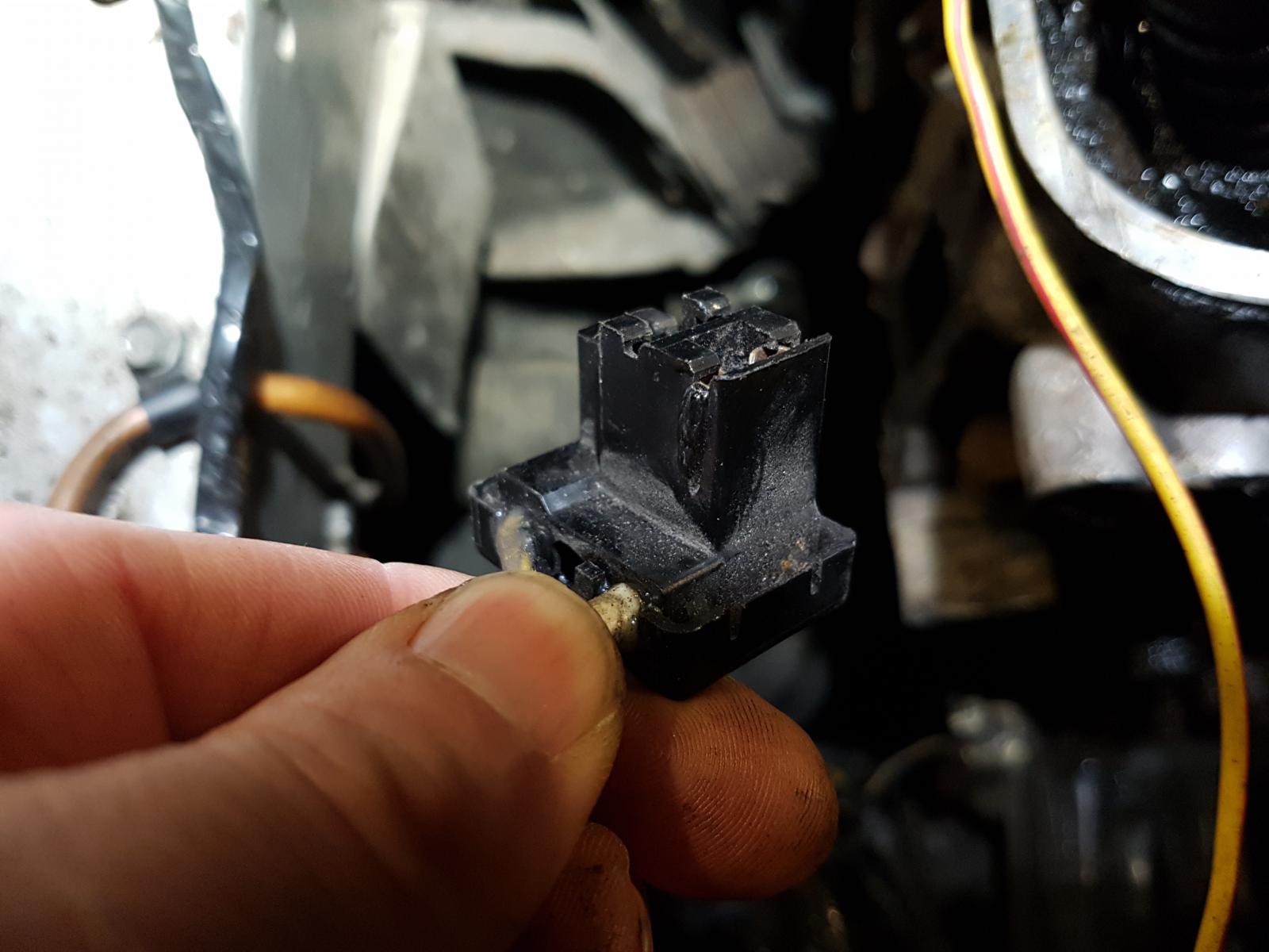

Still trying to look on the bright side of things, taking the engine out has made me notice a couple of other things - firstly with the new uprated alternator it seems capable of supplying more current than the old single power cable connection should be carrying:
In the original application the charging output is split over two wires, but with the Stellar wiring only having the one, that's all I used. No problem with the old 45 amp alternator, but this is capable of almost double that.

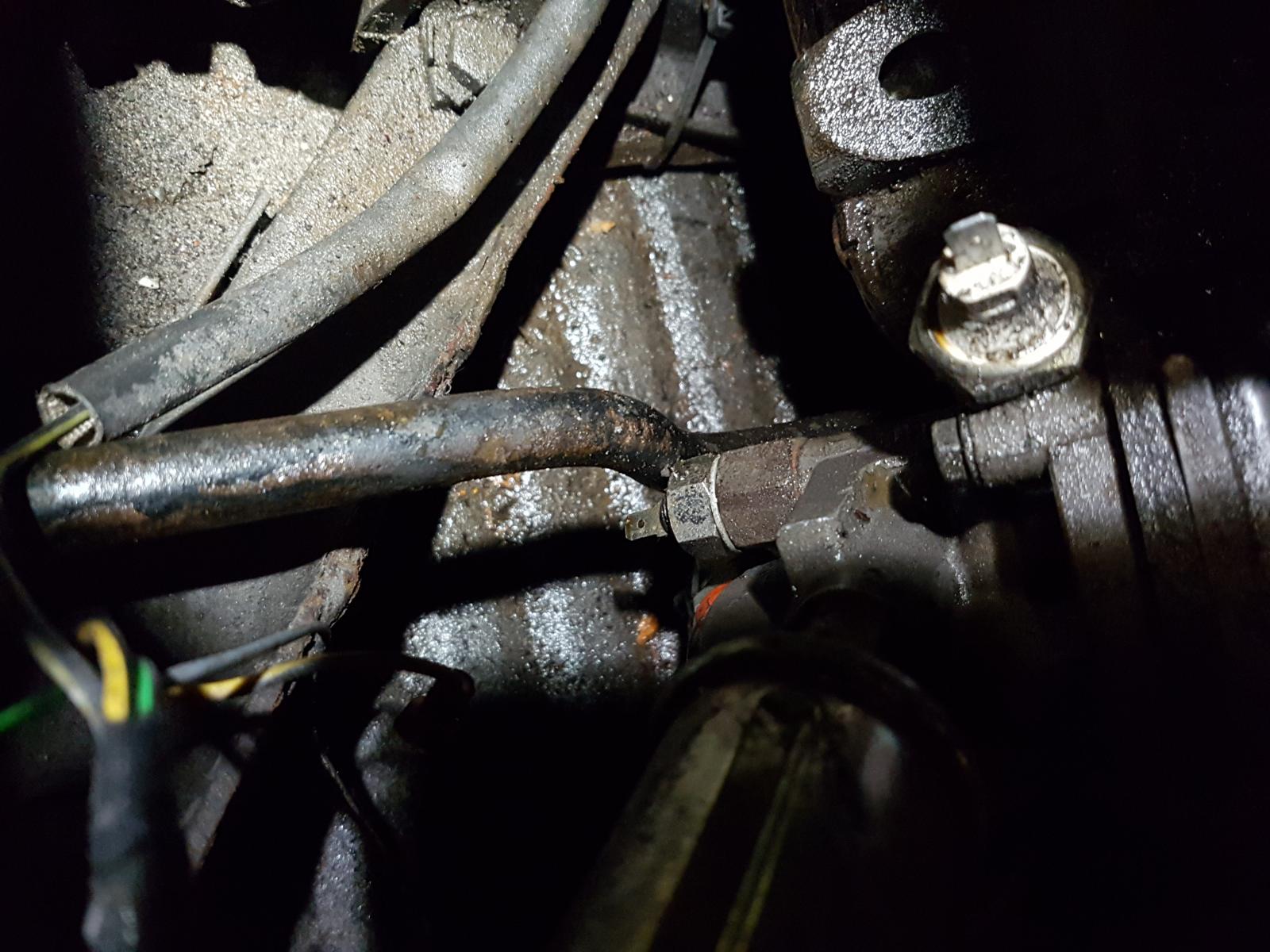

I also noticed that the oil temperature sender was contacting the front anti-roll bar when both wheels are off the ground. I've used an adaptor threaded into the oil pump casting, so may look to re-tap the housing and mount the sender directly.

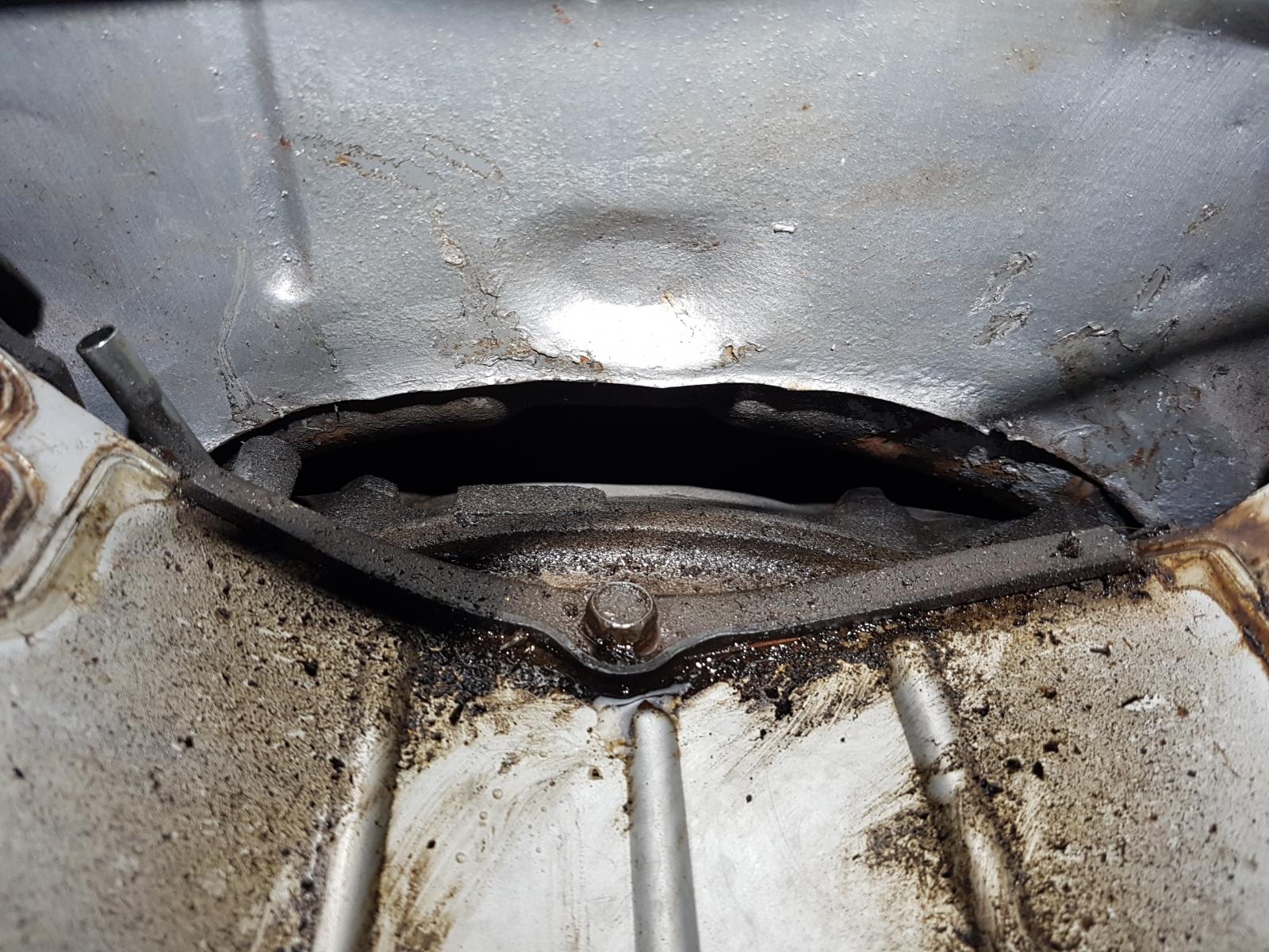

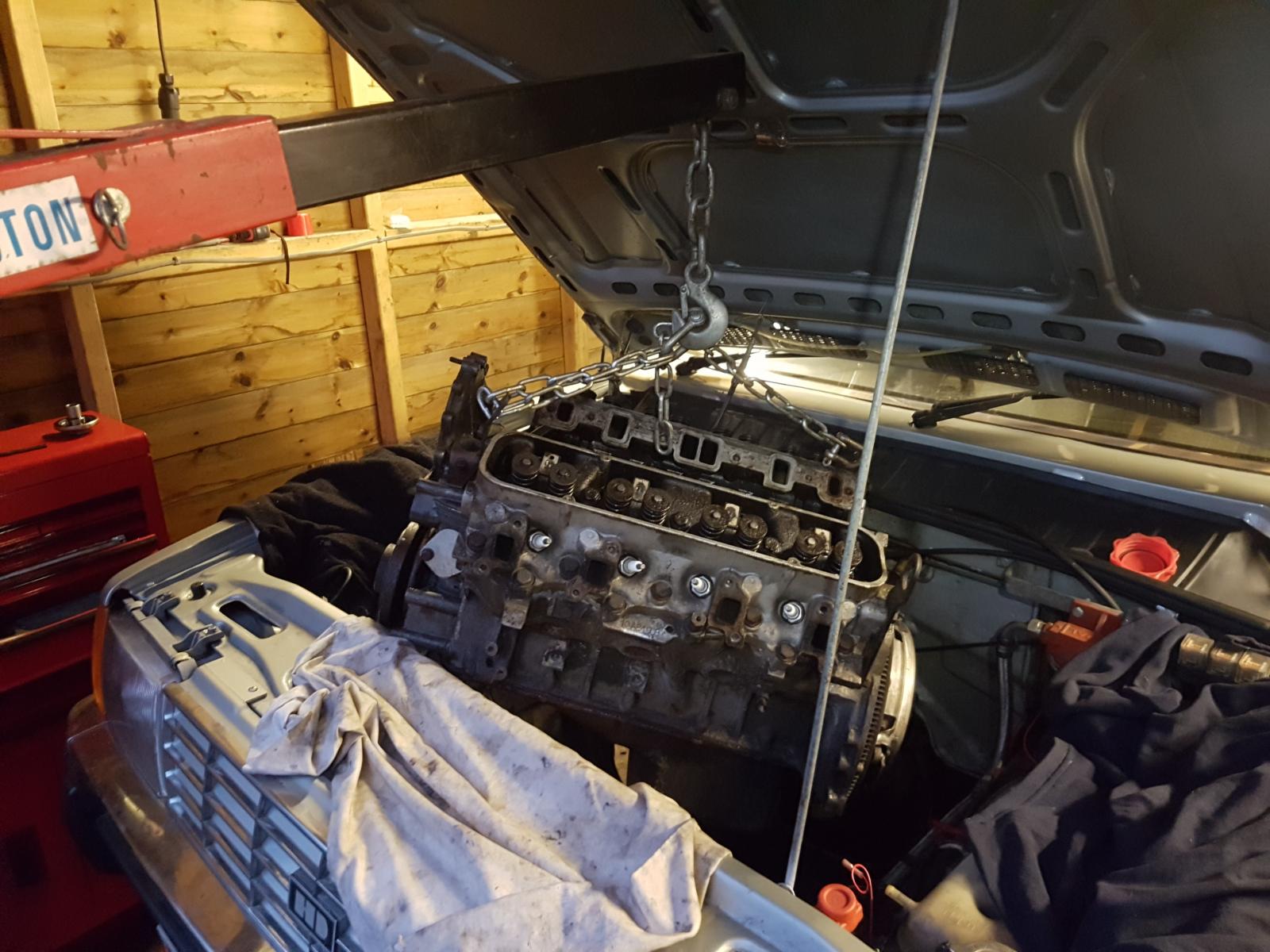

Had a bit of time and a lull in the rain this afternoon, so the engine is now out!
I actually managed to leave the gearbox in place, as if I jacked it up until it hit the transmission tunnel, I had just enough room to slide the engine (minus crank pulley and water pump) forwards and the sump *just* cleared the crossmember. With a helper lifting the bonnet almost vertical I was able to leave it in place, so it was a fairly straightforward removal. A lot easier than getting it in initially! That was with an ancient hand-cranked engine hoist, so raising and lowering it took several minutes...

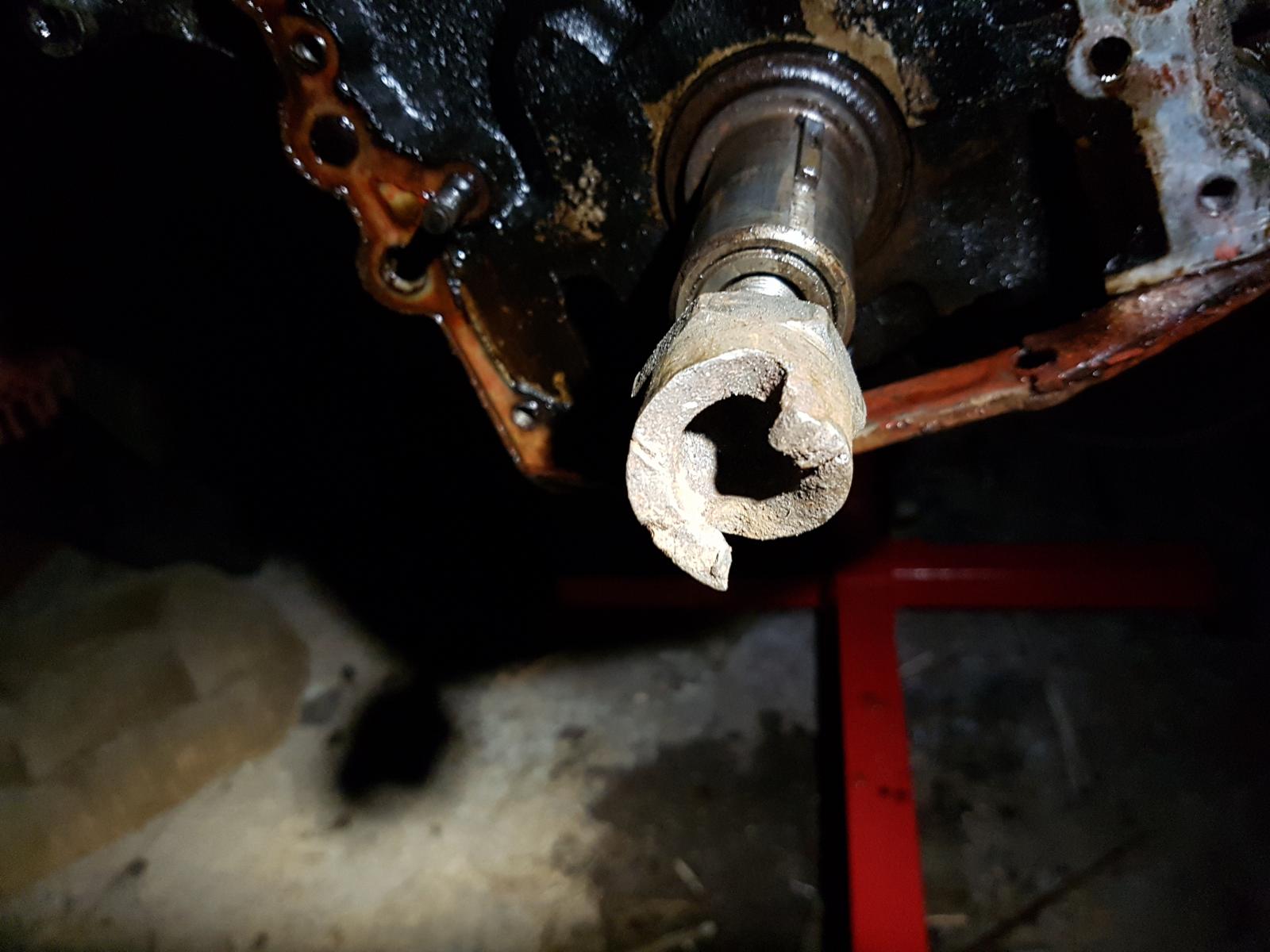

Anyway, I had to go out and buy a 34mm deep socket today to undo the rather strange crank pulley bolt:
PTO anyone?
Once that was done I could start stripping it all down - so far everything has come undone without a hitch.

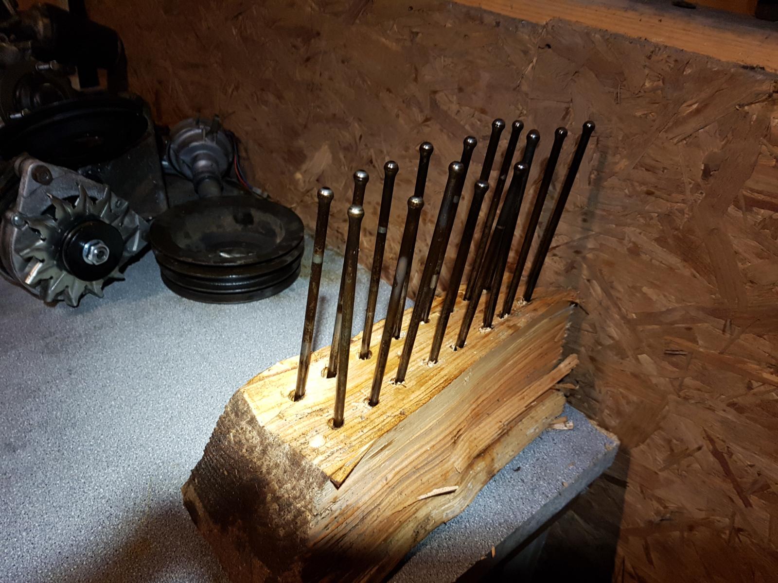

Pushrod stand:

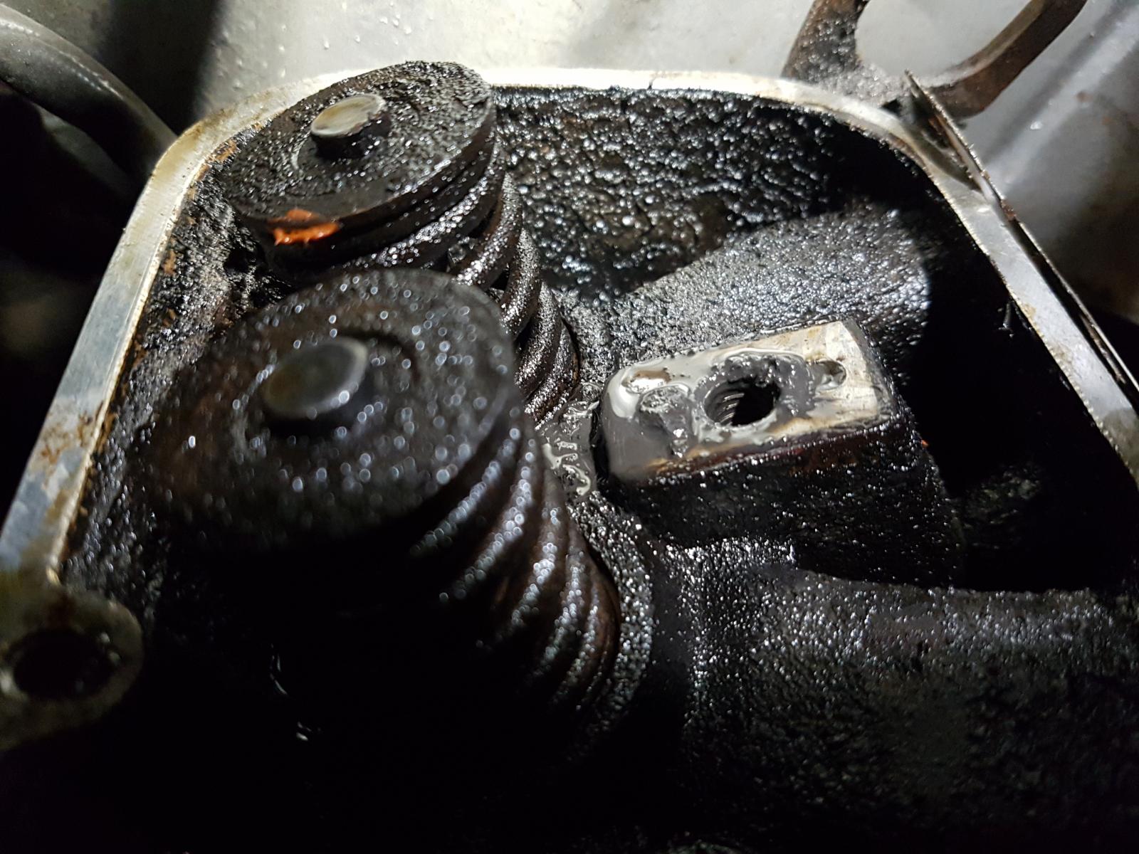

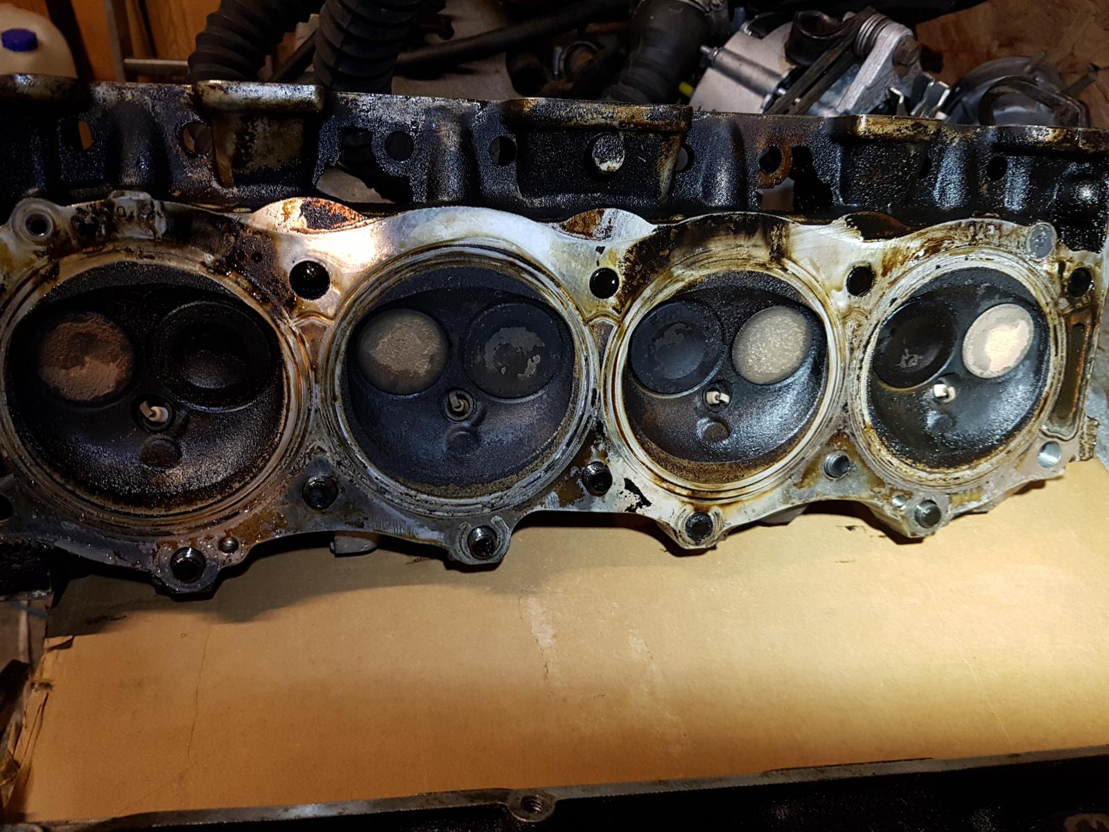

Heads off and looking like the signs of HGF on couple of the pots:

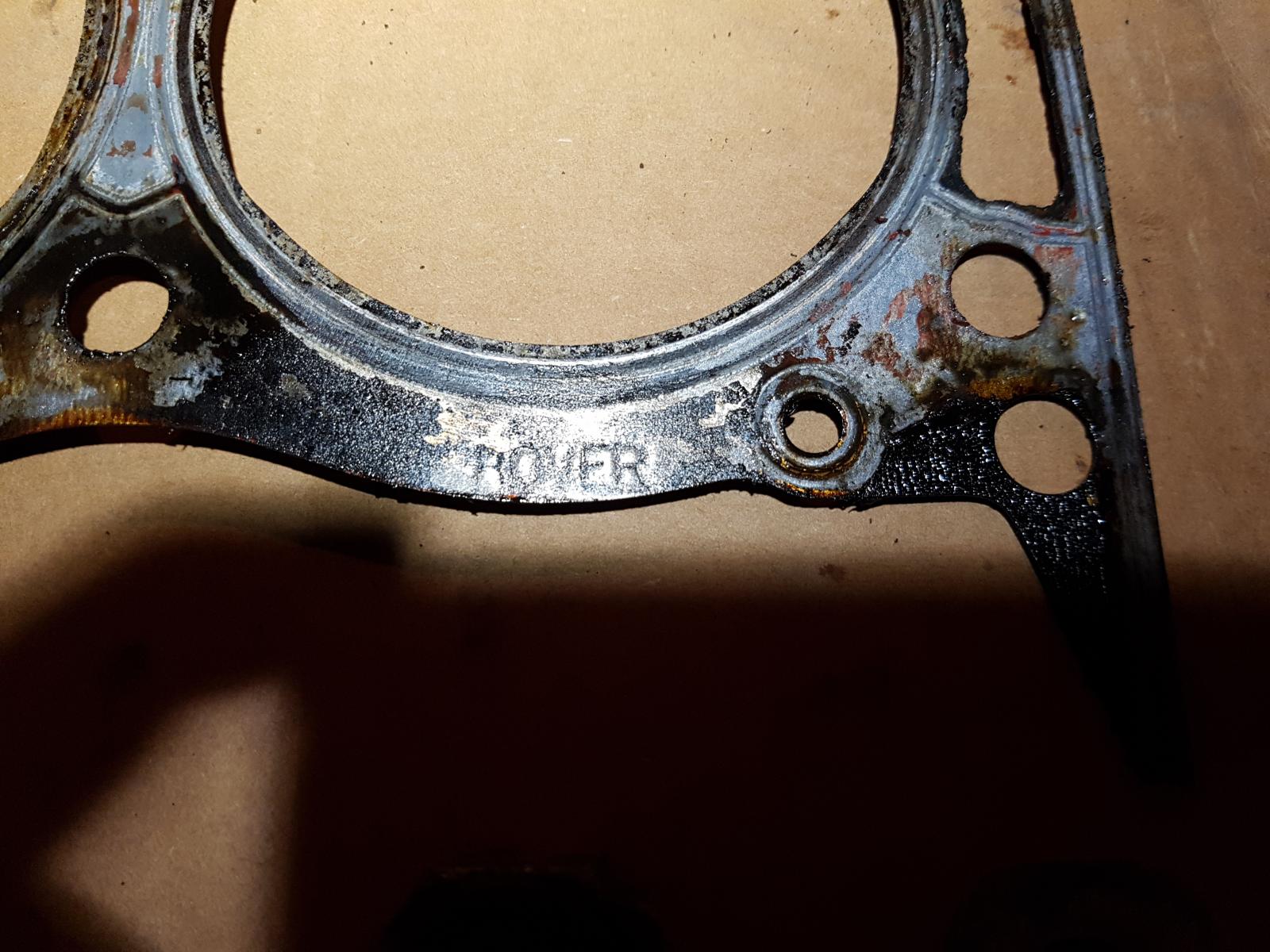

Genuine Rover HG!

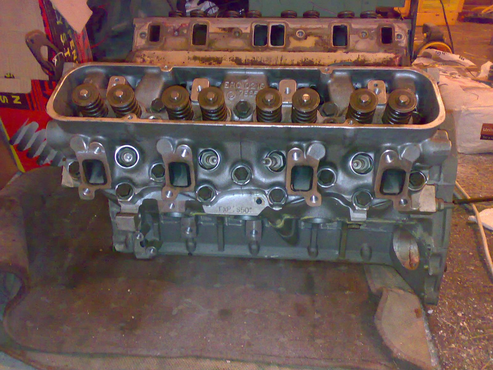

With parts of this engine being early (pre-'76) I was a little bit worried about the heads, but happily they turn out to be the later, big valve style so no need to fit larger valves I don't think.

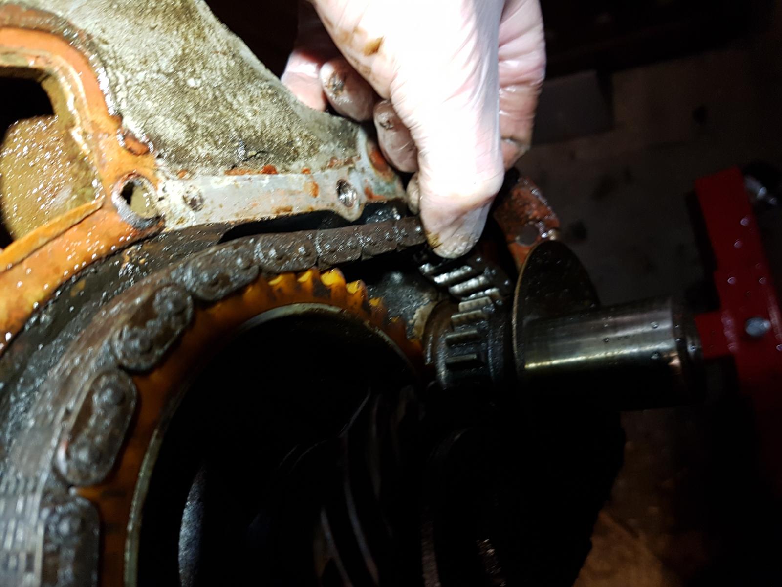

Camchain is a little slack!

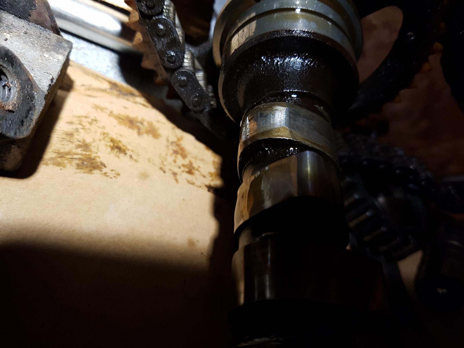

And one of the cam lobes has lost its newness somewhat:

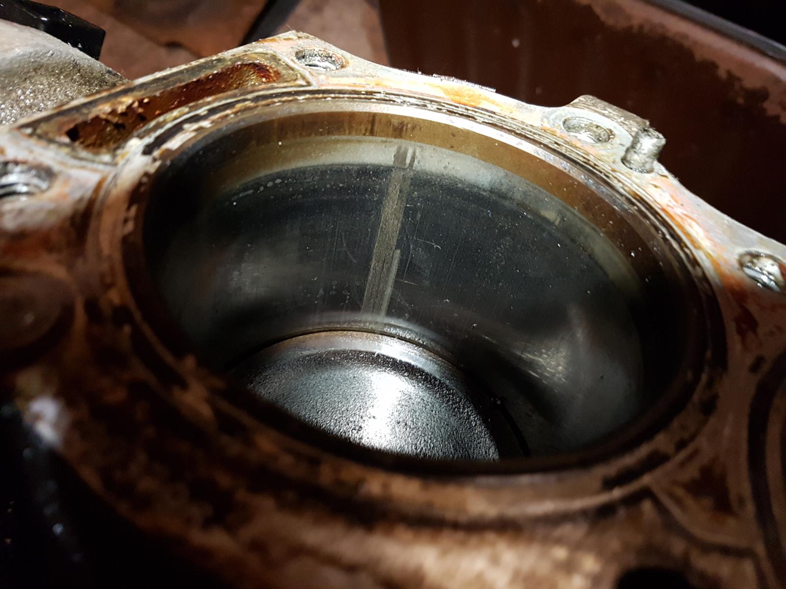

The thing I'm most concerned about is one of the bores though. Generally they look in good condition, with no step at the top of the ring travel. But one of them has this nasty looking score mark :-(
I can't catch my fingernail in it, and can barely feel it with a fingertip so am hoping it will just hone out without the need for a rebore.
Eesh. Glad it's not catching a nail, so you may be in luck. The Dyane had similar but it was a nail catcher. Bit easier to sort out on a Dyane though...
