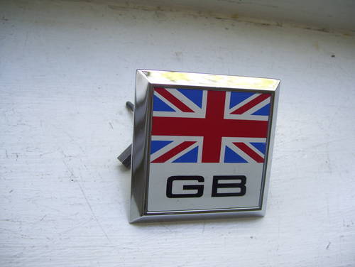

I don't know how you feel about Grille badges, but I have a pristine 'GB' with union Jack, one you can have.... I got on a used grille I had shipped in from UK - naturally enough its not of any use to me; needs 'repatriating' etc ... I reckon itd go well with the overall 'look' of your 6'....

@dieselassist:  I'd be more tempted to put it on the Princess.  Whatever it ends up on, it can be the badge of perserverance/bloody-mindedness.
Whichever of your motors it finds itself on; Im sure it'd be 'worn well', Pm me your address, n I'll post it on; whatever the postage cost is (irrationally expensive postage is here, to overseas), you can maybe donate to dave47 /the site, is that sounds reasonable???....
I'll have to get off the grille first; it was wound on there very tight on one 'peg' n wasn't for moving (maybe someone very bloody-minded fitted it) last time I tried (didnt want to break the grille); might be the weekend/early next week before I get it off n posted to you....
its an *ideal* grille badge for princesssss
