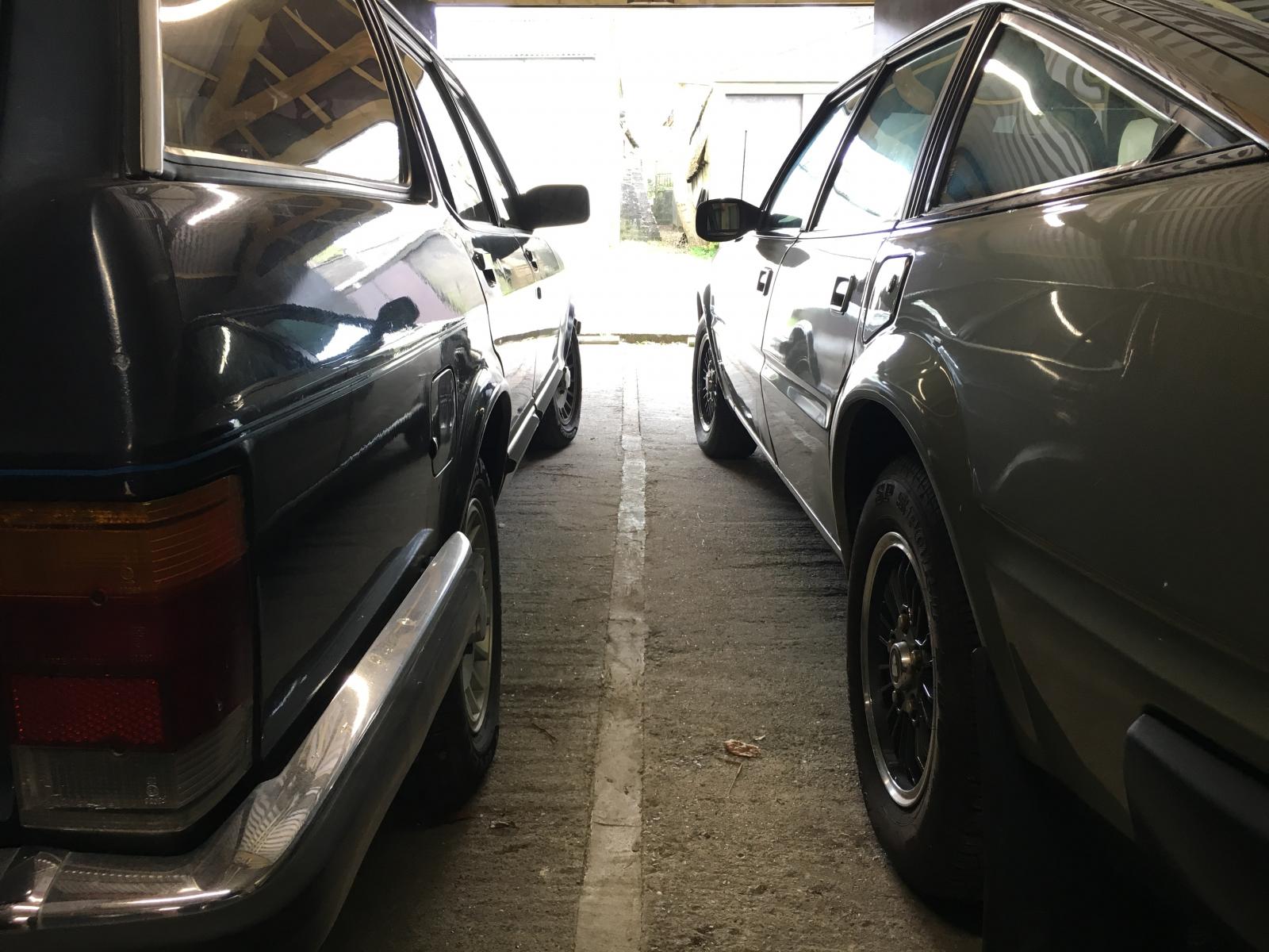

Skizzer Posted April 17, 2017 Author Posted April 17, 2017 FOATARZE NOWS!!!!!! somewhatfoolish, Brodders, RobT and 8 others 11
danthecapriman Posted April 17, 2017 Posted April 17, 2017 Brilliant work Skizzer! The Rover looks superb, lovely colour too. Good to see the Granny in good company in your barn too! No more winters sitting outside on my drive anyway!! Best place for it to live. Skizzer 1

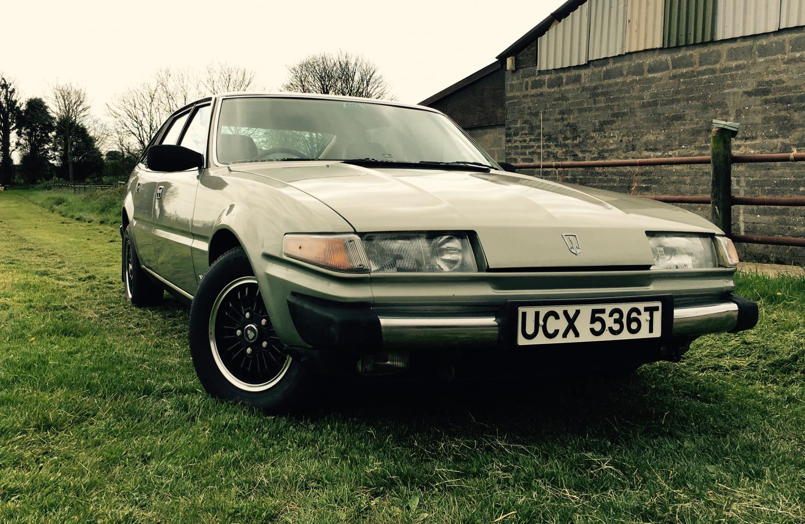

Skizzer Posted December 10, 2017 Author Posted December 10, 2017 I’ve been using this quite a bit since I changed the distributor and sorted out the timing, it’s running nicely and really is a very pleasing thing to roll around in - super comfortable, relaxed, plenty of performance and a lovely V8 growl. Random photo: However, it shat on the carpet the other week when the boot catch failed - it won’t release at all. Unfortunately it’s impossible to fold the back seat down without releasing the heavy duty catch inside the boot, and the (original, unreplaceable) parcel shelf is also pinned down by the tailgate. Any suggestions before I get radical with an angle grinder? Cleon-Fonte, Magnificent Rustbucket, phil_lihp and 7 others 10
