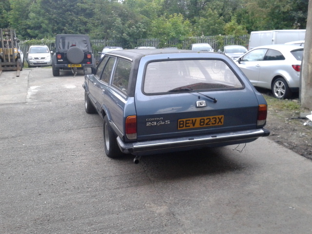

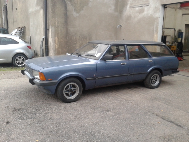

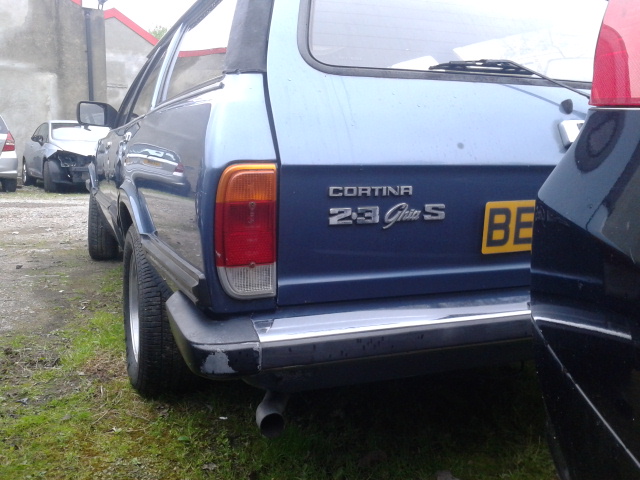

Cortina estate-
After some half arsed prodding with my prodding finger, many parts were found to be prod proof...others less so. A-posts both sides will require work, rear arches and sill ends are fucked. The metal work around the rear side windows, both inside and out, will require some fab work. The front wings are crusty around their extremities (front indicators, bottom four inches behind the wheel, a two/three inch band where they meet the front valance) aside from that though it's pretty much bang on.
Mechanically it's sweet as a nut but will get a thorough going over in due course. The temptation at the minute is an oily rag resto to get it legal and put some miles on it, but practicalites and finances are putting a stop to that at the moment.

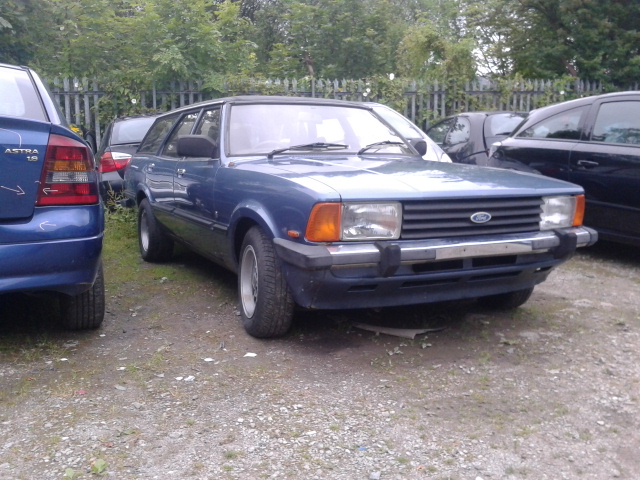

Blue Cortina-
My very half arsed attempts at selling this bore no fruit (unsurprisingly). I then saw it as a potential parts supplier to the rest of the fleet. I bought it blind off ebay, realised it was a turd on sight but went through with the deal nonetheless. So far i've done 400-500 miles since purchase, as every journey has been a new lesson in wallet rape with constant failures and new horrors to discover, i only use it out of sheer bloody mindeness that it can't be as bad as i remember.......but it always is.
So in true shiter style i'm in the process of rolling repairs to get it to a reasonably useable level and presentable condition before selling it on for a massive loss, the proceeds of which i'll no doubt spend on another rotten blue oval turd.

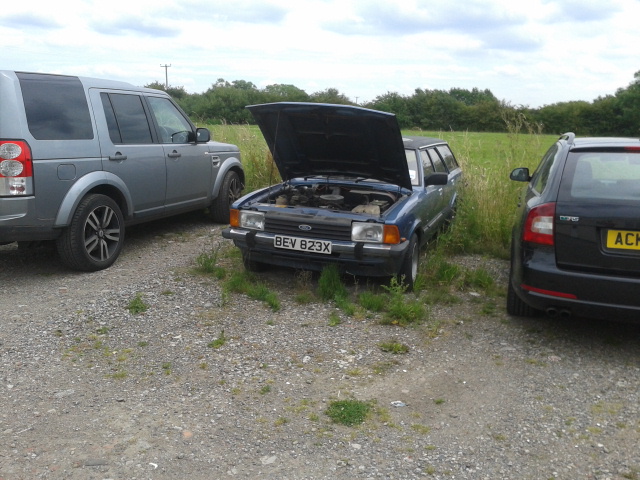

First sight after two years of parting, it nearly fired up as well but the battery i had brought was shit.

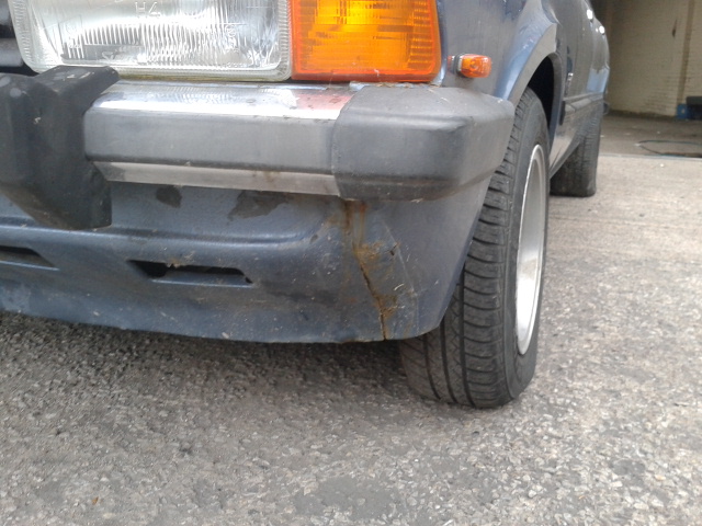

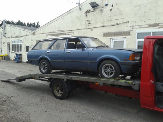

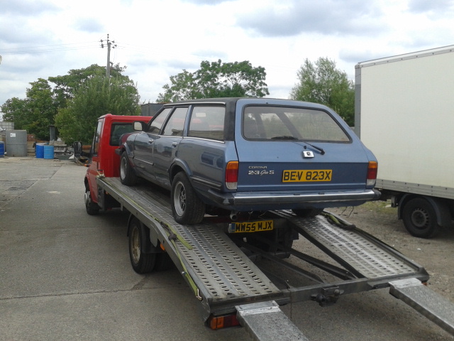

Loading it up required hot dirty winch action, which i got carried away with and bent the bumper and smashed the plate.

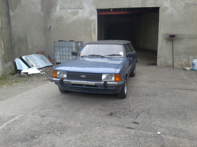

Off to start it's new life......sitting outside some other poor buggers workshop
The eagle has landed! with a jump pack she fired on the second go despite three year old fuel

The bent bumper gives her a slightly miffed look

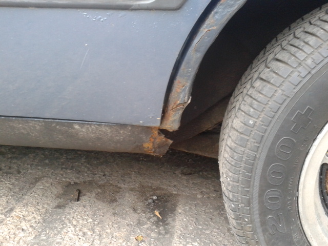

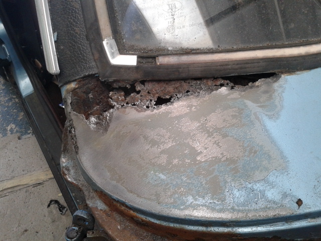

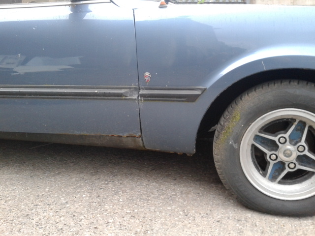

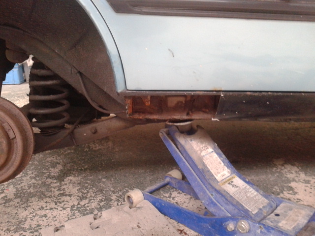

The sill should be repairable, but the arch is toast. Another six inches above that rot hole is wob.
The door looks worse than it is, but i've alrady got an NOS skin in stock so it's a none issue

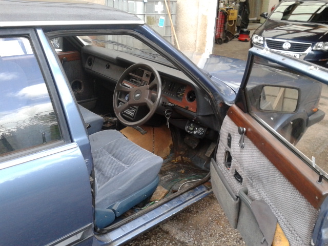

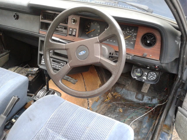

Some were between leaving club circles and me buying her she lost her interior (as well as a few other model specific parts) I got it with the two blue seats in it, a blue rear base and four blue doorcards in the back. I've since got hold off a full, absolutely as new, interior in the correct colour grey (not all banger racers are twats shocker!)
"Those two clocks that look like you'd smack your knee on them?" "you do" "oh..."
Like the treasure hoard of an ogre with very low standards. It's incredibley light and airy inside, with a nice low loading sill and fantastic capacity. Puts anything modern to shame.

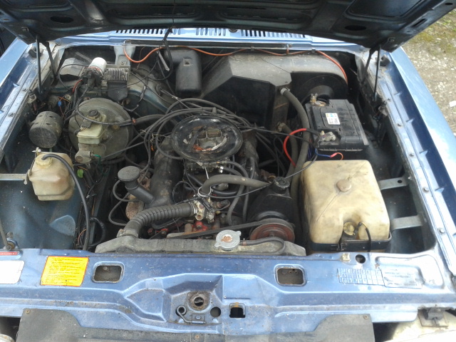

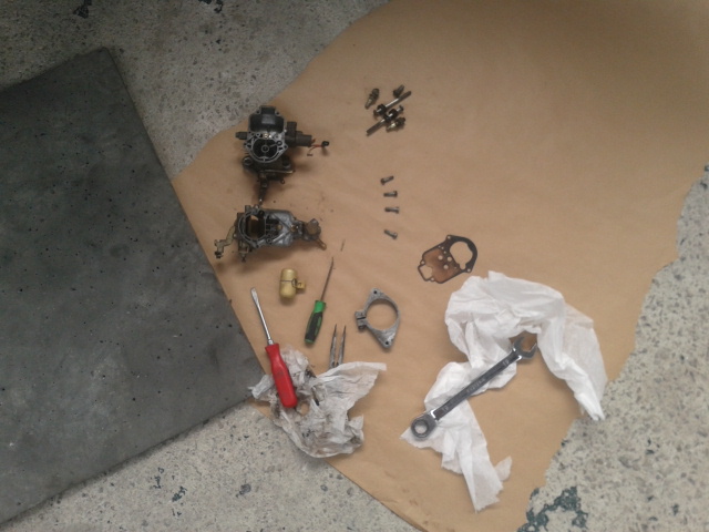

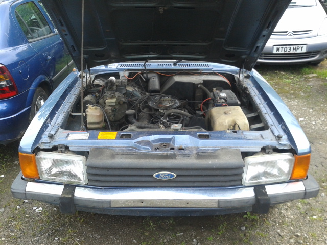

This car has pissed me of in many ways, but i'm slowly trying to sort it out. I've been on the look out for a cheap rear axle. Cortina axles come in two flavours, megabucks and fucked. Got this combo for £115 with the the type 9 behind it (out of a capri, with stick, bellhousing, crossmember and clutch fork) which was a bargain frankly.

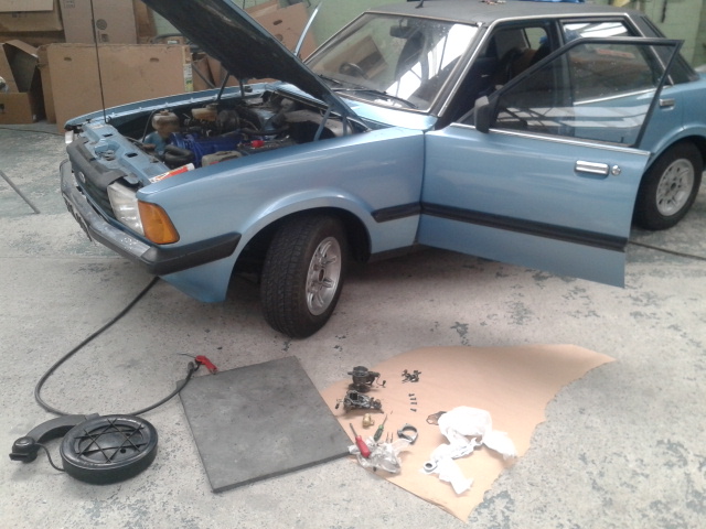

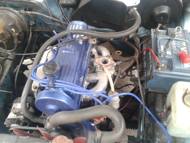

It's been jerking like Michael J Fox at a disco recently, mainly at low revs and on the overrun. Taking the top of the carb revealed fine rust sediment in the float chamber, so a full strip and blow through followed. I'm sure this problem will happen again soon, meaning i may have drop and clean the tank.
I set the valve clearances while i was at it, inlets were fine but all the exhausts had closed up by a few though.

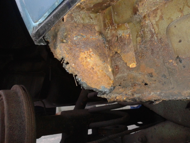

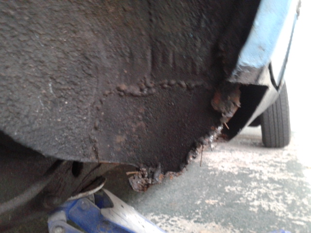

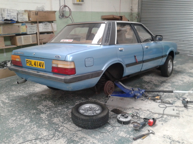

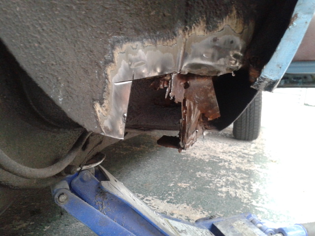

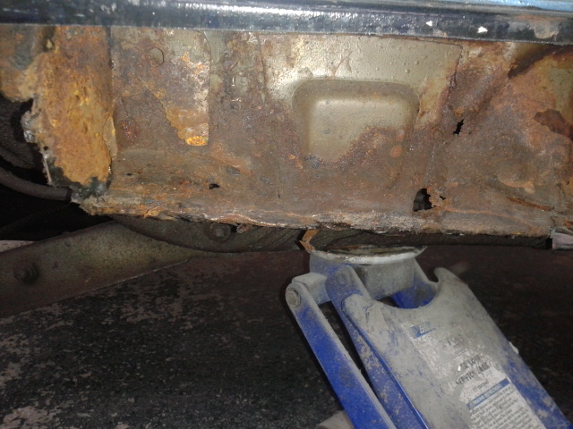

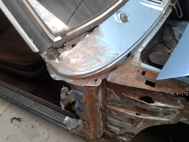

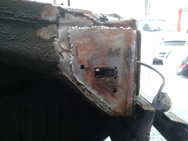

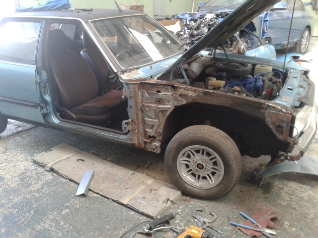

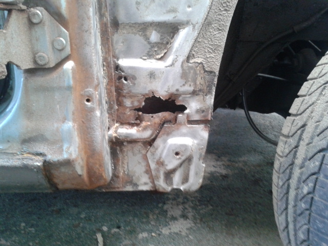

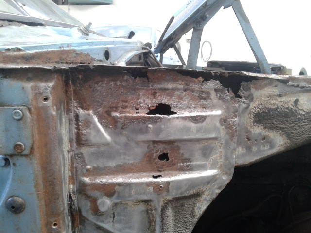

I went into work today to weld up the rear jacking points that have been previously done by a fucking retard (that's the politest way i can describe the standard of workmanship) Instead i put off the inevitable and looked behind the wings.....
This explains the wet carpet.
Like all fords, you remove the wings to find fresh air and pissed on dreams...
When i was a kid, maybe six or seven, we looked after a neighbours dog when they went on holiday. He was an old labrador named Harvey, one day sat in the back of the car with Harvey next to me when i noticed his lipstick poking out, at that age i didn't understand what it was and ,with genuine worry, said to mum (who was driving) "mum there's some wrong with Harvey, look"! she turned to see me poking the dogs dick wondering WTF fuck it was. Cue the voice of satan declaring "Dont touch it!" i shit myself, the dog shit himself and we never looked after Harvey again.
The moral of the story is some things should be left alone....
This is the standard of previous bodgery i'm finding all over
The right hand front inner wing/top rail section is all repaired now, I ran out of time to do anymore so did the approved ford repair of gaffer tape over the casm in the scuttle till i'm back work next week when i can take the screen out to sort it properly.
I think i've fried the alternator welding as well, the battery light failed to extinguish on the whole 30 mile trip home.

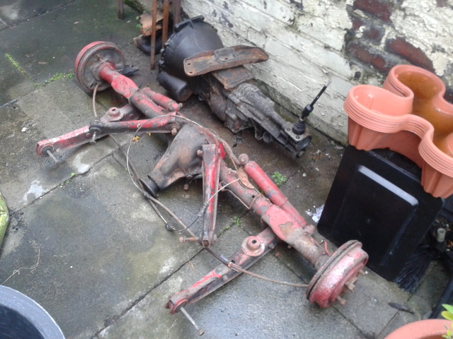

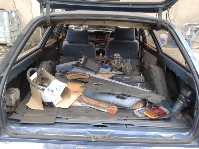

Blue cortina above became a parts donor, after an unending stream of failures sucked the enthusiasm out of me.
Right rear brake went fucked, can't remember the cause now but saw a rust bubble and like dick poked it.......
