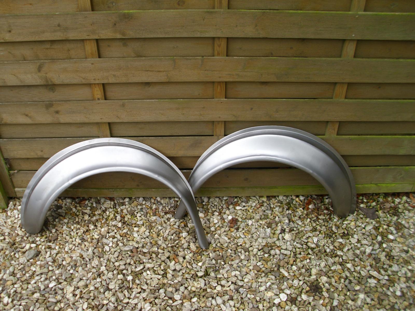

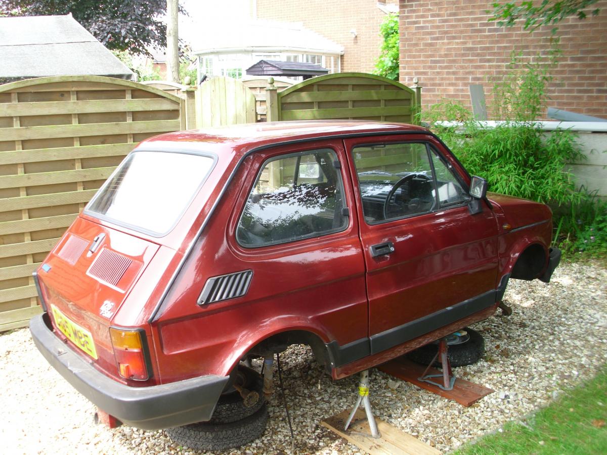

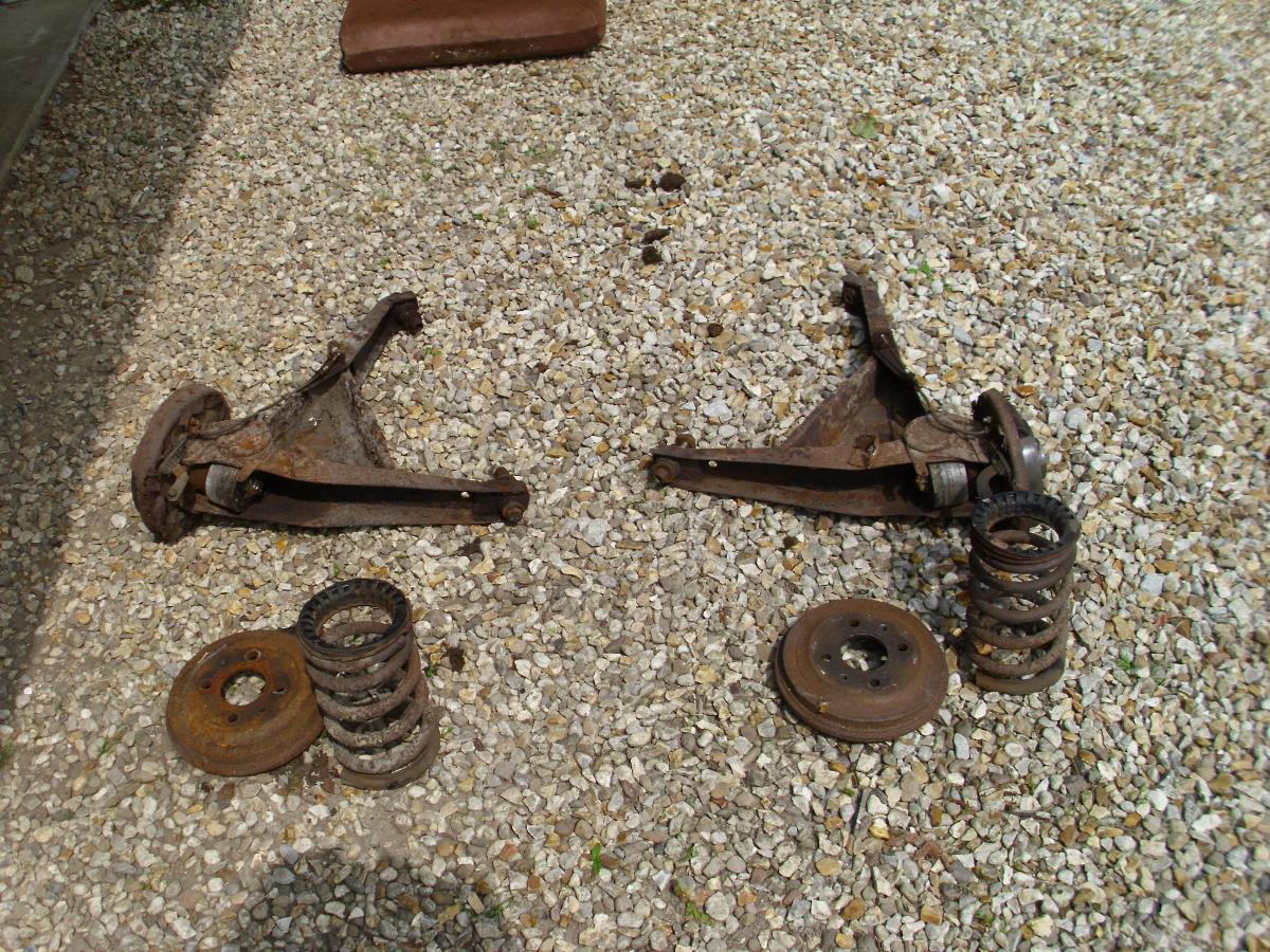

Vin Posted September 10, 2014 Author Posted September 10, 2014 Update. Right I resumed work on this a few months ago. Jacked it all up and took off the rear suspension, it was all loosely done up anyway, and started attacking the rear inner sills. I did this by removing sections of the outer sill, cutting the crap out and welding new metal in. I then had to carefully re-weld all the outer sills back on without messing it up. Unsurprisingly, I found that the inner sill rot had spread up the inner wheelarches. I managed to get hold of a pair which I was able to chop about a bit to weld bits in. I ended up getting a new petrol tank as well. I took the old one off last year as it looked a bit scabby and needed a repaint. When I took it off I found that the 'tank seal' that I had put in it over ten years ago had all shrivelled up and turned into a great big 'poppadom' thing in the tank... I couldn't get it out as it wouldn't break up. Ten years ago I had to refurbish the tank as you couldn't get hold of a new tank very easily, so I'd repaired all the pinholes with chemical metal and a coat of tankseal. Nowadays you get spares on the web easily from Germany and Holland, so I was able to get a new tank. I painted it with POR 15 and fitted it. My mate came round and between us, using his tracking gauges, we set the front up and adjusted the back as well. Although I'd put new track rod ends on, we ran out of adjustment, even though they were the correct ones for the car. We think the cause is the new spring riding high... Anyway we shortened the track rod ends in the lathe and then drilled deeper and tapped more thread into them, this did the trick and we were able to set it up OK. When the spring settles down a bit, I'll adjust it again and I'll maybe have to fit some 'unmolested' ones. Anyway, my mate asked me if he could borrow the 126 for his cousin's wedding on the 6th Sept. Now my mate's uncle was the chap who used to own it before me, so it was a good incentive to get it finished... Well it was finished on time and I got an MOT on it last week for the first time in 4 years...No advisories either first time with this one... It went down well at the wedding too... I've got hardly any pictures of the past few months work tough...Sorry. I went out for a blat about in it earlier this evening...I'd forgotten how much I love driving this thing...I took the opportunity to take some piccies of it too... Jon, saucedoctor, mat_the_cat and 7 others 10

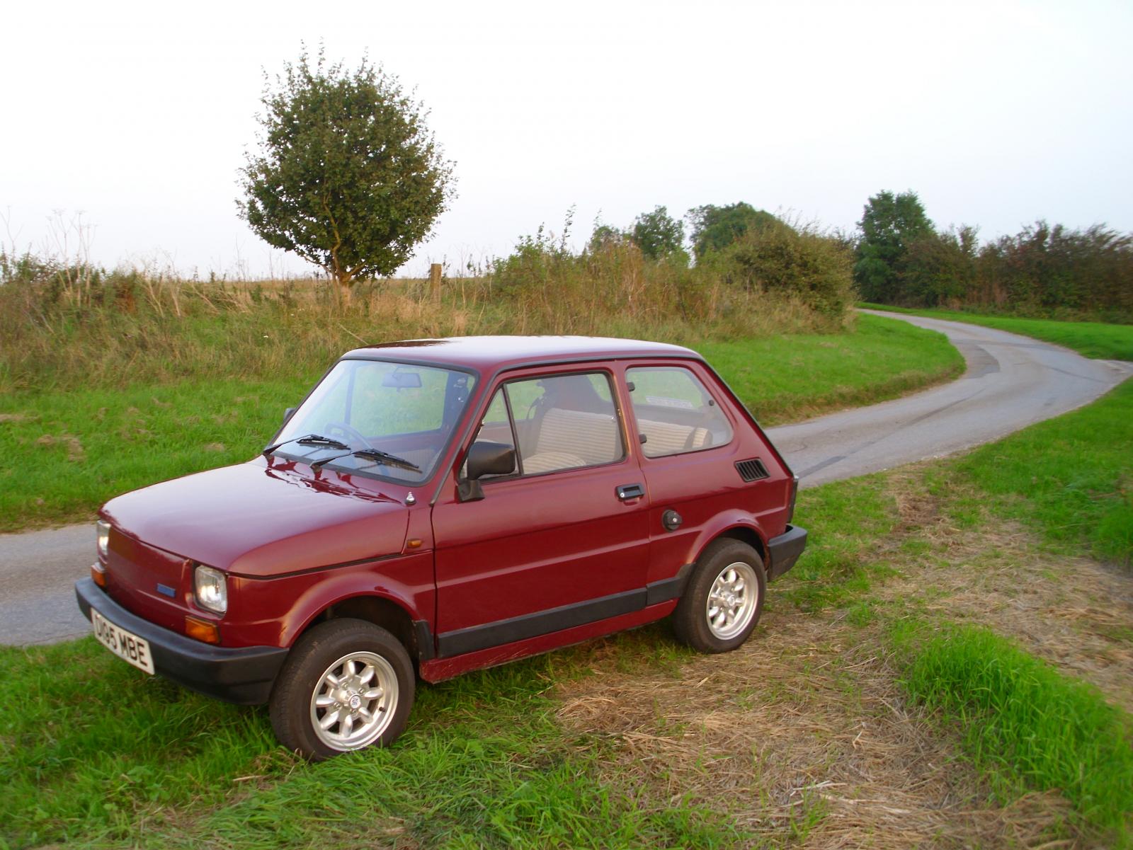

Vin Posted September 12, 2014 Author Posted September 12, 2014 Cheers for the comments. Much appreciated. :-) Alloys are always going to be an 'interesting' subject...I got the alloys for it in 2009 as the steel wheels with plastic centre caps were getting a bit scabby and the car needed to look spot on for my sister's wedding...my Dad drove her to to the church in it... I didn't really know what to go for but in the end I went for a set of genuine minilites (I bought them as blanks and they were drilled to the correct 98 pcd) mainly because I think it's a wheel that looks good on anything really. I still have the steels and have no intention of getting rid of them. They were blasted and repainted about ten years ago...as a result two of them were 'pin-holed' badly so they run with inner tubes. The alloys have been sat in the loft for the 4 years it hasn't been on the road, steels go on when it's in storage... I need to get a pair of new door handles for it really and it could do with new quarterlights as the frames are letting it down a bit. It could also do with the external door window trim replacing...I can get all this from somewhere like Axel Gerstl or Ricambi500...but it will have to wait for the cash ...and the time too..as it's just had it's 'time in the sun' for the moment...other things press...
