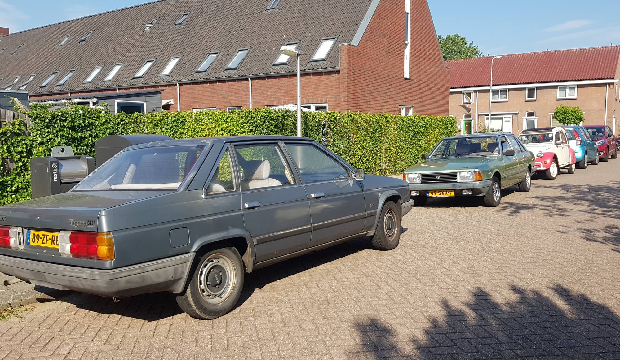

go on - theres gotta be a reason the windmills sombrero has slipped :D
mmm tagora
been louwman 3 times - is the chinese big white saloon still in the lobby?? :D
Crap. Yes. I got a fleeting look at it and meant to go back to have a better look. Never did.

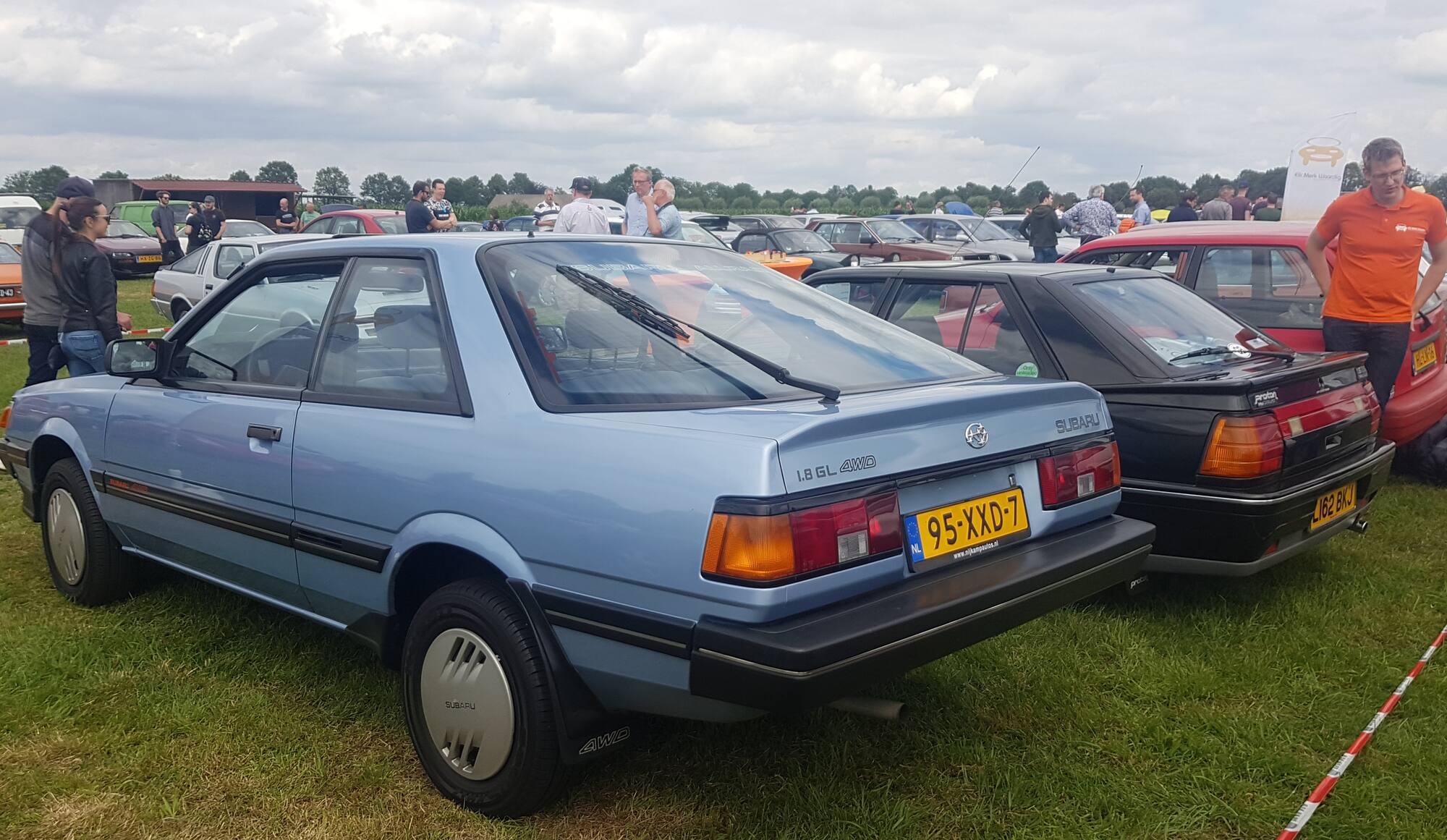

Yesterday was Japan Classic Sunday. It was amazing. 550 cars, all stunning and mostly very rare.
Just gets better every year. Will be a full video report but by 2pm, much like the museum, it had become a bit much. Too much 'I've never seen one of those before.'

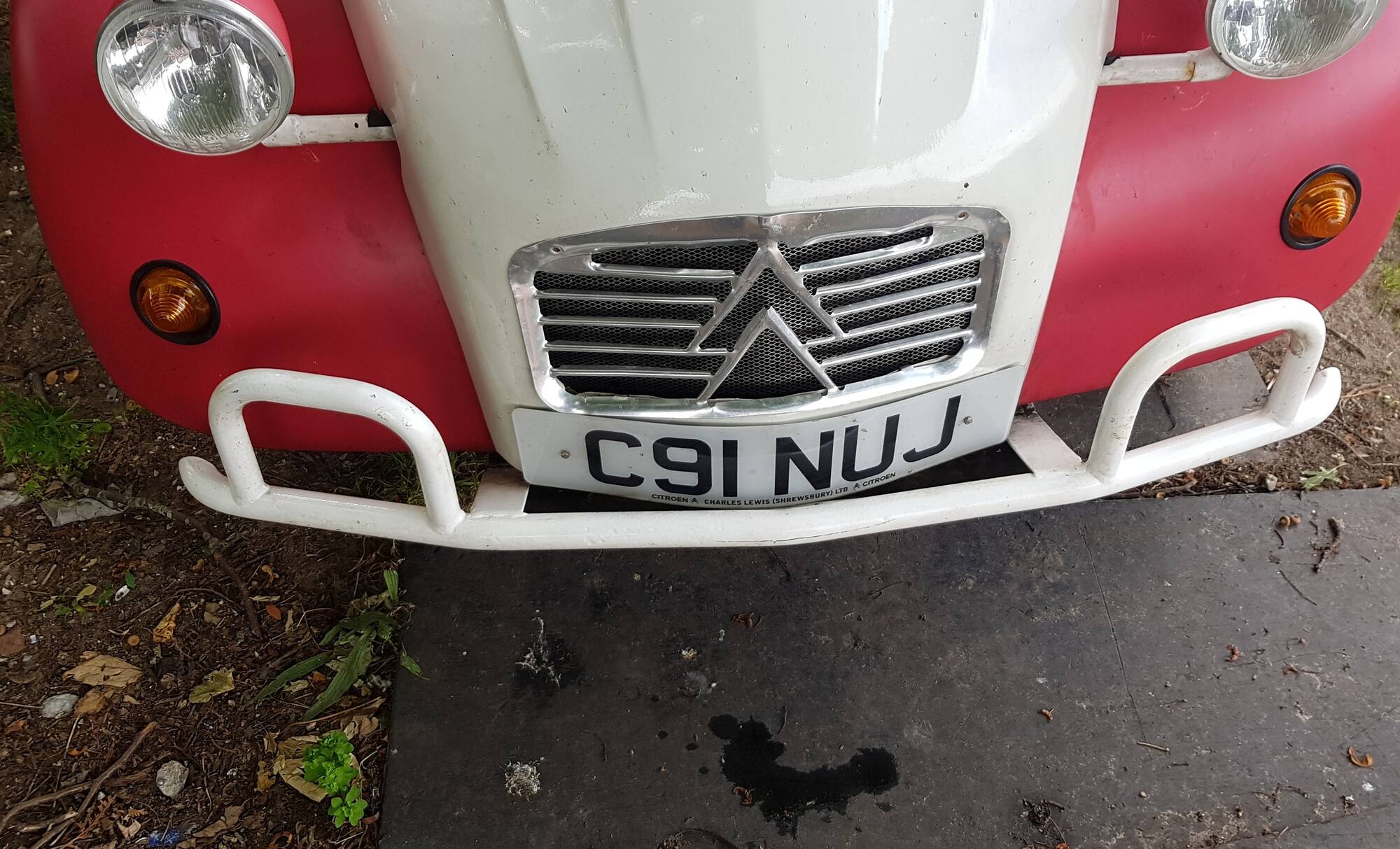

Wings might be coming off again... IMG_20190708_185431_899.thumb.jpg.ddac9d89c9e890d367d27c10856f053a.jpg
Bloody oil leak. I'm now up near Amsterdam. Was meant to be sight-seeing tomorrow, but I need to find the source of this. If it's a slight leak about to turn major, I'm in a spot of bother. If it's a minor leak that I can fix, that removes a lot of worry.
If the worst happens, I am heading over to France next week and with notice can take a different (tow) car and a trailer.....

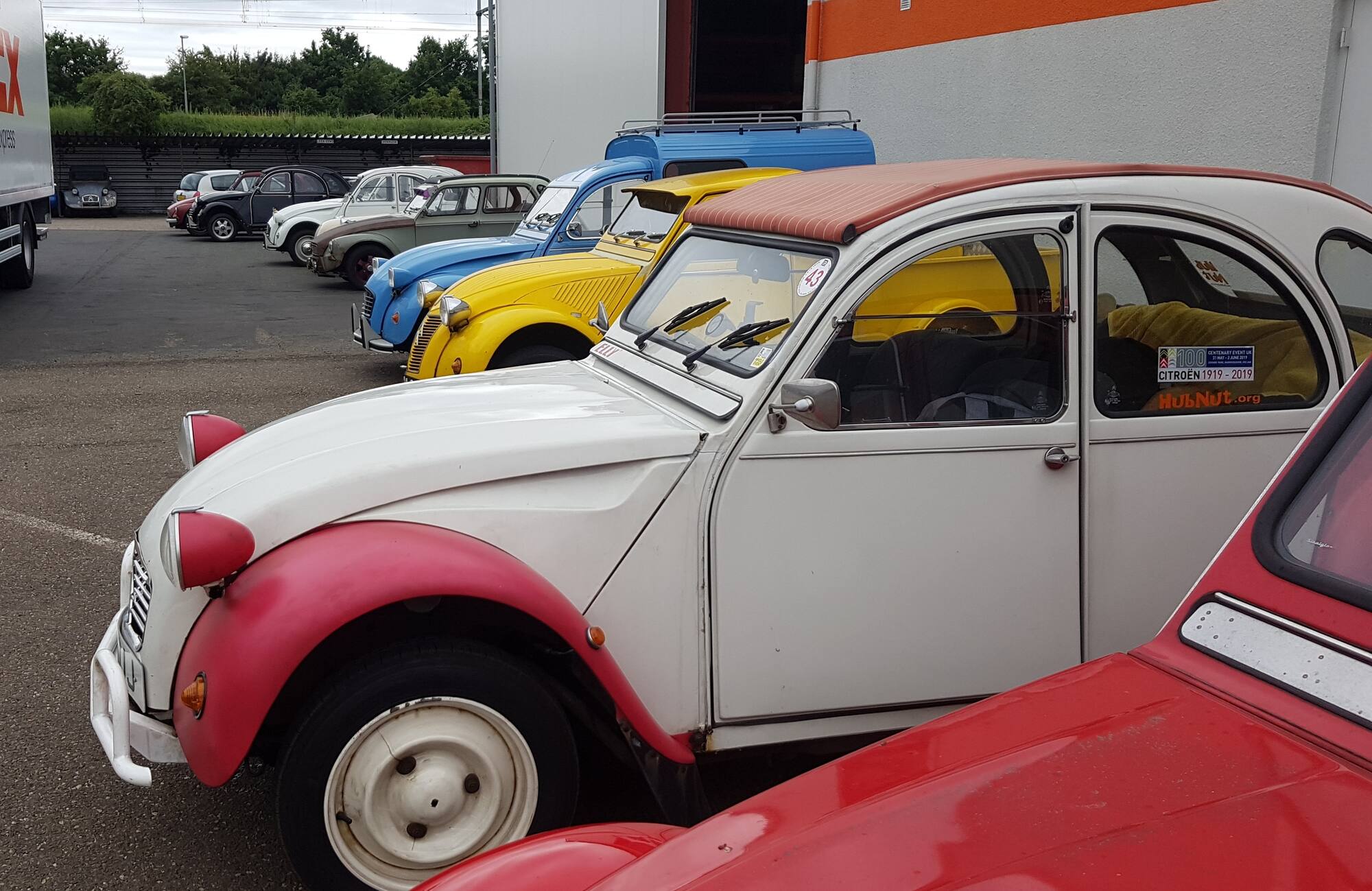

Thanks. I'm now at Burton Car Company in Zutphen, who specialise in 2CVs. Indeed, Elly's suspension dampers, half the engine and her exhaust clamps came from this place!
She has already caused some amusement for being RHD.
The oil leak is one issue, but there's a front end knock that I'm increasingly unhappy about.

Front end knock looks increasingly like kingpins, but they reckon the arm is knackered too, so no quick and easy fix. They did say they could replace the entire front end with recon parts for about 1000 Euros. I declined that offer, mostly because the steering rack has already been reconditioned, so it would seem foolish to replace it. I'll be living with that until I get home.
I foresee major expenditure once I'm done with travelling, as the suspension cans are also quite rotten. They're one of the few original items on the car, and it shows. Mix in a pair of reconditioned front arms and it's all a bit YIKES.
Oil leak does look like pushrod tube seals. They had time for a look, but not time to remove a cylinder head and deal with iffy seals. Not sure I fancy doing that either. Also filed under 'live with it.'
Had a day of rest yesterday, well, I went for a bike ride and and walk around the delightful town of Zutphen and left Elly at the B&B. She repaid me by refusing to start. Checked the plugs. They looked pretty old. Maybe we forgot to swap the newer ones in when we swapped heads... One was a little white, which is a little concerning. Too weak on one side? Maybe that explains the pinking.
