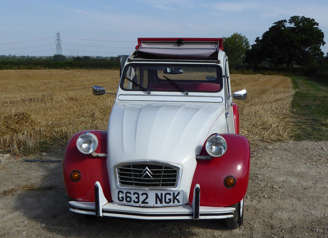

Back to work today, so trying to balance writing features and sending emails with tinkering. This is why I've been rushing so far. I know time is going to be very tight this year. Still, I managed to get the hood refitted, fix the boot lock and get the new grille and mesh fitted. Proper bling!
I'm actually quite annoyed at how the well the paint has come out. I expected a shabby finish, so didn't go crazy with prep. Now, that dent just below the RH headlamp is irritating me, as is the somewhat lumpy finish on that side (due to removing some, but not all of the previous paint as I chased the rust out). Time will tell how long this paint job lasts, but I'm very impressed so far. Hoping to get the number plate fitted this afternoon (more drilling - eesh!).

..I wonder - would the number plate not look neater under the bumper, in front of the white box - to leave the bonnet less cluttered ?
I imagine it'd last five minutes, if that! The bonnet is designed to take the number plate. It looks right there, even if UK number plates are a bit larger than the French ones the panel is designed for. I have a severe dislike of 2CVs with the front number plate mounted anywhere else.
Mine is properly dressed and even has the correct front bumper!
