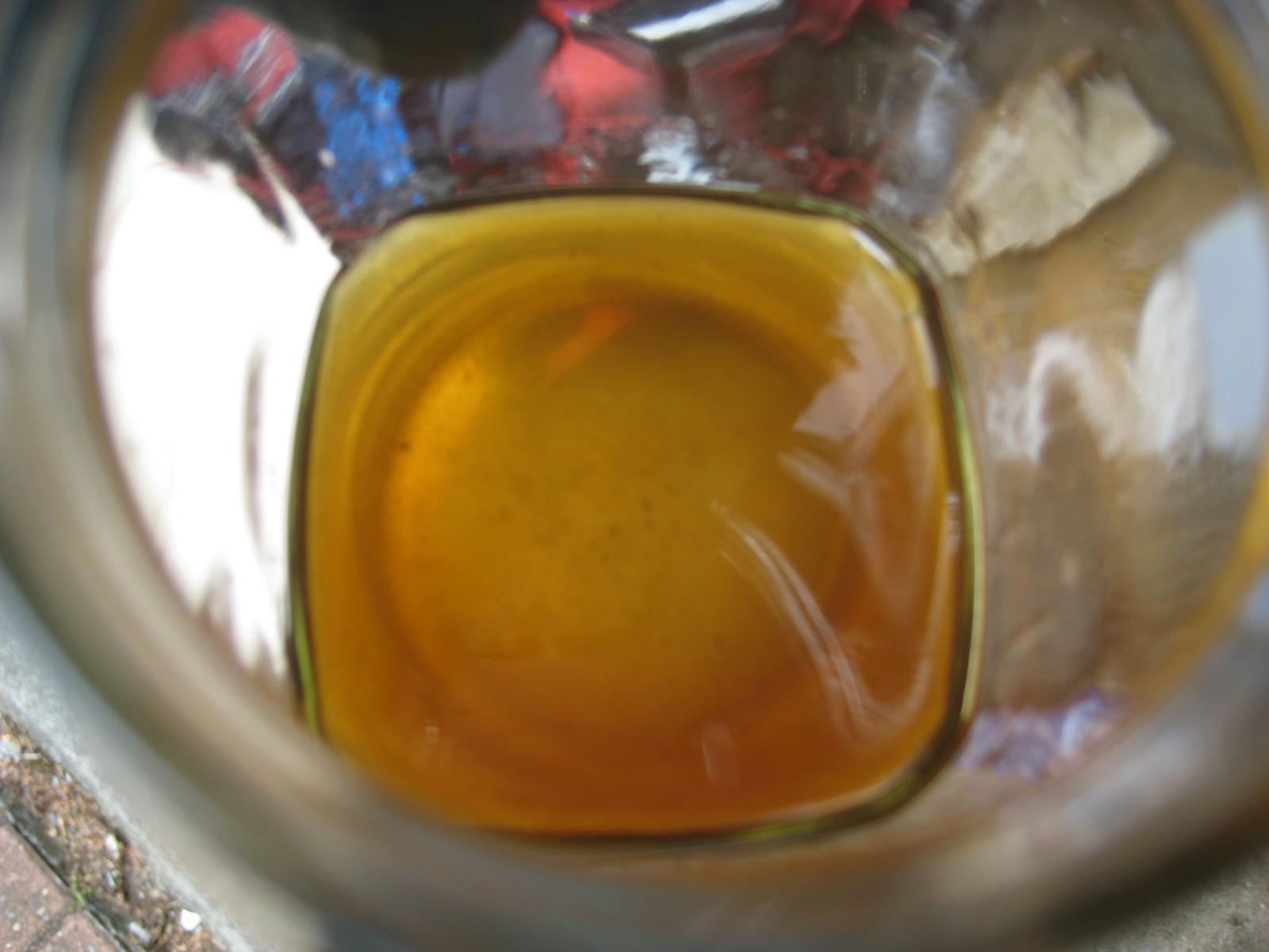

Other news: I've sorted out the clutch on my CBX. I ended up drilling out the borked master cylinder screw in the end, and managed not to damage the master cylinder cover. Which was nice.
The clutch fluid was dark grey, with bits floating in it. Normal service has been resumed with fresh fluid, and a cut-down switch cluster screw from my old 650 Katana as a replacement MS cover screw.
