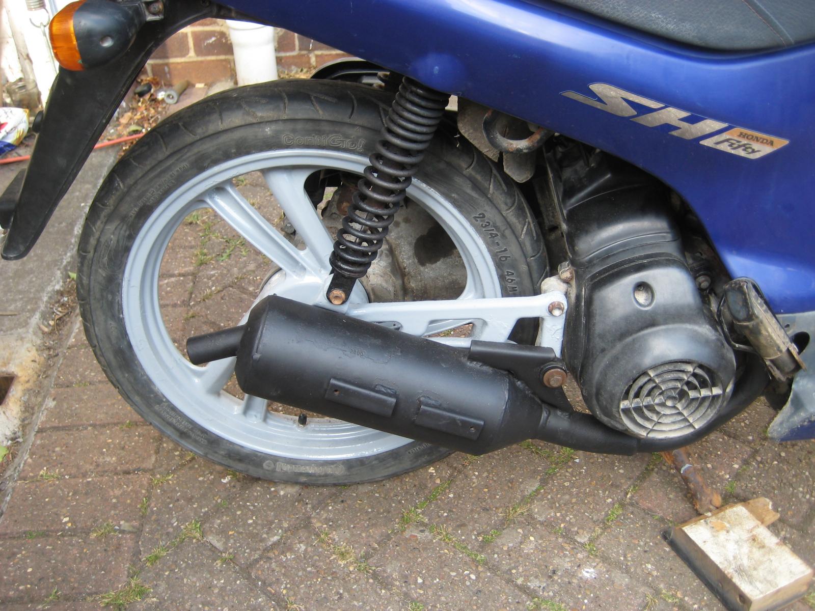

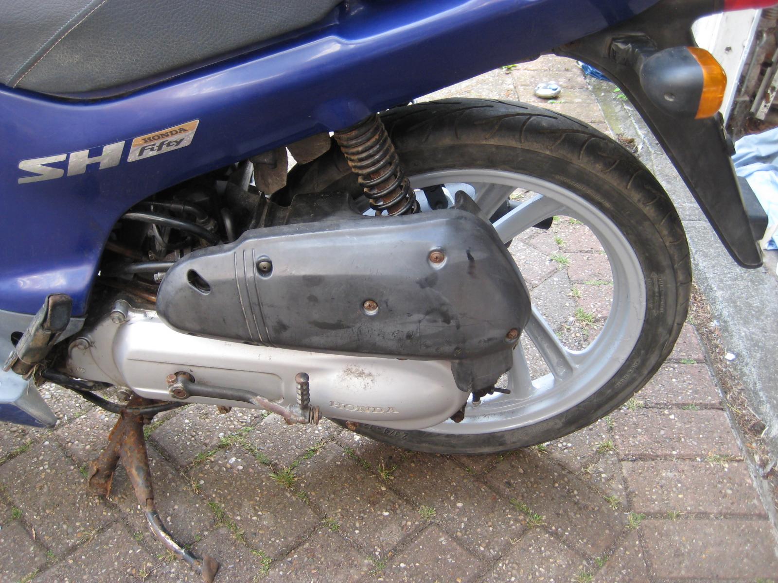

I've been back at it today... the mechanical bits are all back together again, after some fairly rudimentary painting. The tyres aren't rock 'ard or cracked or anything, so they're staying. I blew them up today and they seem to hold air, which is always a bonus:

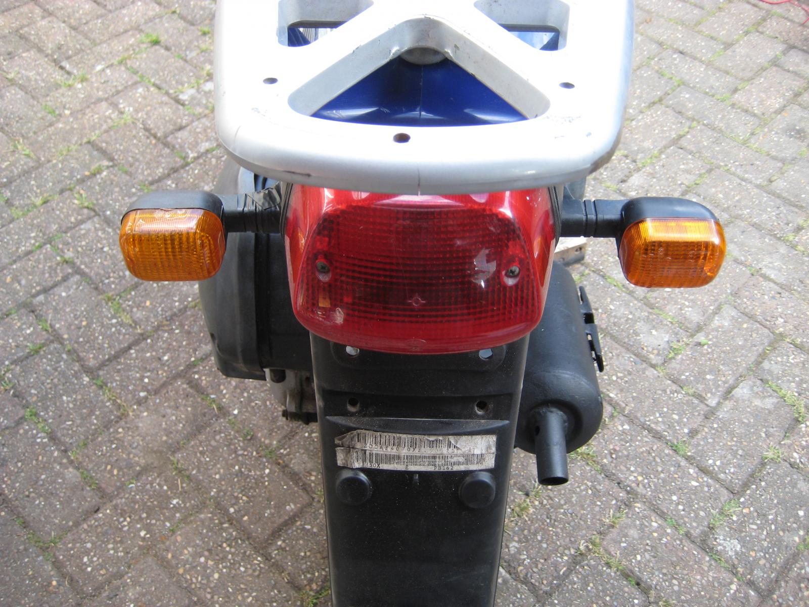

In the spirit of spending nothing more than needs to be spent, I bodged the snapped rear indicators with self-tappers, Araldite and electrical tape:

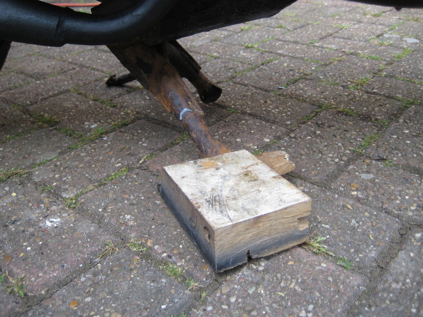

Jobs happening soon - the centrestand is bolloxed. It was rusted solid; in order to retract it we had to lay the machine on it's side while Joe twatted it repeatedly with a lump hammer, so as you can imagine it meeds a bit of TLC.

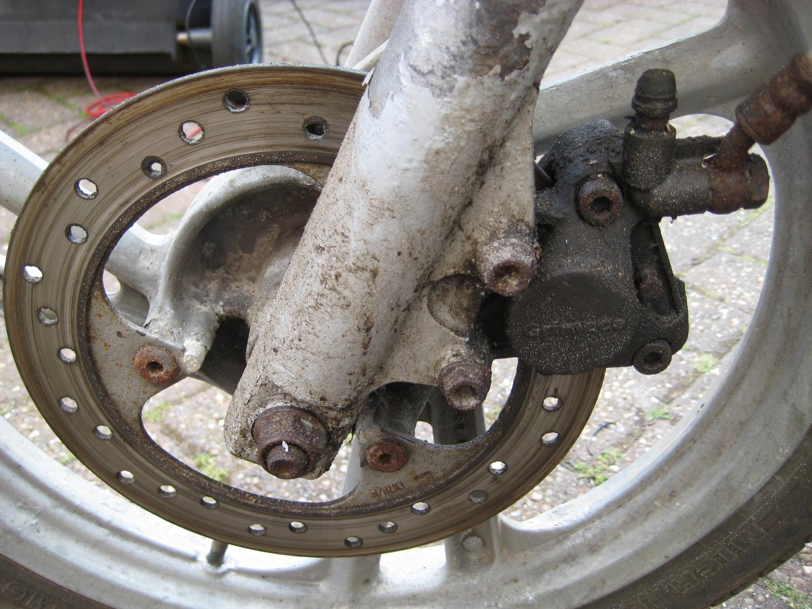

and the last really important bit to sort is this mess:
That's not brake fluid all over it, but 2-stroke oil! Which is good, because that's probably what stopped the caliper from seizing. A thorough clean and some new pads and fluid and we'll be as good as gold!
