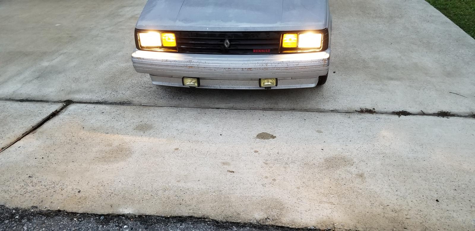

Strange things are occurring. I parked the car up last night on a clean piece of driveway, on a slight incline because it was raining and that was done in hope that the boot wouldn't leak.
Not sure about the boot but since it was parked up for a week the power steering has stopped leaking (it's full of fluid in the reservoir and still works properly), which is surprising. The two damp looking spots are where the wheels were overnight. There's a single drip from the back right of the engine (oil pump), another one from the front (oil filter), a couple little drips (reversing light switch, fifth gear switch) and a big blob of gearbox oil (unknown, requires investigation).
Why has it suddenly stopped leaking like a sieve? Still need to sort the drips from the gearbox though and check the level.
Phil

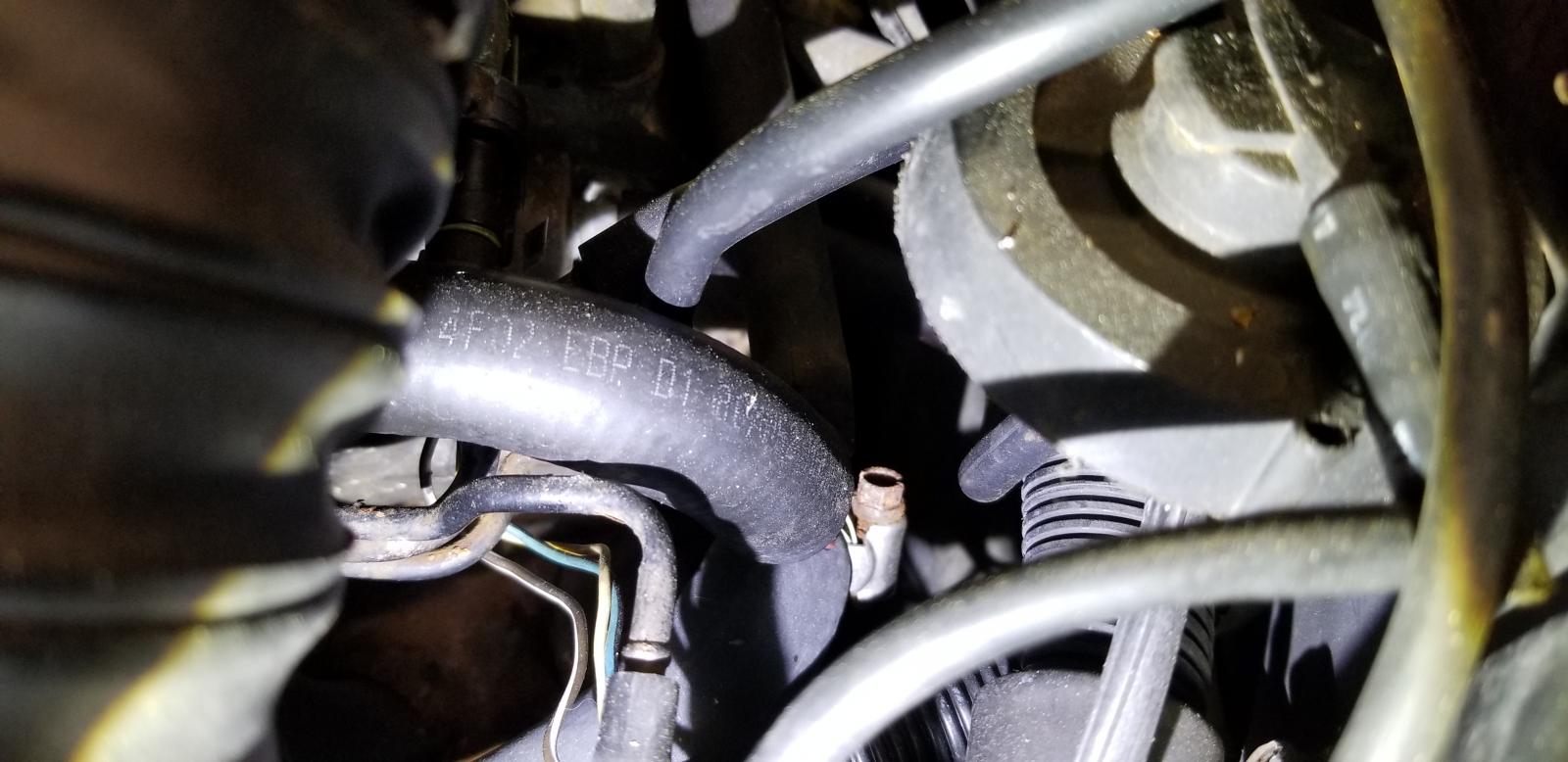

This morning was overcast and threatening to rain so I went to the garage.
Haven't started that since November. Gotta say fuel injection has some merits.
Found the source of the steam. The pipe that blew out today one year ago was weeping on the manifold.
Tightened up the jubilee clips. Hopefully that resolves the leak.
