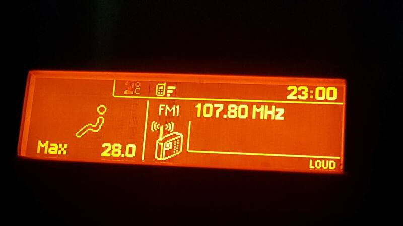

It might be temporary, but somehow the LCD screen seemed suddenly display properly, its usually all pixelated and fuzzy, I can barely read off it, but tonight, I don't know why, for first time its clear! I've ever seen it like this:

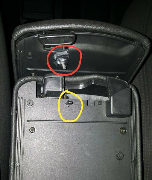

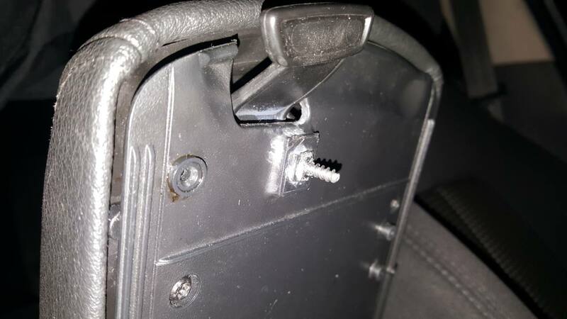

At the same time I'd received a centre console lid which turned out not to quite fit:
So I chucked a handy small bolt through the hole made in the old lid which turned out to fit well and helps close the lid properly but its just about easy enough to open too.

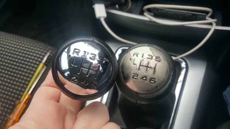

I also bought a replacement gear KNOB off eBay as the Peugeot one was worn (ooer etc... and so on...)
New vs old

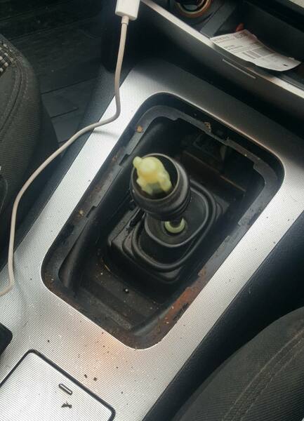

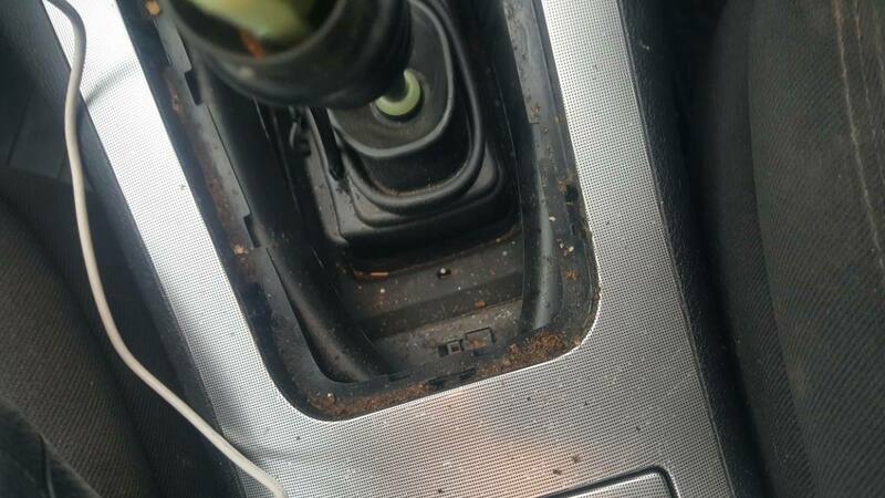

Out with gear stick surround.
A bit of strength and the old KNoB was pulled off (yeah yeah, pipe down yer dirty bastards...)
New kn0b on. And I didn't even need to visit the doctors.

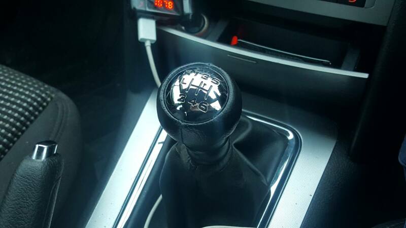

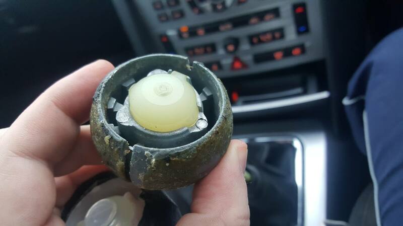

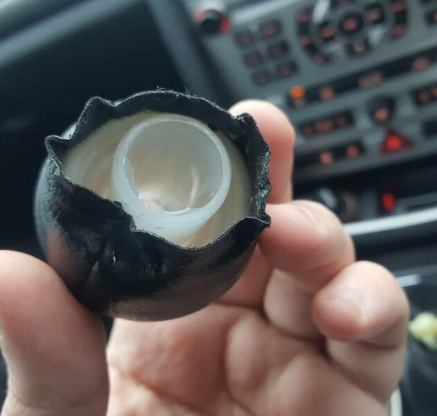

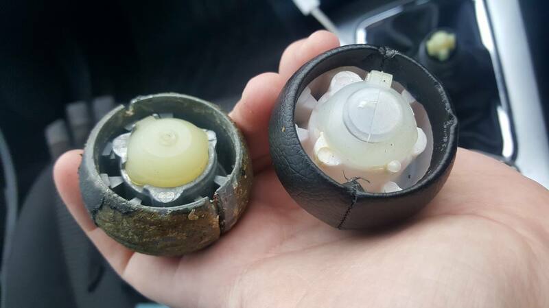

However I wasn't happy. The new kn*b felt very cheap and light-weighted. The original kn◇b was solid, had weight to it like a snooker ball and was made of some sort of solid metal material. The new one felt too light-weight and cheap. Plus when selecting reverse, the reverse selector ring under the kn○b (here we go again 😒) wouldn't disengage due to the poor design of the cheap kn•b.  Plus it was too easily  removed which just added to its cheapness.
So, looking at the original, it was quite basic design, a weighted metal ball with a layer of (now melted and peeling off) leather and the (now ruined) plastic gear selector sign vs the new one which was light cheap plastic ball with a layer of cheap leather around it and the plastic chrome sign on top.
Both were thus similar in construction so I decided to decontruct the cheaper one and transfer the finishings to the old weighted metal kn¤b thus renewing it.

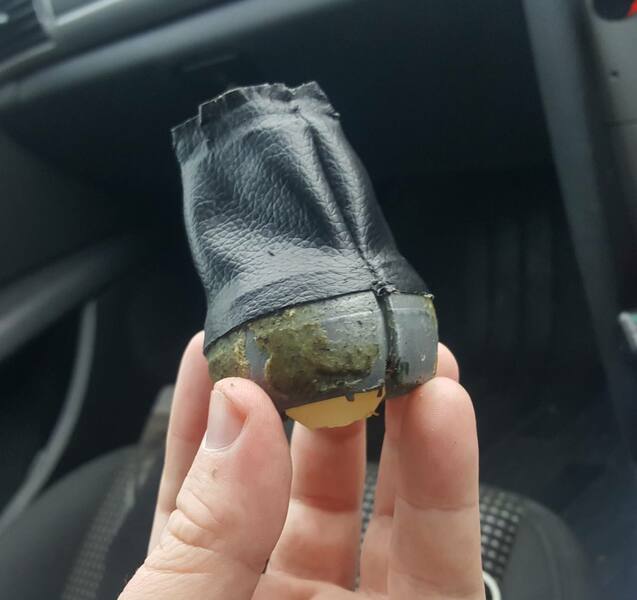

Old kn0b had its melted leather cut and peeled off:
I left most of the old glue on it as it packed it out to help keep the new surround stuck to it.
With the old kn_b, I popped off the chrome gear selector sign then very carefully slipped off the leather surround off new kn○b:

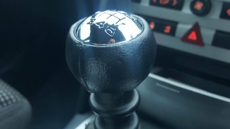

Then I fitted the new leather surround to old kn0b, it was a bit of a fiddly job but done carefully it didn't cause too much of an issue:
Then I had to tuck in leather surround on old knob, the top would be held in by the chrome gear sign and bottom bit had to be tucked in behind the surround for the reverse selector ring:
Fitted!
It's a lot better but the "leather" still feels a bit cheap and I can feel where the "leather" is tucked in underneath, but the reverse ring is now free to deselect with ease plus the weight of the kn&b is as it should be. It feels good...

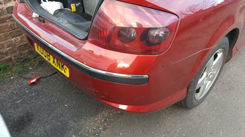

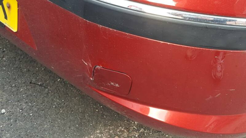

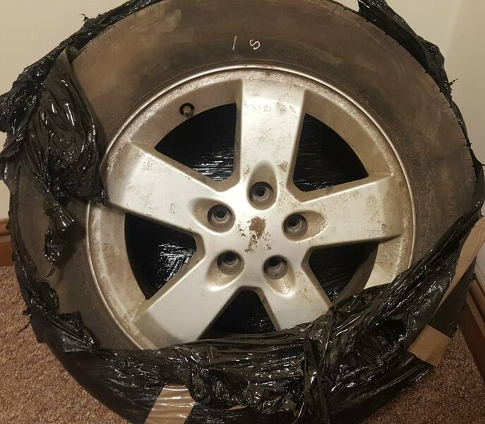

Last pay day I bought a bumper finishing trim and a wheel to replace the odd rear wheel.
The bumper tag was a bit of a faff. It was cheap for a reason. However, I managed to get it on and there (hopefully) it'll stay.

Today I set about changing the wheel. The garage where my other cars are stored borrowed me a jack and breaker bar because I don't have a jack and my breaker bar is stuck in one of my cars now behind 2 massive locked gates.
Whilst there it met it better, sportier half:
Off with the old:
And on with the new:

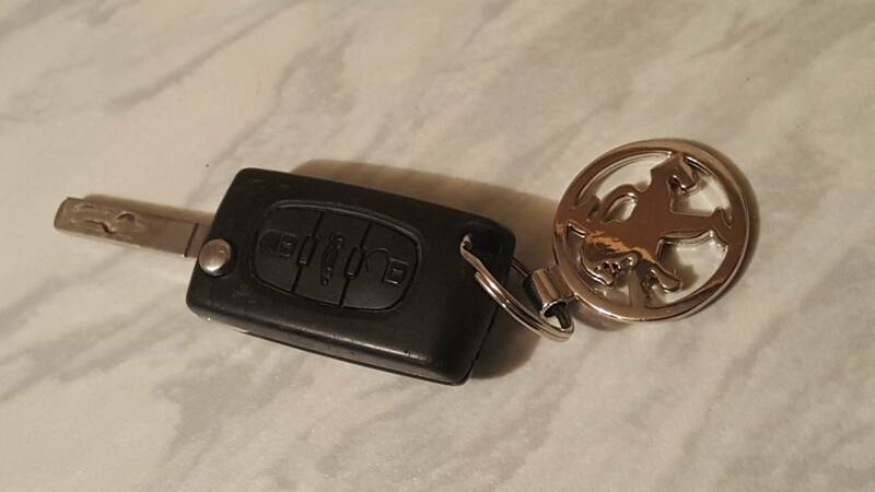

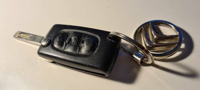

• Refurbish keys (still need a button selector for one key soldering on)

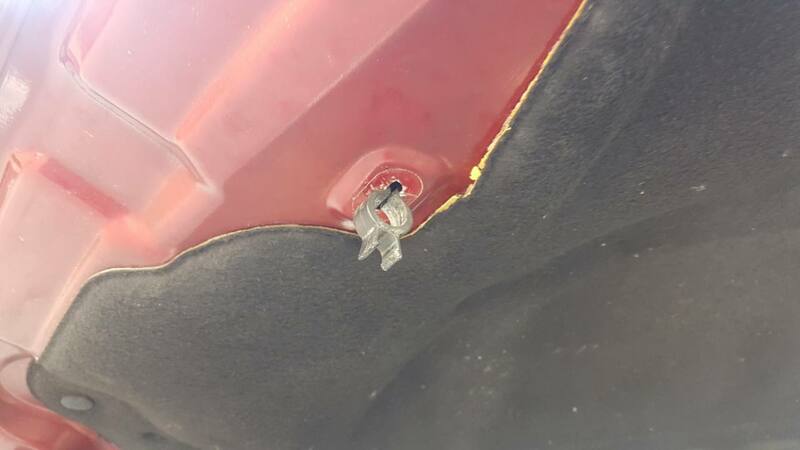

The under bonnet stay catch on the 407 basically broke off long before I had the car so lifting the bonnet would have the bonnet stay catching on a pipe or something so I needed to sort this out. I looked for one on eBay but no cigar.
So a rummage through some plastic bits and bobs I had, I found a couple bits that might be of use.
Off with the broken bonnet stay catch.
On with the bodge:
The new bodged bonnet stay catch is held in by the semi-circled flared-end that I squeezed into the hole where the original catch used to live.

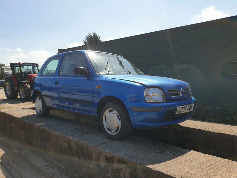

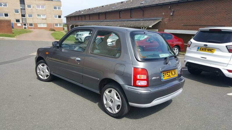

Whilst in the IoW I chucked some newer original wheel trims onto the roffle Micra as the white originals were looking a tad past it.
Before:
After:
Although the original white trims were OEM, the white paint was starting to really peel off.
The Micra barely gets used. When I saw it, it needed a good wash and the tyres re-inflating plus a good run which I gave it around the island.
It looks tidier than it actually is. The steel wheels are quite rusty and need changing at some point and some of the wheel arches need rubbing down and repainting. But as its Ma_Sterling's car now, I'll leave that up to her.

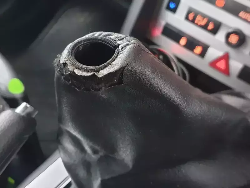

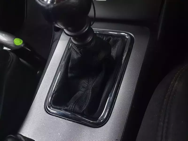

Gear gaiter:
Yeah, so after the KNOB (yeah yeah) debacle. The gear gaiter was still a tad tatty. I could feel it ay the top where the fake leather had ripped and dug into my finger when changing gear.
So a cheap eBay special (I really must learn) later and much difficulty of fitting, it finally got fitted and looks a bit better.
Old gaiter:
New gaiter:

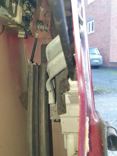

My drivers door squeaks from inside whenever I close the door or go over an bumpy road. This is annoying. I have some foamy-type packaging material that I've had for some years.
The squeaks come from the window rail mechanism that is bolted to the door, but because of its location, it is very difficult to track down the the source of the noise exactly so I can pack it out with foam material. Another job maybe for next year when I can be bothered with it again.

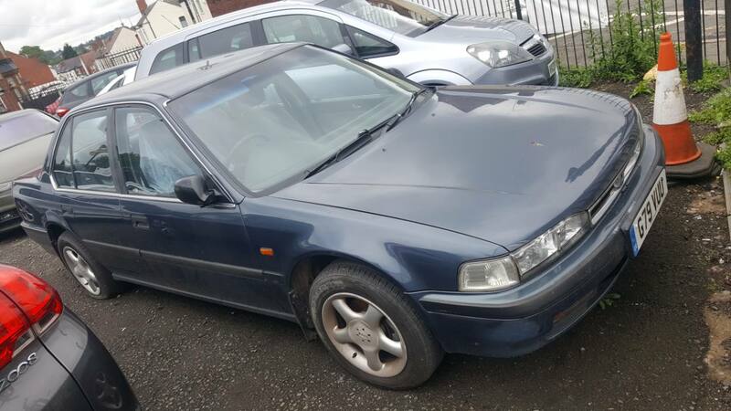

That Honda is still there I drive past it most days, do you know what the deal is with the yard further down the road on the same side?
He’s got some very interesting stuff in there
The Honda is owned by a regular customer, a big jolly chap with a beard who often driving about in a K11 Micra. I think it's there under some sort of "work on it when you have time" deal whilst also providing free storage.

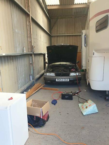

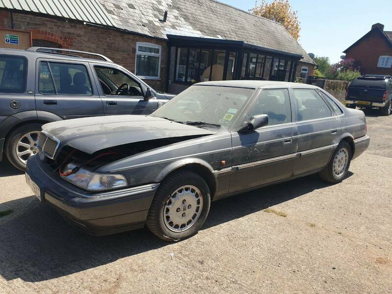

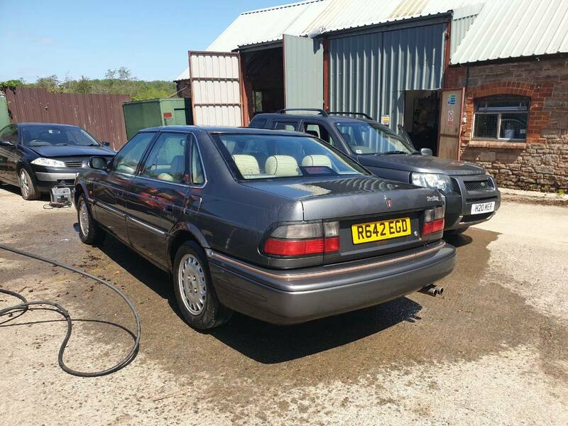

@fraser.innes.3 and myself agreed to give the KV6 Sterling's bonnet another tackle as it refused to open before
Somehow it had freed itself off before I could tackle it with a crowbar, and with the bonnet open we had access to try and start the thing.
We tried a jump pack but that didn't really work so a MASSIVE caravan battery was used as a jumped pack.
Initially the Rover tried to start and had a lot of cranking but wouldn't fire. I remembered that I had actually run out of fuel when I last drove it up to the yard it was last stored at and had to have pushed up the hill with my Peugeot.
So half a gallon of fuel later and some more cranking and the Sterling fired up from a long slumber.  It wasn't as steady as it would have been before but it was enough to keep it moving.

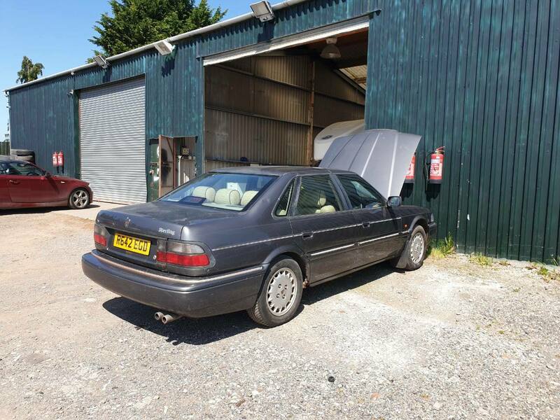

I popped it down the our mate Dave's unit as the jetwash was there, I gave the car a long overdue bath, enough to get most of the crud off it but not to my usual shiny polished standards.
it looks cleaner than it actually eventually dried off to be.
The car has got considerably rustier than when it was last in use. Outside storage hasn't been kind, so its a case of weighing up the options. The engine has had little work since I got it and has kept on going for me despite a holed radiator and cambelt roulette.
The Micra will be getting some attention innthe form of a service. I'm looking at having the back of jigged out because of the damage, Dave is quite enamored by the Micra as he used to service many of them way back when.
The interior has been cleared of the bonnet and bumper that lived in there for the best part of a couple of years.
The KV6 has its battery on charge, more petrol will be got to at least get it regularly running and moving.
Some work on a Rover finally. Bet you never thought that would happen.
As a side note, on the way back home, the Peugeot 407 decided to make use of the new screen to chuck up a warning with "depollution system faulty" error message leaving the engine light on. Meh, I rarely use the car so it probably needs a good run up and down the motorway.
