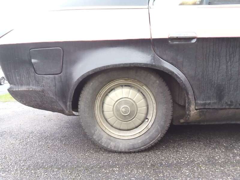

vulgalour Posted February 16 Author Posted February 16 Dirty Girl! The roads are still disgusting. This weekend was another trip to see mates and it seems like my health has finally turned a corner, the drive there and back didn't exhaust me and I feel fine today so that's a bit of a milestone. Another milestone was winding the Princess up to 60mph which might not sound much until you realise that's not on the motorway and instead on pothole and sodden, sometimes muddy, wiggly Lincolnshire roads. I wanted to see what the car was happy doing after the head rebuild and try and find its happy speed. That speed is still somewhere in the region of 55-57mph, that's where everything feels sort of balanced and happy and the point at which the wind noise is starting to increase and become annoying. I can say the car keeps a really steady temperature and has lost the intermittent stumble and hesitation now. I do think I could push to motorway speeds if I really wanted to and the car would do it except for one thing. I hit a pothole a little while ago that knocked my tracking off and I've had a quiet occasional knock from somewhere at the front too that until today I couldn't pin down. Above 55mph the handling feels a lot like I've got a worn tie rod and since I can't find any play or adverse wear anywhere I suspect when I hit the pothole it's also damaged a tie rod end and that's where the knock is coming from. I'll order a fresh pair and get the garage to fit that, the steering rack gaitors, and do the tracking all in one go. I've got about 100-120 miles on the car since rebuilding the top end and I feel much more confident in the car again now. Aforementioned garage job aside, next task is probably the welding work I want to get through, I've got the panels together, just don't want to dig into that until the van is MoT'd, just in case the welding work goes sideways on me. Welding is all cosmetic really, wheel arches, bit of a sill step, and a brace underneath the car that's trying to add as much lightness as possible. Needs a bath too, it's disgusting. JeeExEll, N Dentressangle, mercedade and 15 others 16 2
