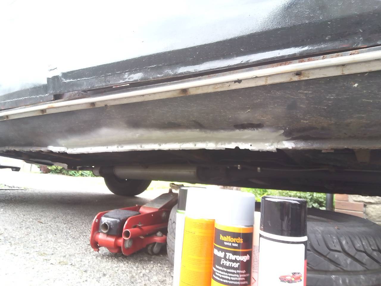

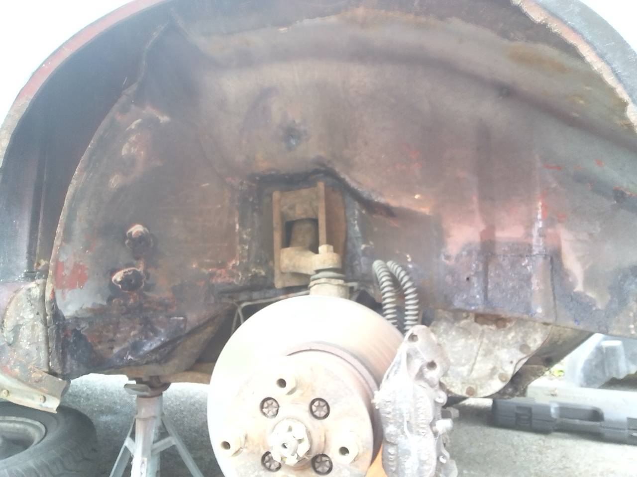

vulgalour Posted May 5, 2024 Author Posted May 5, 2024 Hey I did some photos for once so let's do an update on today's adventure. Recently I found a little hole in the floor under the pedals, I'm pretty sure this is down to my leaking windscreen seal and a big chunk of underseal that had fallen off on the outside of the car... and my general neglect while I was working on other cars before pressing the Princess back into daily duties. Got it up on an axle stand so I could pop the wheel off and clean up the area. I completely failed to get any before photos, I just wanted to get this job done. Working in footwells is not my idea of fun, nor is welding upside down on the drive. There had been a larger repair done to this area well before I got the car so that was done at least 12 years ago, probably nearer to 30 which is when the car was restored in the '90s. For the most part, that repair is holding up just fine so I left it alone, the issue is where water has been sitting inside the car from the leaking windscreen seal, and the missing underseal on the outside I didn't know about. Some chopping and grinding and rust treater later and it was no longer a hole nor was it rusty. Had a bit of an explore of the rest of the inner arch and found some flaking paint and surface rust, a couple of localised bits of rot that need welding up, and not much more than that. Picking battles again with this one, I only really had an afternoon available so decided to leave the welding that requires partial dismantling of the suspension alone for the time being. While I had the car in the air I went over the sill repair, caught any pinholes that appeared after grinding off the welds, and just gave things a general tidy. I've got a full outer sill to go on this side when I have time so I didn't go nuts. Inside wasn't too bad, bit blurry for the photo because it had got to that point in the job. This did end up being a much larger repair than I was expecting, there was a lot of overlapping panels and sealant going on here which I think had exacerbated things. Passenger side didn't have the same problem, although it was a bit damp from the recent downpours. I took out the foam sound proofing panels from the front of the car since they are definitely holding on to water, the red carpet barely holds on to any water at all so that can stay for now since I hate driving around with no carpets in the car. Annoyingly, it wasn't until after I had put all my tools away and was refitting the carpet that the light caught what turned out to be a tiny hole in the middle of the passenger floor pan so I'll have to come back and sort that out, it's so small you could probably drill it and fit a bung to repair it. A break to let things cool down and whatnot, flatting off of the repairs, and then a nice dose of primer and seam sealer on both sides to keep the weather out and the rust at bay. Actually ended up looking a lot better than I was expecting. Finished it all off with some top coat and a spritz of underseal, forgot to photograph that, and let the underseal cure a bit before letting it down off the jack. That's when the jacking point - which has always looked pretty mangled on this corner but never offered a problem - decided to make some awful crunching noises, try and push up through the floor and generally give me The Fear. Found another point to jack from and all was well so I could investigate. It looks like the seam between the jacking point and the inner sill has partially failed, hidden by a very thick layer of factory underseal. There's also been a repair to the floor over the jacking point which might have been me, I'm not sure, and that still looks perfectly sound. I'll have to pull the carpet back again and have a bit of an explore, it'll either just need a quick line of stitch weld or for the jacking point to be removed and straightened, the floor likewise, and the whole lot put back together again. There's no obvious holes or rust so it's a bit of an odd one. I'm tempted to take a few days off work since May is always super quiet and just do as much welding as I can to deal with all these niggly little bits in one go before work gets busy again. We shall see. For now I'm just happy the big hole in the floor is now a big steel patch. RayMK, GrumpiusMaximus, worldofceri and 10 others 13
