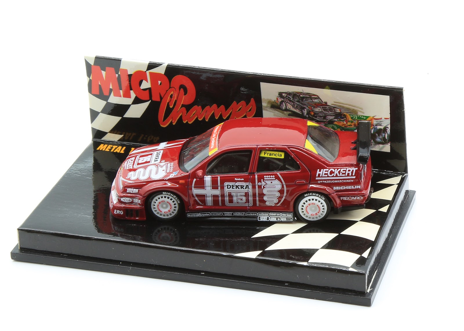

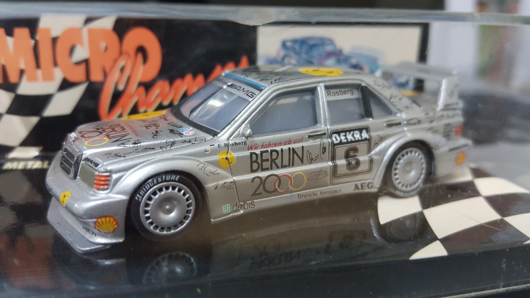

30 years ago Minichamps had a range called Microchamps in 1/64 and they were pretty much ignored and can be found quite cheaply. As usual with Minichamps the detail was excellent, but they only released DTM cars and F1 cars. They only lasted a few years before being dropped.
Alfa+Romeo+155+V6+Ti+1993+G.+Francia+2.J
164_microchamps_mercedes_benz_190e_evo2_

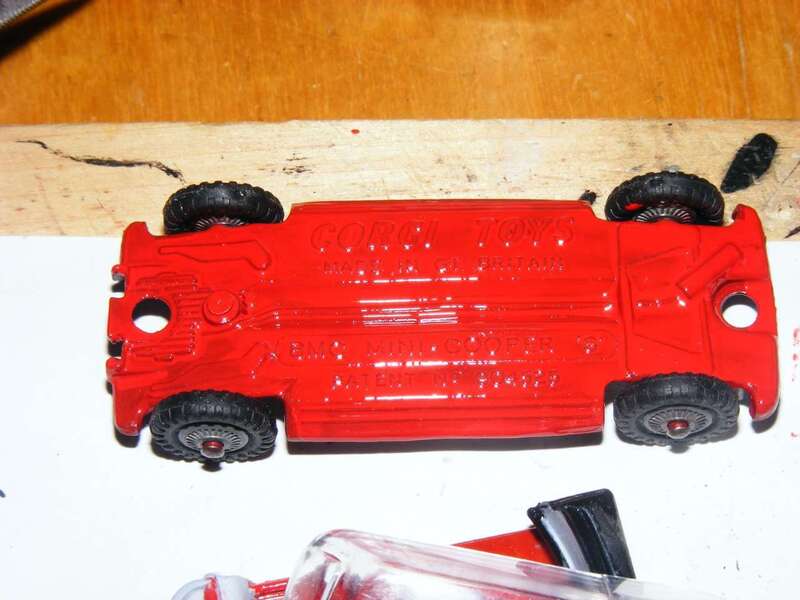

Here is the base of the car.
Before stripping
Stripped using Nitromors and wire brush
First coat applied directly to bare metal.
Second coat applied a week later
If I had used a matte white or red for the first coat I would probably have gotten a better more even coat to the red.

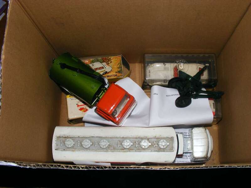

As mentioned earlier I did a bit of interweb bidding on a local auction. I bid on a few lots but was only successful on one of them as I'm still purging more than buying.

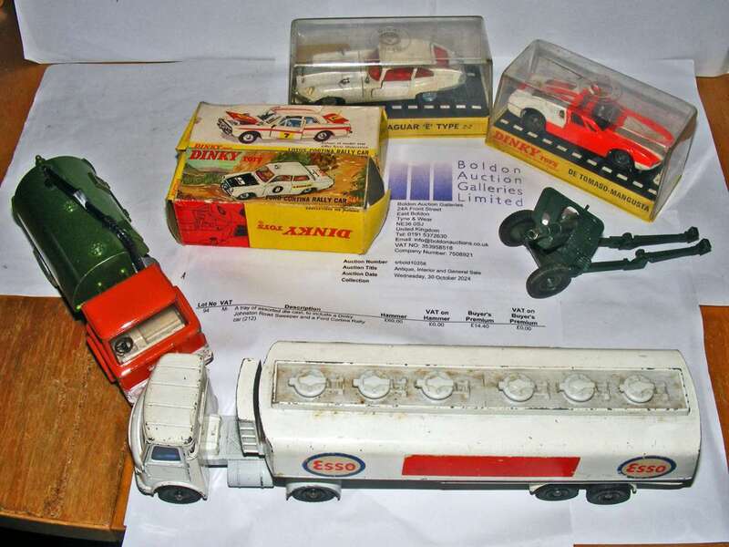

So what's in the box that I bid £60 on this morning?
Well there's 7 items and a receipt for £77, that commission has to be watched when bidding, hence why I did not buy all the lots I bid on.

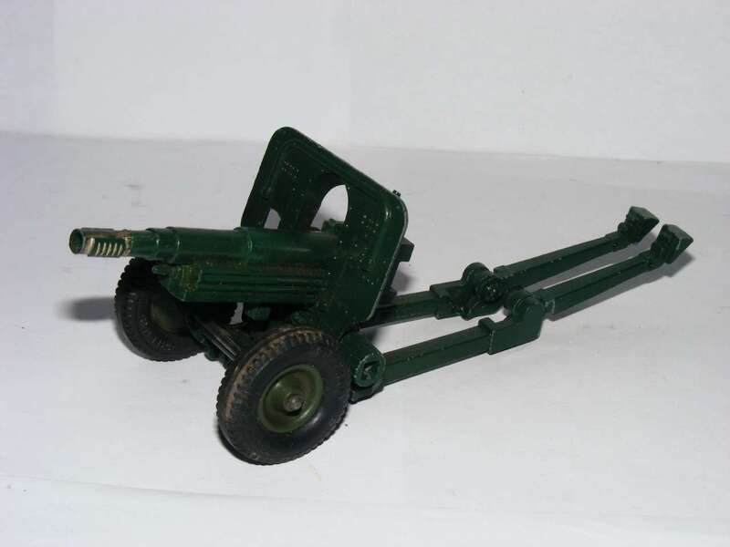

Most dullest thing is the field gun
Nice big AEC ESSO Tanker

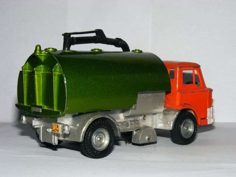

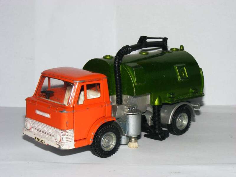

A Johnston Road Sweeper just like the one I had 50 years ago.
The Tomato Mangusta, again I had one of these along with the Corgi version with the removable chassis.
Another plastic boxed model, this time a Jaaaaaag E-Type 2+2
And finally the two that I bought it for
Mk1 Rally Cortina
and Mk2 Rally Cortina.
I'll be given them all a good careful clean during the week and will post more detailed shots once cleaned.
