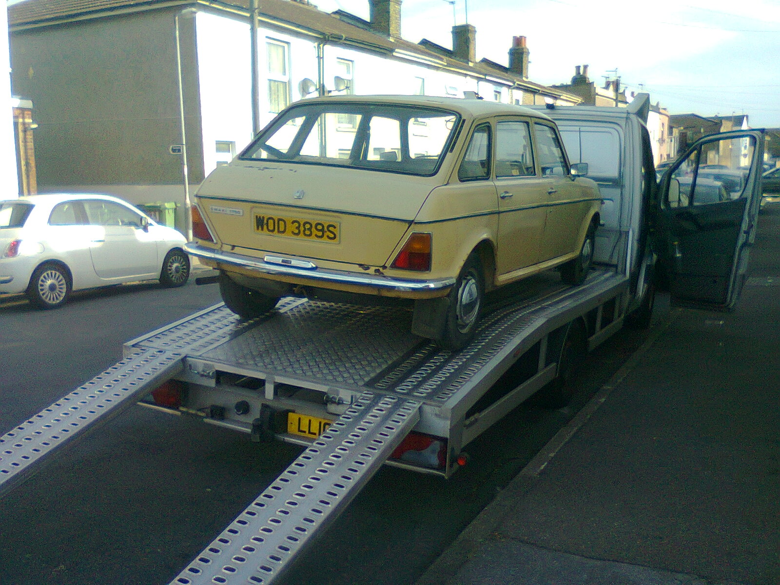

Just in case anyone wondered; it ended up Sandglow. ;)
Here it is on it's way to the Isle of Wight!
