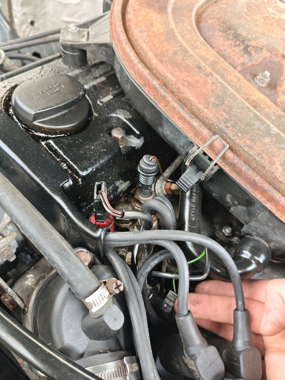

Just had a look at this. I have two single pin sensors at the front of the cylinder head to the right hand side of the oil filler cap.
Messed around with the top one first and earthing that affected the idle so is presumably linked to the Bosch system.
Then spotted the bottom one where my finger is.
Looks like a duff sensor then. Autodoc should stock them.
I'm assuming yours is running KE Jet? The other sensor will control the mixture via the ECU and the Actuator on the fuel distributor. Hence why it affected the idle when earthed.

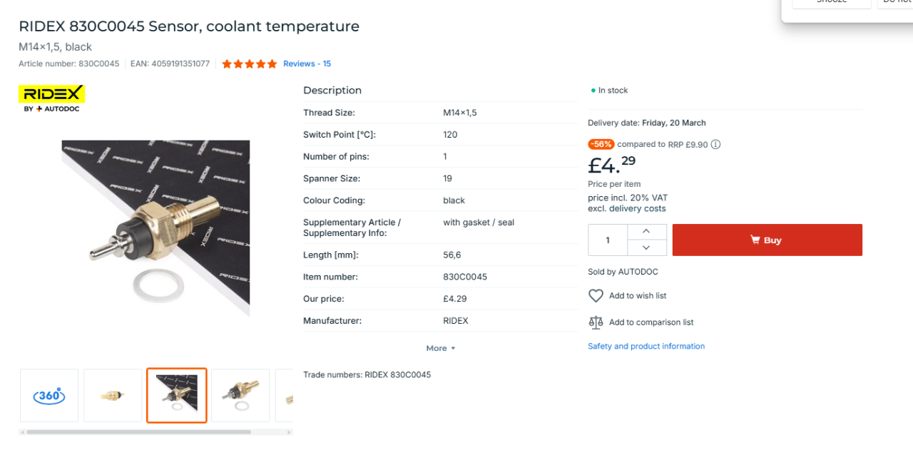

The new sensor finally arrived yesterday, so I eagerly fitted it this morning. Flicking the key brought the needle to life. Promising...
But a 15 minute drive later and it was still pointing at 40.
Testing the old sensor for resistance doesn't give a reading, so I'm fairly sure it was faulty.
Testing the new sensor after a short drive gives a reading of 900ish ohms, which seems correct. From what I can gather the sensor should read around 2k ohms when cold, 0.3k ohms hot.
Slightly stumped as to why I'm not getting a reading on the dash. Bridging the sensor to ground still has the gauge reading full.
Maybe I've introduced an air lock when I removed the old sensor?

Grounding the sensor wire sends the dash to full mast and confirms that everything is work from the sensor plug to the cluster.
The replacement febi sensor is reading 300 ohms warm, 3k ohms cold. That seems to check out with specs in the Haynes manual.
Bit confused to be honest!

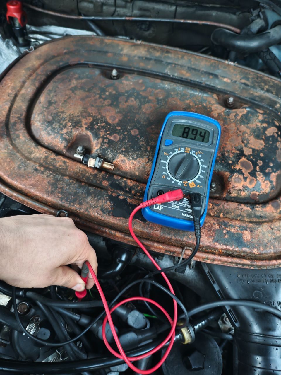

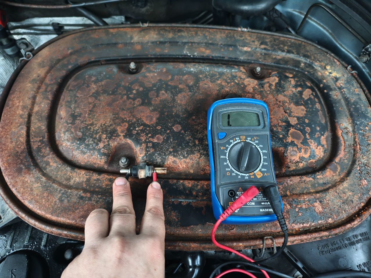

I've just compared the resistance values between the dash sensor and the fuel injection sensor. Both were within 60 ohms. Maybe the two actually have different resistance parameters although they look identical? It would explain the Haynes manual being correct for the fuel injection side.

My KEJet temp sensor for the ECU is a four pin one, rather than a single pin. As mine doesn't have a CAT/Lambda my injection system relies on that reading to adjust the fueling as it warms up. I had many online 'discussions' with other S Class owners about this. As it seems the non-cat cars with KEJet are pretty rare. As mentioned most internet advice* comes from US owners where they all KEJet are Cat equipped over there. They use a combination of the readings from the temp sensor and the lambda probe to create the signal to vary the fueling.
Did you test yours off the car? I'm assuming that I can test across the body (where the spanner goes, as that's all one casting - across to the pin) to get the running resistance, whilst being able to see the temp on the gauge in real time.
I've got a multimeter in the car, so I'll test it when I get back the station after work, it'll be flat cold as it's been stood since 7am.
I don't think you'll be able to test and see the gauge at the same time. I just remove the plug and test between the end of the sensor and any earthed point. The spanner flats on the sensor work. As does the intake manifold etc.
