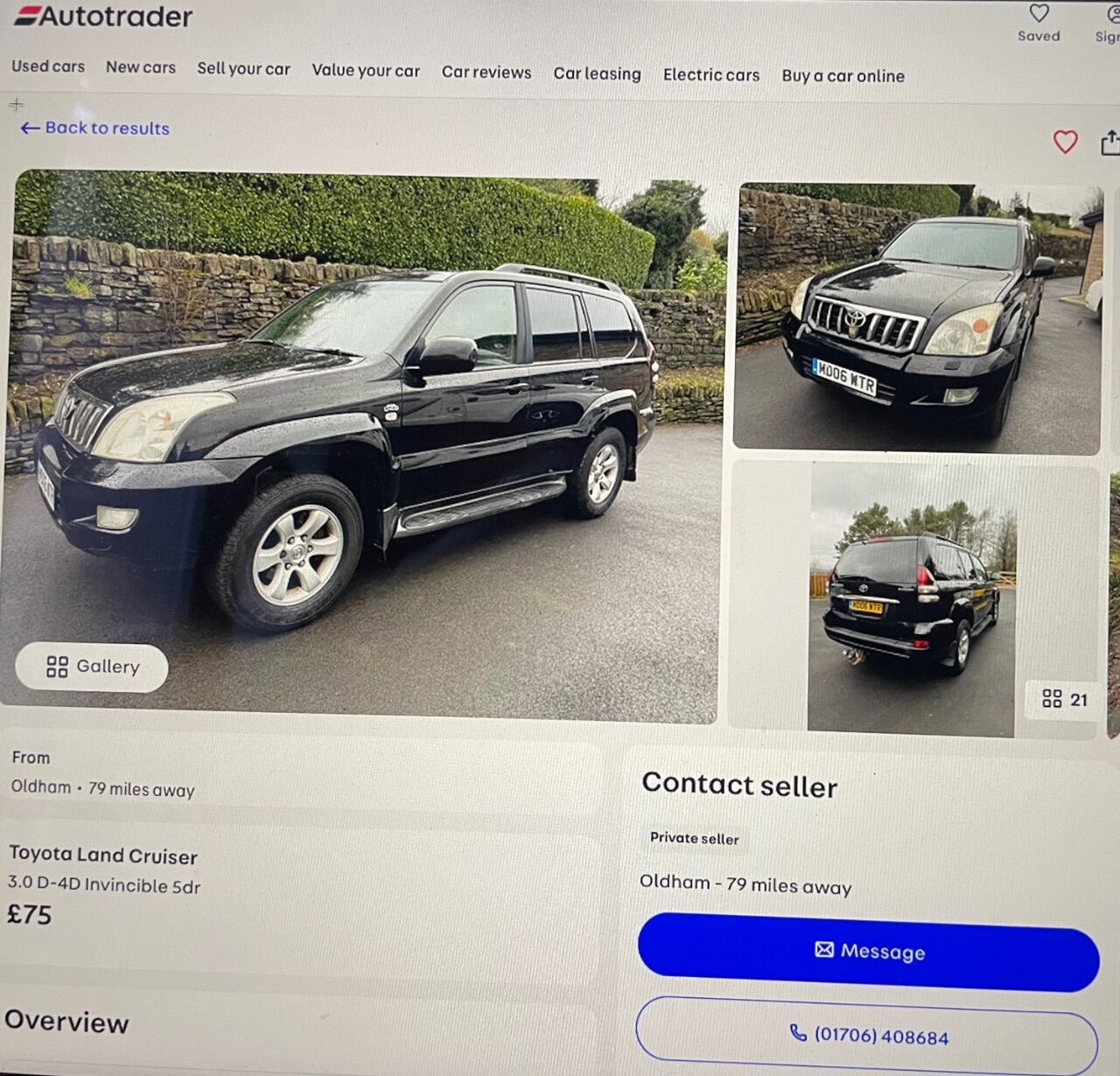

Someone is taking the piss out of me.
Thought I’d have a gander at AutoTrader. Set the parameters and this is the first car that turns up.
Ive only ever had two cars that shat their wipers the day I bought them. And it turns up when I go to look at replacements for this!
I want to make it up, honestly.
Would you own it again?

I think if I were to look for one again I'd know exactly what I'd be looking for and going for. But those same things would cause me sleepless nights really so no. I wouldn't own those Land Cruisers again.
I still want, and will get, a Toyota Land Cruiser Amazon one day. But as a project. So I know it's already fucked before I attempt it.
