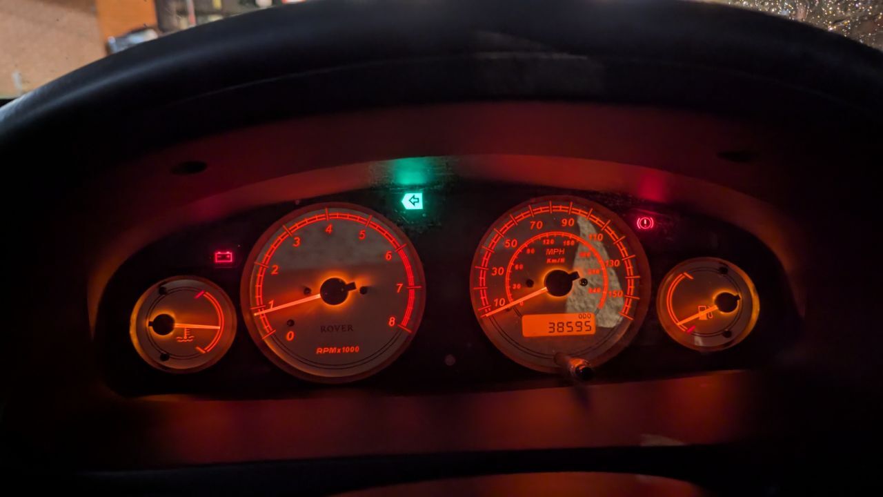

RoverFolkUs Posted January 15 Author Posted January 15 Well this car really knows how to twist the knife 😂 Treated it to a windscreen chip repair on Tuesday, this evening it decides to stall/cut out as I put the clutch down to change gear, then upon restarting I had a battery light in my face 😃 So it's eaten it's alternator. Wonderful Rust Collector, IronStar, grogee and 1 other 4

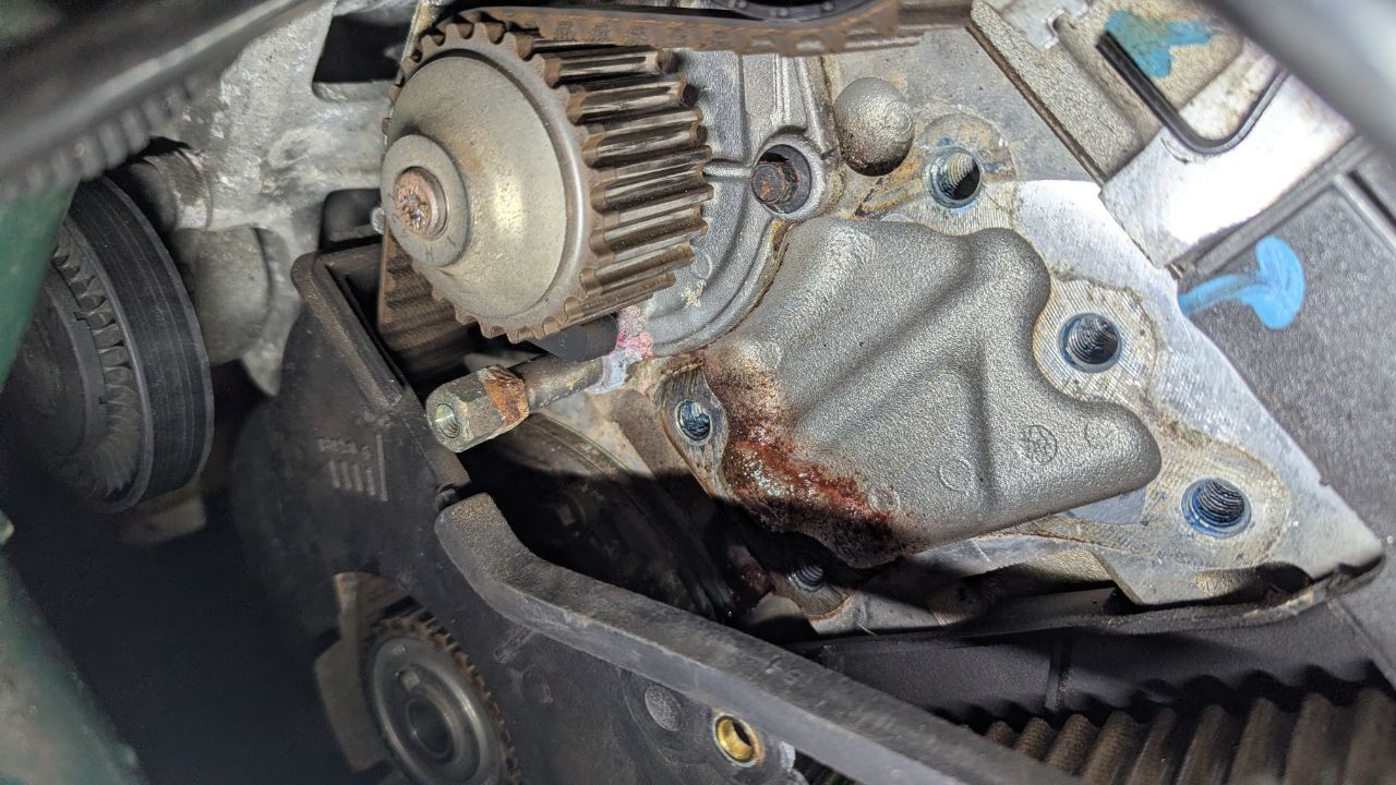

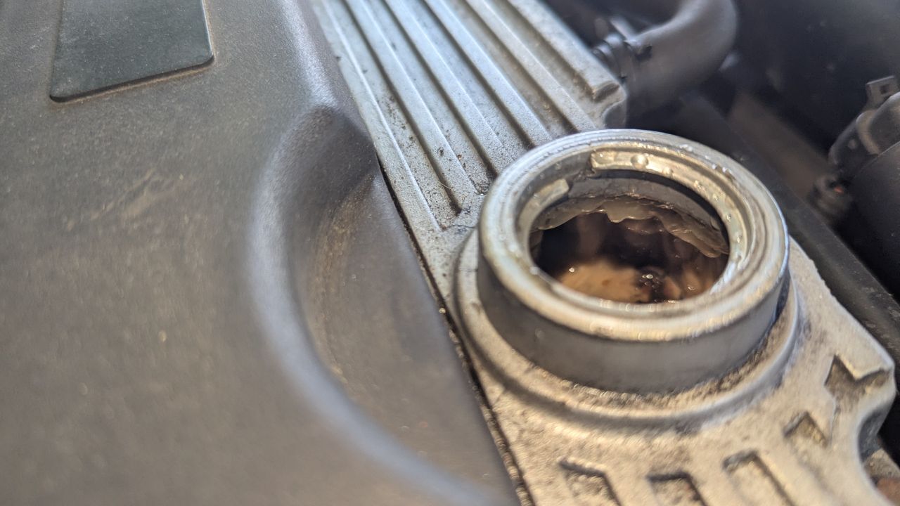

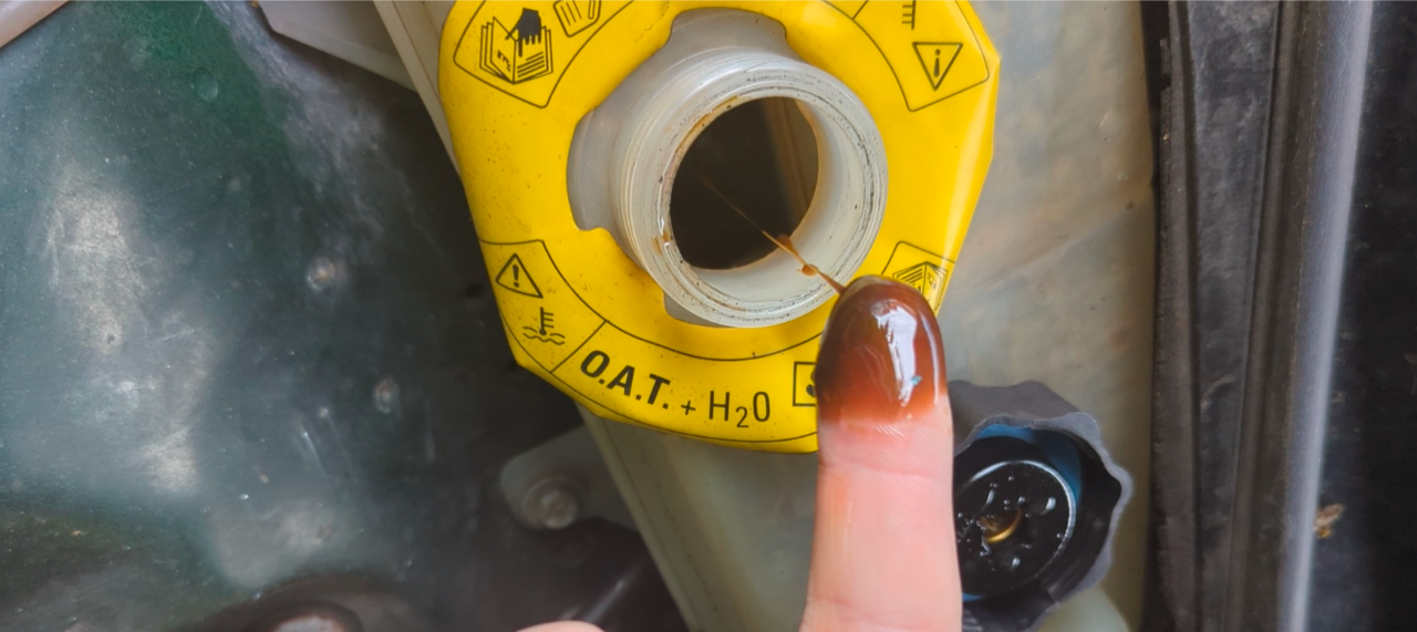

RoverFolkUs Posted January 16 Author Posted January 16 Pulled the timing covers and front pulley off, found a pool of coolant behind the engine mount bracket. Presumably it's hiding in there and evaporating without a trace. That explains where it's going then! Sadly it looks like OMGHGF is setting in anyway. There's some scummy oily residue in the expansion tank building up and I looked under the oil cap and there's a pretty horrific amount of mayo under there. At least it's oil and water mixing HGF instead of overheating etc... Not decided on what to do just yet. I removed the alternator and took the voltage regulator off to find the brushes fairly worn, but there was still a bit on them. I don't think I've got any other option than to fix it. It's only worth scrap to anyone with head gasket symptoms 🤷♂️ I debated getting just a new voltage regulator for about £25 but it seems to be Chineseium, the next option is a Bosch one for £45 but then I've found a brand new Bosch alternator for £85 so as much as I'd like to repair it I think it would be a false economy. Still disappointing, but what else can I do 😅 Rust Collector, Brigsy and Matty 2 1

RoverFolkUs Posted May 5 Author Posted May 5 Been a while since I've updated this one In the end I bought and fitted the new Bosch alternator. And promptly shoved the old one in the loft telling myself I'll rebuild it as a spare one day 😂 I've not done much else to the car, it proved itself very useful and capacious when I had to transport my tools thanks to a career change Sadly someone reversed into the rear bumper (at low speed) last month which scuffed the paint and cracked the chrome trim - but this won't be a difficult fix and it's low down on the priorities right now. I've already managed to source a replacement chrome trim, which proved more difficult than I originally thought 😅 Now, elephant in the room. OMGHGF? Well, it's always been losing a little bit of coolant which I discovered was caused by the water pump. However I was also noticing a "scum line" in the coolant tank. Therefore, before doing a cambelt and water pump I wanted to be sure it didn't also need a head gasket otherwise I'd end up doing the same job twice. I've been driving the car around locally to monitor it, it has never once overheated, which is good, but with regular coolant top-ups and a bit of usage, it has confirmed.... Yep, definitely OMGHGF! Since it's not boiling up, I'm happy the liners should be ok and it should be a fairly straightforward repair. Coming soon then will be a head gasket replacement on this. I'm hoping to crack on with it later this month Rust Collector, Brigsy, High Jetter and 2 others 5
