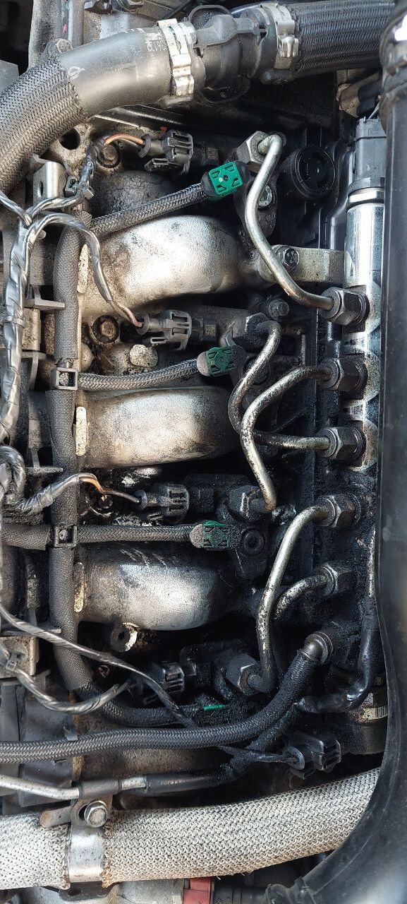

One thing I picked up on almost  as soon as I collected it was a smell of fumes in the cabin.
Hmm, this looks a bit sooty under the engine cover.
Injector 3 and 4 looking the likely suspects,  I sprayed a load of brake cleaner around the injectors to see which one is letting by.
You can just make out the vapour around no.3 injector.
I've started cleaning up and have new injector washers on order.
I've also a rear droplink to solve the rattle from the back end.
Was going to say before reading the rest of the post, it looks to me like Injector 3, which is absolutely caked with soot. Injector 4 only really has it on the side nearest 3, which gives the impression it's just getting the crap coming off 3. As does the pipe in between them a little further back, the soot is all concentrated on 3's side, which strongly suggests as well that 4 is probably 'ok' and not even leaking on that side of 4, given that side of the middle pipe is the cleanest bit of the lot and would be in the firing line of 4 if it was leaking, again pointing to it all being from 3.

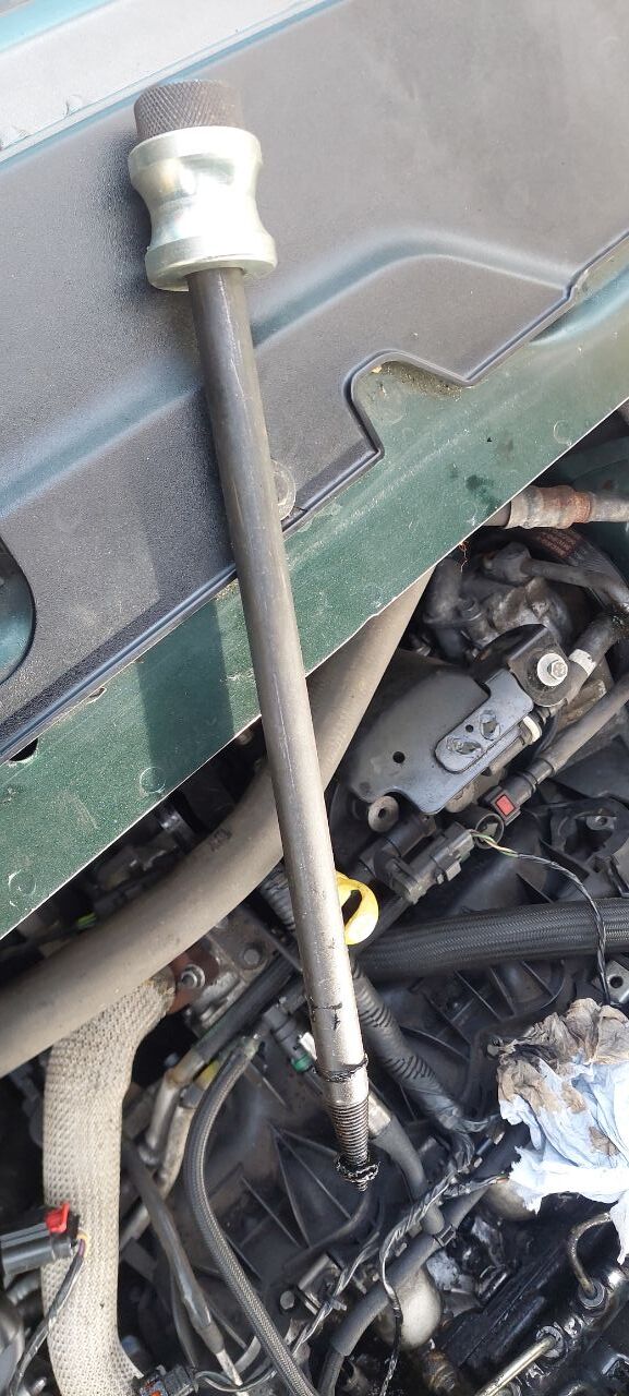

The injector was stuck fast so I bought an injector slide hammer.  It was still stuck fast but I found just a brief soak in this was enough to soften the black muck in order for me to slide hammer the bastard out.
I shall have to give the injector a good clean up, here it is on the slide hammer.
The washer got the same treatment on a smaller scale.  I'm off to work shortly so the cleanup will have to wait.  I'm out again tomorrow trying to extract a starter motor from my friend Paul's Renault Master van.  What a cock end of a job that is turning into.
