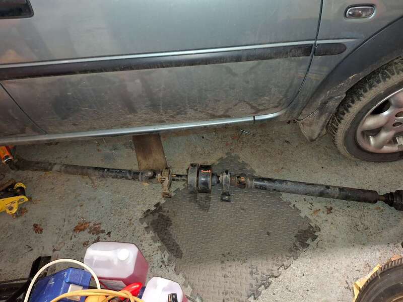

It has a couple of issues firstly the rear brakes occasionally stick on, mostly after the car has been through flood water... Second issue is a bearing noise droning under the car.
After doing doing a bit of research, I think I found the culprits for each issue. The general consensus with the sticking brakes is that its always the brake shoes, cheap after market ones have a habit of sticking to the drums, so I replaced the shoes. The brakes seem okay so fingers crossed I have fixed that issue....
All looks pretty normal...
On to the second issue, initially I thought it was a wheel bearing. I jacked each end of the car up and spun the wheels by hand but they all sounded okay? Hmm is it the prop? After doing a bit more digging and watching a furious driving video, I came to the conclusion it could well be one of the 2 prop center bearings...
Anyway out with the prop.... And mark it up so I can line it back up after I split it....
I span the bearings by hand once the prop was off and the front one did sound pretty rough. They both looked ancient so I replaced them both.
The old ones did not want to come off, they came apart in bits....
Putting the new ones on was a bit of a faff, especially the little protective collars. I actually managed to jam one of the new bearings against a collar before figuring out what I had done. Anyway after a bit of fight it all came back together.
Test drive now carried out- all now okay, noise gone so I can go and do some more on roading!
