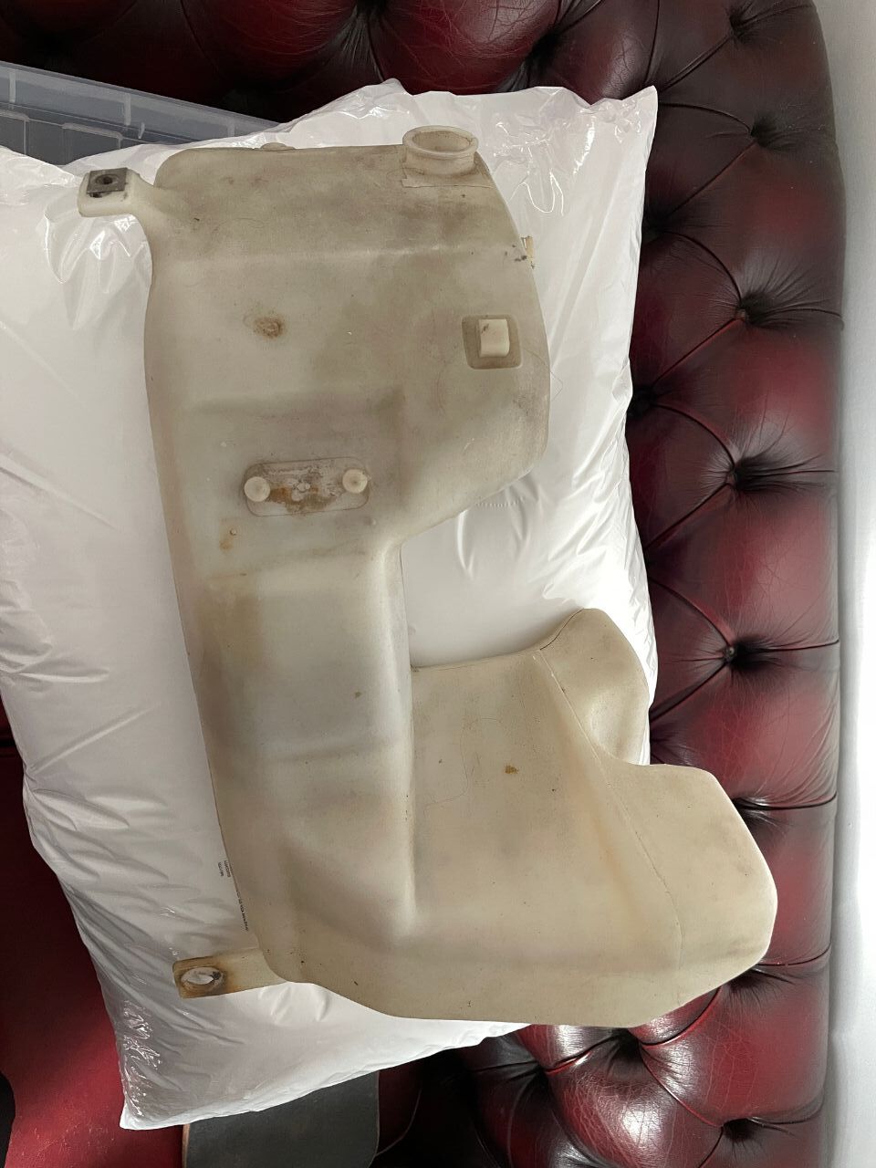

One of the lugs on the screenwash bottle has broken at some point in the past. It had been 'fixed' with a cable tie and some wire, so it was hanging loosely and mostly resting on the headlamp motor and relay:
Because this is a very high performance Porsche automobile, this kind of approach can't be tolerated. Only the finest materials and engineering are appropriate.
Bearing this in mind, I made a small plate with some aluminium sheet left over from the old Aga flue, drilled it and used a couple of self tappers to attach it to what remains of the lug. I even gave it a quick coat of paint, although it slides under the wing flange and is mostly hidden:
Job jobbed.
