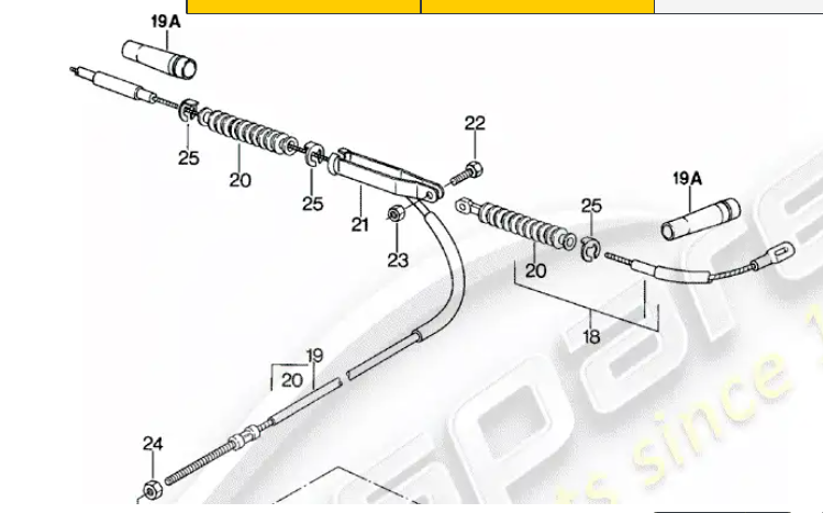

N Dentressangle Posted August 23 Author Posted August 23 As well as the long handbrake cable, I think I also need two guide tubes, number 19A in this diagram: Looks like they're available under p/n 92442452400, at Porsche prices. Wonder what the VW equivalent is?

tooSavvy Posted August 23 Posted August 23 Cheaper.... 🤔 PART 92442452400 | PORSCHE GUIDE TUBE | EUROSPARES https://share.google/NokyQKaE5uJjoxxnh 🚙💨 N Dentressangle 1

N Dentressangle Posted August 24 Author Posted August 24 Ta - I've joined the owners' club, so will see what advice and discounts can be had. On another note, it seems the guide tubes I need are a bit weird. It looks like they bolt on, rather than just being a slide-in tube. Here is what my backplate looks like: and here's the backplate of another car someone's breaking in the US, showing the guide tube bolted in using the bolt you can see below the handbrake cable in my pic above: Never simple, is it? 🤣 The other missing bit appears to be the entire rear anti-roll bar assembly and brackets. I did wonder why the back end felt a bit wayward on the journey back. See if you agree: I reckon this was taken off and put to one side when someone at some point in the past began to replace the long handbrake cable. Sadly it didn't come with the car. I'm hoping I can turn up a decent s/h one off the 924 forum once I have access to it, including all the brackets, drop links etc. Let's see... Coprolalia, JMotor, Matty and 1 other 4
