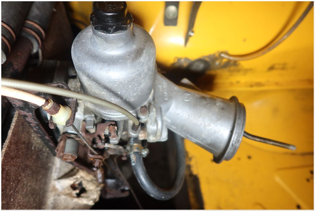

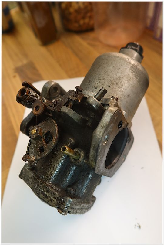

Burlen has now got back to me, and yes, their carb refurb service will be happy to sort out my carb.
Turnaround time is 14  weeks (FOURTEEN WEEKS!) and the price is £500 (FIVE HUNDRED POUNDS!)
For £500 I'd want 24 hour service and a gold-plated dashpot.
Incidentally, Burlen will chrome-plate my dashpot - at extra cost. All the carb refurbishers seem to offer a make-it-shiny option, which is presumably aimed at all those MGB owners who you see at shows, with their blinged-up cars with all the Traditional Classic Car Owner accessories added (headlamp peaks, wood veneer dashboards, those little Union Jack badges rivetted to the wings, a picnic basket which nobody has ever opened on the seat...)
I've got a Sherpa. I don't do bling. And I certainly don't do £500 for a carb job.
So, lets have a look at the DIY option...
There's lots of bumph online about HS2 and HS4 carbs, as used on Minis and MGBs, but relatively little about other variants. My Sherpa has an HIF6, which seems to be quite rare as a single carb. The HIF6 was used in twin-carb form on the Rover V8, and you'd think that was the only engine that ever used it. Rebuild kits for the HIF6 are available - but only, it seems, for twin carbs, so you get two of everything.
A twin carb HIF6 kit can be bought for around £100 (but this doesn't include needles). I suppose having two of everything would be useful when I inevitably drop the fiddly bits on the floor and lose them.
I could soak my carb in a bucket of cleaning fluid, like this stuff, and scrub off the gunge on the outside (presumably the gunge on the inside would just be lifted off by the cleaning fluid). I suspect the rusted-up idle adjustment screw might be a problem, but I'll assume I'll be able to free it off using standard methods. I couldn't really attempt tricky stuff like reaming out new bushes - assuming that's necessary, which it may not be, but how do I tell? Why do the bushes need to be reamed anyway? Shouldn't they be the right size, straight out of the box?
I could do a fairly basic clean-up job without too much trouble, and maybe that's all it needs.
Then again, I could buy two ready-refurbished HIF6 carbs for not that much more than Burlen would charge for doing one. It seems nobody sells just one HIF6 - they're only available in pairs, because everyone's got a V8, right?
OK, I've made a decision. I'll buy some cleaning fluid. And a bucket.

Just soak it in petrol?   Free everything off and it will probably work.  They have to be very badly worn before they won't.
  • Agree 3
The reaming is to ensure the two bushes (located opposite each other) are exactly in line [.. the spindle holes]
IIRC PTFE plastic bushings are available [squidgy but won't crimp butterfly spindle] and are airtight/no idle leaks 🔧✔️
Centring the needle into the jet orifice is important for smooth operation and it will reduce any tendency of the piston to stick in the bell... Some thin valve lapping paste blobbed onto the rim of the piston and spun/zigzaged up and down will ensure no crusty gritty blemishes inside the bell [RINSE thoroughly 🤣]
Much debate on S.U. dashpot oil.... My MM1000 flew with 3-in-1 (... just sayin, lyke 😁)
Bon chance M9
  • Agree 1
You can also do the drop test to check for wear between the piston and the bell. Seal the (transfer?) holes in the piston, take the needle out, put the piston in the bell and hold upside down over a soft landing. If it takes 7 seconds or over to drop then the wear between the piston and its housing is within acceptable levels.
HS6s are readily available for cheap. Inch and 3/4 like a HIF6 but seperate float bowl. @Mr Pastry will know if its possible to fit one on an O series but id imagine its a ballache.
Yes you can use HS6 instead of HIF6, but basically,  the HIF6 is regarded as an improved HS6 , doubtful you would you see any degradation in performance in this appliocation 🤔
  • Thanks 2
It's an SU, not a nuclear reactor !
Take the top and bottom off, give everything a good clean with carb spray and a rag, try not to bend the needle. Then put it back together and test the car. Chances are, it will be fine and you won't need to bother with a service kit etc.

And if it works, leave the bloody thing alone!   The worst thing BMC ever did was to publish SU tuning instructions in the drivers' handbooks, so everyone down the pub instantly became an expert and applied the magic screwdriver when it wasn't even necessary.   And that is how SUs got a reputation for "going out of tune."  No they don't.

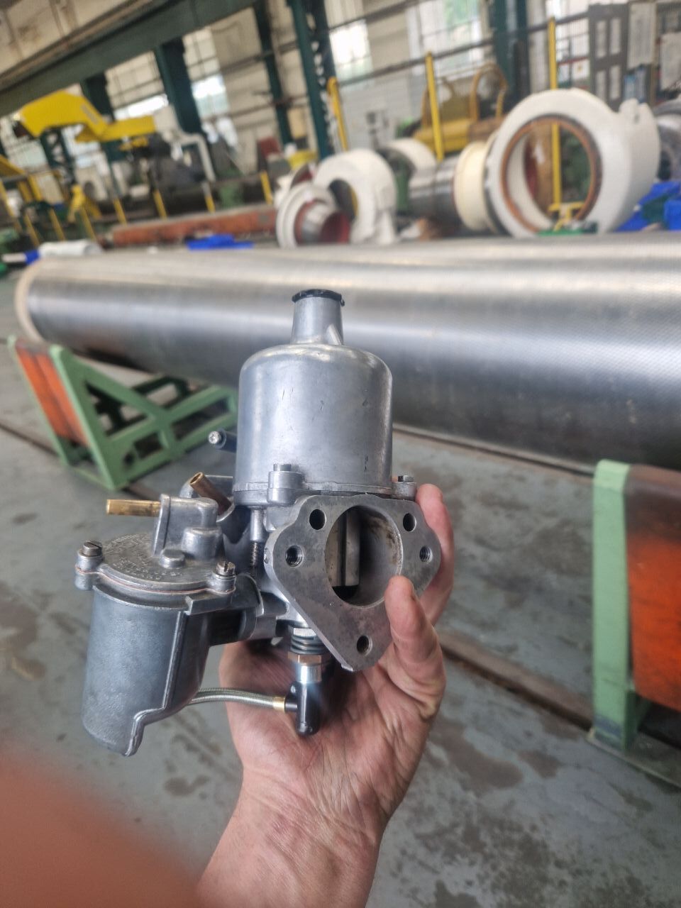

I sorted the carb from my escort using a £40 gasket kit of eBay and a good clean, take loads of pictures for reference, take your time and you’ll be fine- I figured no matter what I did I couldn’t make it run any worse than it was
Nuclear reactor service items
Moss should be able to sell you individual HIF6 spares (for the mighty MGB V8 !)  should work out cheaper  than a complete rebuild kit - the HIF4 on MGB GT are pretty good - as @Sigmund Fraud all I did was replace the float bowl seal - worth having a look to check for crap etc  - I did bung mine in my cheap sonic cleaner, but a bucket with petrol should be good enough (No Smoking ....)
@Somerset Suffolk.. "but a bucket with petrol should be good enough (No Smoking ....)"
Smoking + petrol in bucket = enough Nuclear for Iran! 🤣

@Heavyspanners a man of your calibre will find an SU carb refurb a walk in the park.
I did my motorbike one, not an SU but smaller and fiddlier, it's pretty easy.
The harder part is getting it set up afterwards, maybe Gunson Colour Tune could help to get it in right ball park? Or get friendly with your MoT tester so you can use his gas sniffer.
@grogee.. "The harder part is getting it set up afterwards, maybe Gunson Colour Tune could help to get it in right ball park? Or get friendly with your MoT tester so you can use his gas sniffer".
Very old-skool tuner/mech offered advice when I rebuilt my MM1000 SU.... he showed me how to lift the piston a *little, when running, with a skinny long screwdriver and to tell the change in revs = good/bad.
I had read up (in our AA Book of the Car) about SU setting up... and reference to the 'lift pin' >> for lifting the piston ✔️
I confidently advised he should use said pin... 😵...
"Screwdriver does fine FOR ME! 🧐"
...... lesson learned..... 🤣🤣
IIRC when new, the HIF had the mixture adjustment set and sealed with a pressed-in plug, and "normally" no adjustment would be required.   It is a small adjusting screw, not a large brass nut as on the earlier carbs.  This was at the beginning of emissions regulations and was designed so you could not set it too rich.  If the plug  is still in place, leave it, the mixture is probably OK.
Except @Heavyspanners can only get it to run with the choke pulled right out...
Admittedly this could be due to a manifold air leak but I'd imagine the carb is out of whack somewhere.
it could also be dodgy fuel, if its old and gone off you need more to make it run and hence thr choke out.

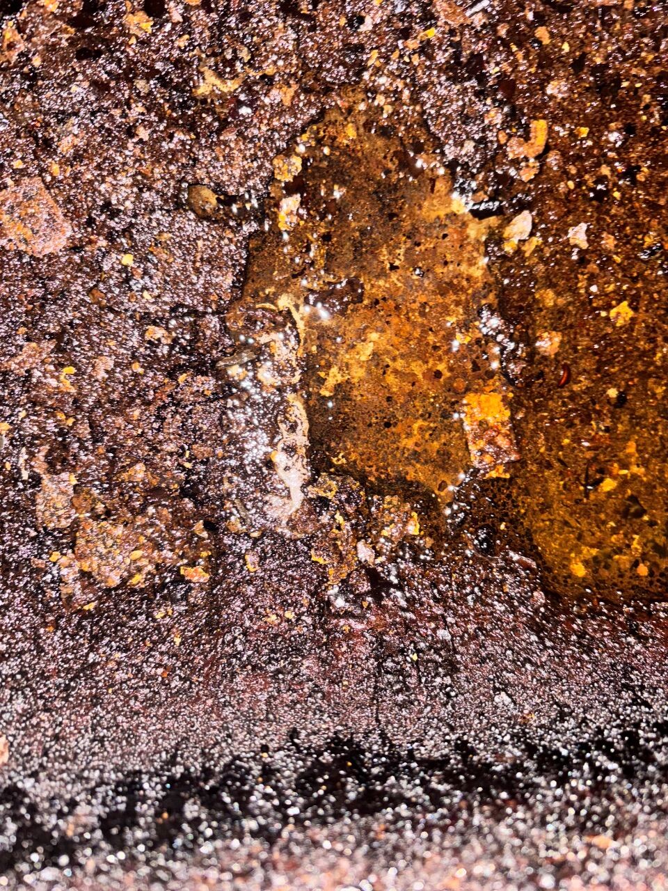

“Will only run with the choke fully out”
I had the same issue, then found my fuel tank looked like this inside
The SU's are very simple and generally a strip down and clean up is all that is required, if you do need to rebuild it the gaskets etc should be available from Burlen, if you can't see what you want on their website give them a ring, I'm sure they can sell you what you need.
Rebushing the spindle is the only slightly awkward bit if you have to do it but it can be done with just a pillar drill if it becomes necessary.
Stuck piston, possibly.

I had almost definitely decided to try refurbishing my Sherpa carburettor myself when I stumbled on a company in Bradford called Yorkshire Restorations, who offered a decent price and a two-week turnaround on carb work. So I thought I'd save myself a job. After all, I've got a lot of other stuff to be going on with.
The carb is now in their workshop. I've had a work-in-progress update, and - well, it's not too good.
This is a picture they sent me of the carb body after blasting. The metal is quite severely pitted. It looks more like crumbly cheese. I'm no expert on alloy castings, but - it's not supposed to look like that, is it?
I'm not sure if that's repairable, or whether the carb is toast. I'm awaiting the official verdict. The refurb guy did ask me if the engine actually ran with this carb on it...
Here's a thought: Could the metal be porous? Could air have been leaking in through the carb body itself? That would explain why the Sherpa would only run with full choke.

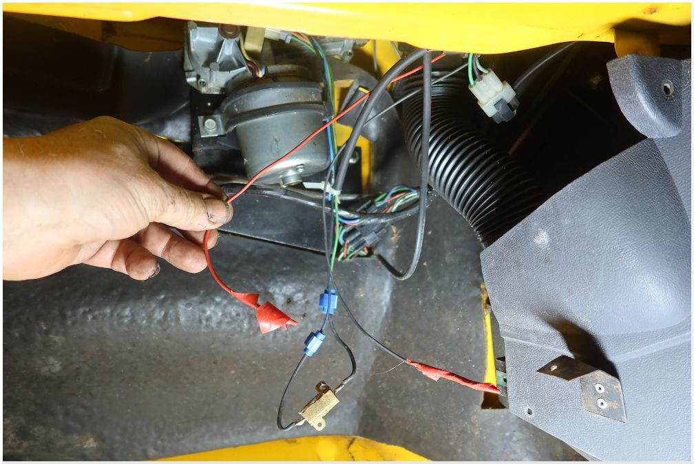

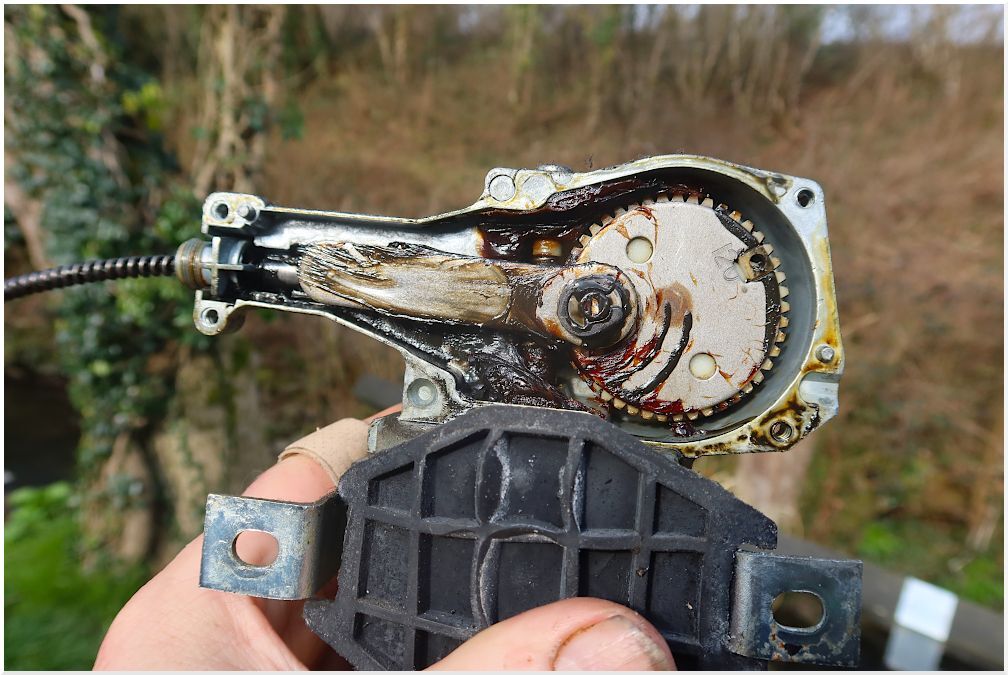

In the meantime, I've knocked off one job on the Sherpa Revival list. When I bought it, the wipers were obviously in a bad state - the blades had almost completely worn away, or possibly the rubber had perished. At any rate, new wiper blades were needed. Apparently, Germany is where all the best wischerblätter come from these days.

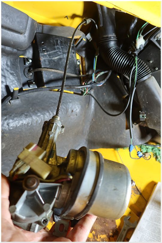

Wiper operation was painfully sluggish. I thought this was most likely due to dried-up grease in the mechanism, which could be fixed by a clean-up and re-lube. So I found the wiper motor, hidden under the dash, behind some interestingly random disconnected wires...
...and took it out, complete with the flexi-gear which works the wipers. At some point the Sherpa changed to a rod-operated wiper system, but in 1985 it was still done with a long worm drive.
The grease inside the gearbox wasn't totally dry, but it had gone like earwax, still greasy but rather stiff. I shouldn't think anyone has looked in here for 41 years. I suspect we might be just over the service interval.

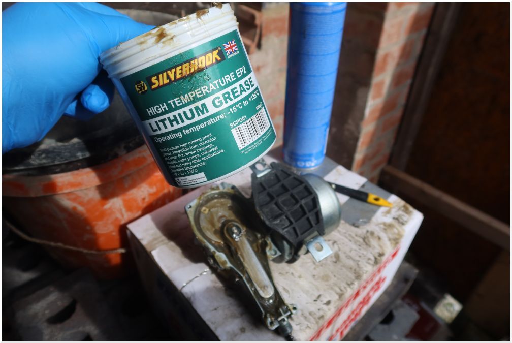

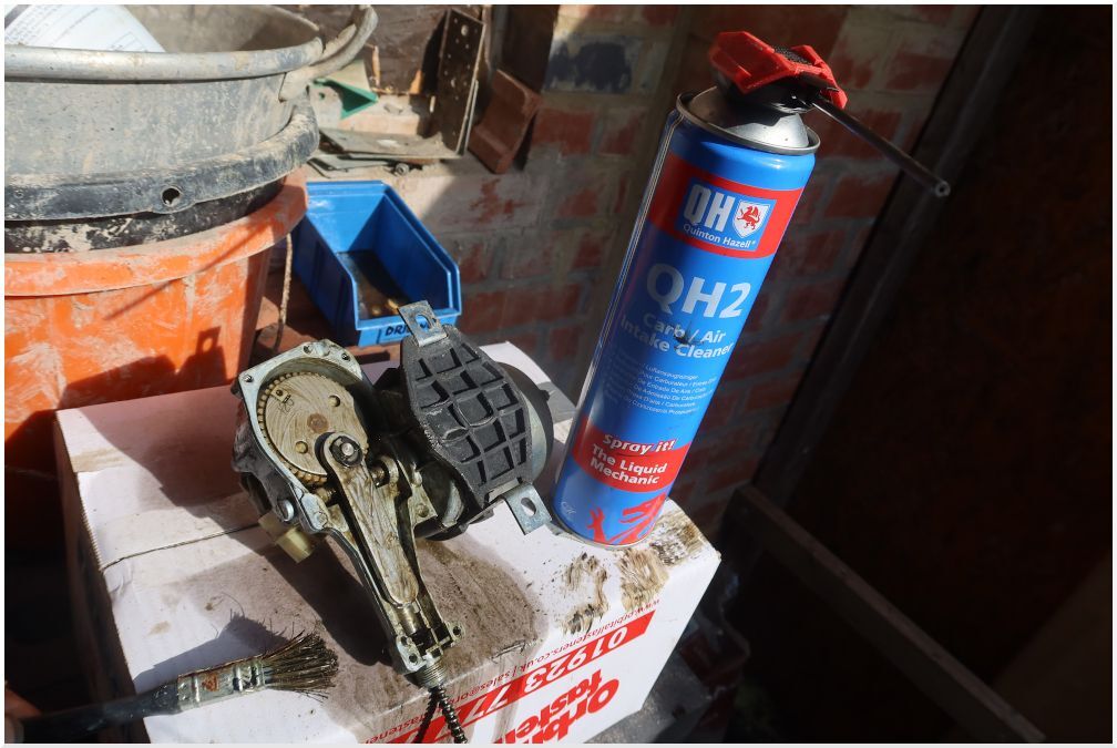

Let's clean it out. I don't have a workbench, so I'm improvising here with a cardboard box on a building site.
New grease in. Works up to 135 degrees, so my wipers will remain fully-functional in the Sahara desert.
Reassembly is the reverse of removal (and for once, it really is). Now let's provide some artificial rain, and test mein wischerblätter...
That's the slow setting. Sherpas (of this age, anyway) have two-speed wipers, plus a flick-wipe option, where one nudge on the wiper stalk gives you one wipe. All work correctly, so that's one thing off the list.

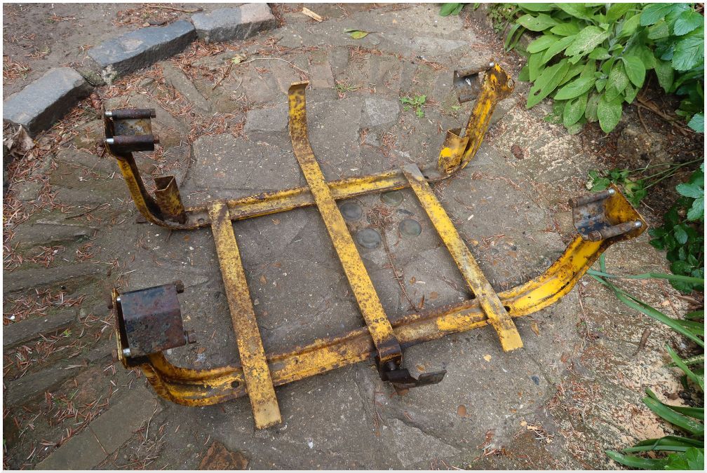

I've also had an eBay coup. I managed to buy this (not that there was much competition - I was the only bidder). It's a Sherpa spare wheel cradle. The original one on my Sherpa was missing, removed by the farmer when he fitted his DIY tow hitch. The spare wheel has just been randomly rattling around in the back ever since.
Of course, I didn't think about spare wheel cradles when I fitted my DIY number plate plinth right across the rear of the chassis, where the spare wheel would normally be hung. I assumed at the time that I would never find a spare wheel cradle, and I'd work out some sort of alternative arrangement for carrying the spare wheel (mount it on the tailboard, maybe, Land Rover style). But now I do have a spare wheel cradle, I might have to modify my plinth, because I think it'll get in the way. Still, the plinth is only a piece of plywood. I'm sure I can tweak it in a suitable fashion.
The cradle is a bit battered and rusty, and it'll need more than a quick wire brushing to restore it. I think I'll fire up my back garden blasting zone...

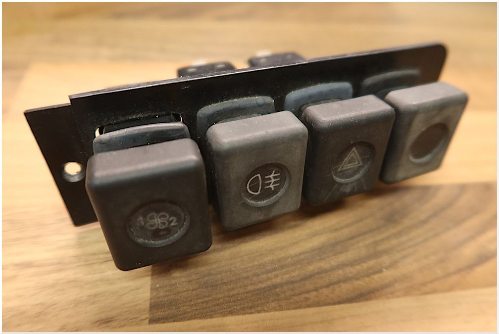

I also managed to buy another rare item - a complete set of those elusive dashboard switches, which as far as I can tell are unique to the1984-85 model year Sherpa and not used on any other BL vehicle, although some had switches that were similar but not quite the same. So these grubby old switches are treasure, I tell you. Treasure!
One of the switches is a dummy. Not a blanking plate - it's a switch with nothing behind it. I suppose on upmarket Sherpas this switch actually did something, but not on British Telecom below-base spec vehicles.
Theoretically it should be easy to fit the switches - just plug 'n' play.  But I'm sure it won't be as simple as that, because someone made all sorts of 'adjustments' to the under-dash wiring, and it's definitely not factory spec in there any more.

I did something similar to my Maestro wiper motor which was also full of dry old grease. It didn't seem to make much difference, but then I scored a NOS motor and fitted that. It's still not great, but I expect it's back to 1988 levels of wiperage.
I need some new blades for it though as they are juddering across the screen. Consensus here seems to be they're all as shit as each other and may as well just buy cheap ones.

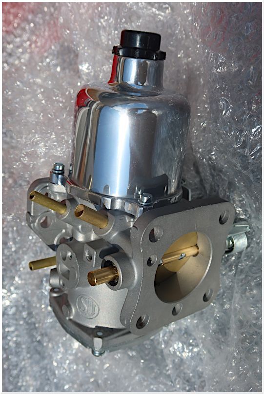

The HIF 6 carb seems to be a bit rare in single form (well, it wasn't rare in its day - it was fitted to every Morris Ital and Austin Ambassador, but where are they now?). These days they're much more common in twin carb form.
However, there's a solution to my Wensleydale cheese carburettor. The refurbisher has a good carb body in his box of bits, and he'll build up my carb on that. One slight difference will be that the fuel inlet will be on the opposite side. Apparently HIF 6 carbs came in left/right fuel pipe versions, probably for twin-carb set-ups, with the fuel pipes coming in from opposite sides.
That's no problem for me, with my humble single carb, because there's plenty of room to route the fuel pipe to the other side. In fact it may be a better option, because at present the fuel pipe does a loop around the carb to come in from the front. Connecting the pipe on the bulkhead side would be neater...
I wonder if that's a replacement carb, and the factory original had the fuel pipe inlet on the other side. It would be much more logical to do it that way. In which case, the re-replacement carb will actually go back to the original fuel pipe arrangement.

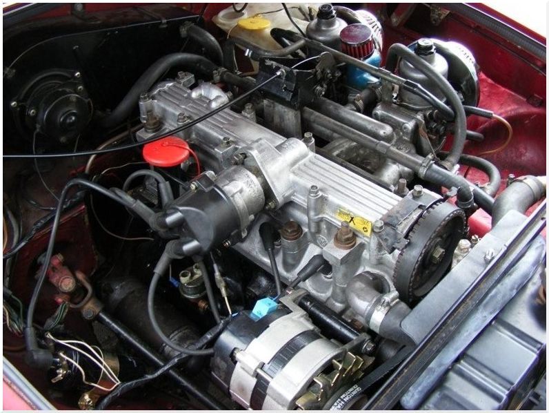

Here's a twin-carb O Series engine (from here - interesting stuff about BL's experiments with the O Series in the TR7). Fuel inlet definitely on the left in the front carb. Not visible on the rear carb, but it must be on the right, surely. There'd be no room to get it up the middle...
Theoretically I could put twin carbs on the Sherpa, but it would probably be a bit silly to do that on a low compression commercial engine. It would probably just increase fuel consumption without giving any extra power. It might be worth doing on a car-spec 2 litre version of the O Series. I'll keep that thought in mind in case I ever buy a Morris Ital (you may not be entirely surprised to learn that a Morris Ital is indeed on my list of Cars I Would Like To Own - apparently the late models, with parabolic rear springs and telescopic dampers, handle quite well...)
Just as an aside, an HIF6 is but 0.45mm bigger than an HIF44, and they're far younger.
