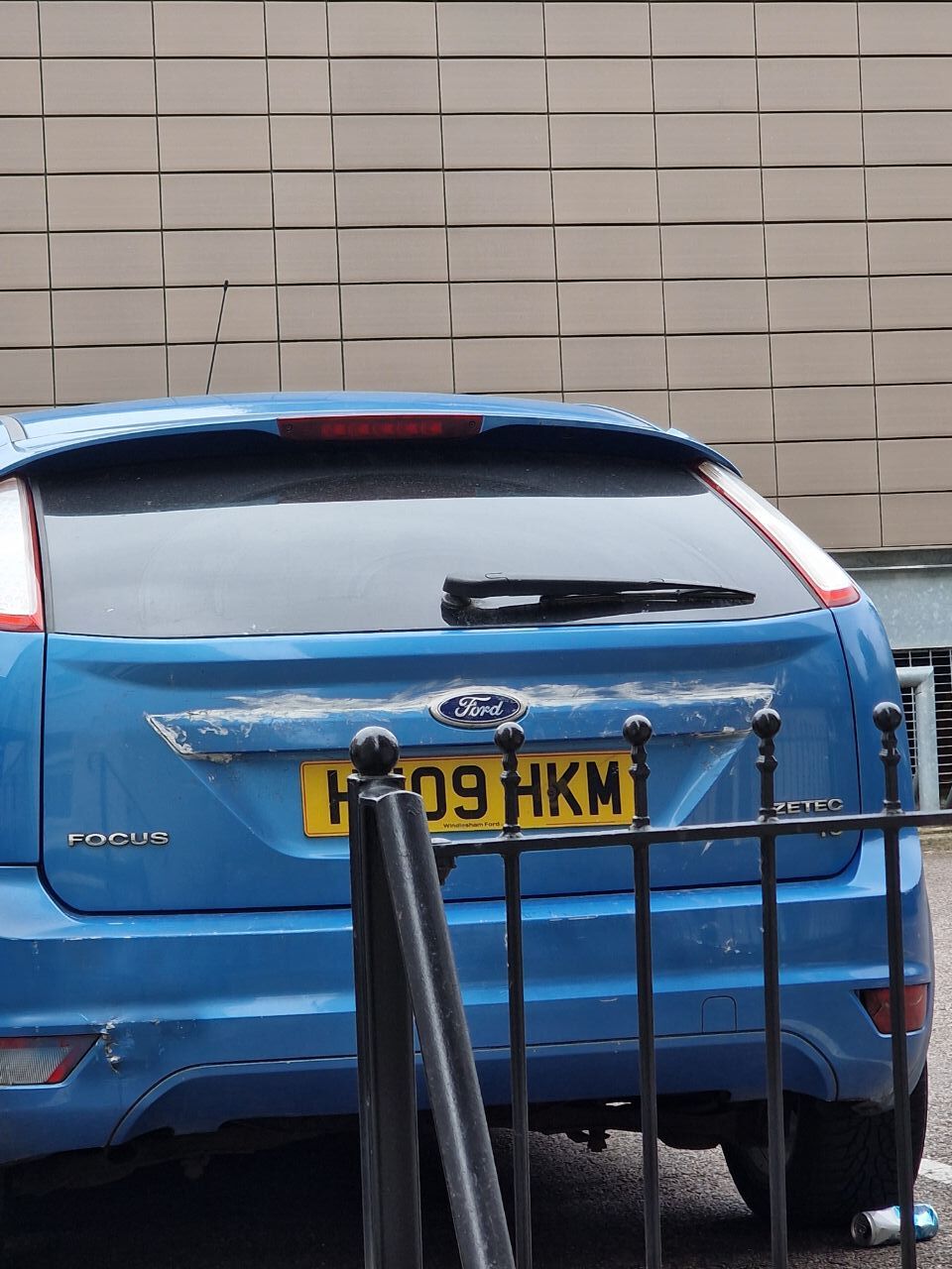

DavidB Posted June 14 Posted June 14 I've seen this enough on the road to know it must be a common thing on these, what is going on here? Jerzy Woking, Tenmil Socket, Banger Kenny and 11 others 6 8

Low ontime Posted June 14 Posted June 14 It’s Ford being cheap, the rubber seal on the door is just stuck on. forcus c max and fiesta if holes where made and plastic push in plugs where there like many other cars it wouldn’t be seen

grogee Posted June 15 Posted June 15 There is/was a recall, but the "fix" just involved cleaning the bottom of the door and sticking a new seal down with 3M tape. As @Low ontime says, the proper solution is holes plus plastic clips to stop it falling off, but Ford cost-reduced that to double sided sticky tape or school grade pritt stick.

catsinthewelder Posted June 16 Posted June 16 Transit Customs are even worse, the passenger door seal runs underneath the fuel flap. Diesel spills make the trim expand and fall off its clips. I was binning them at 3 months old. At least the Focus door trims usually survive 3 years. The number plate surround on my mk2 came loose too and took a fair bit of paint off the bootlid. Mostly caused by a cheap bike rack.

New POD Posted June 16 Posted June 16 On 14/06/2025 at 07:59, DavidB said: I've seen this enough on the road to know it must be a common thing on these, what is going on here? My mother paid a Ford Dealer to attach the passenger side rubber and sort out 2 dodgy tyre pressure sensors. The bill? Over £300. Mind you they did come 10 miles to pick it up and drop it back which was good* of them. A month later the other side came loose, and the 2 other pressure sensors went dodgy. 66 plate 85k estate.

mk2_craig Posted June 16 Posted June 16 9 hours ago, BorniteIdentity said: rubbish Sounds like the same design continued to the 2018-on “mk4” models too. Same inevitable results, same official fix. Still, it no doubt saved Ford 37p per car, which was a decent benefit to the overall margin back when they were selling more than 150 of them every year. BorniteIdentity 1
