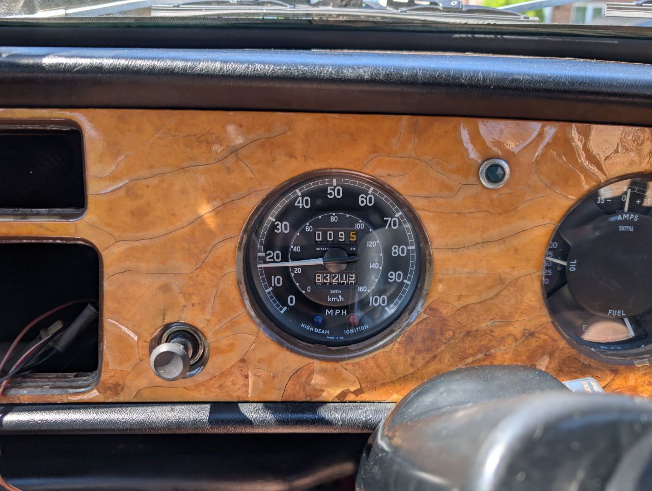

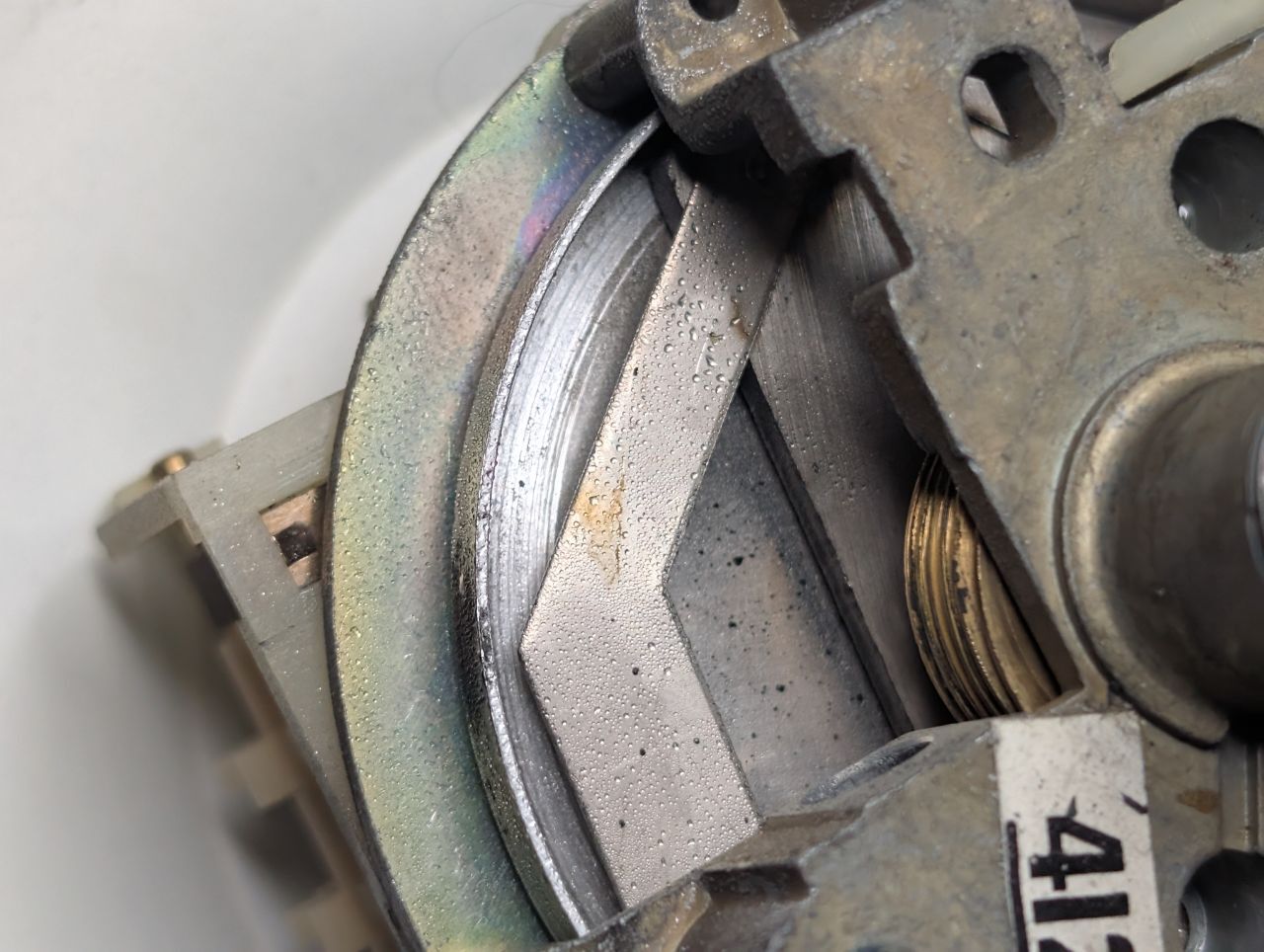

Opened up the speedometer yesterday evening.
Gave it a good clean out and re-oil with clock oil.
It was filthy from metal dust. The spinning magnets appear to be hitting the needle cup. I tried bending things out of the way but didn't want to break anything. Spinning by hand while pushing in the drive cable side doesn't catch at least now. There is play on the cup which presumably why it's hitting.
MGOC order has apparently been delivered today so hopefully I'll get some time later to fit this all back in again. Also have a go at fixing the heater controls while I'm in there.

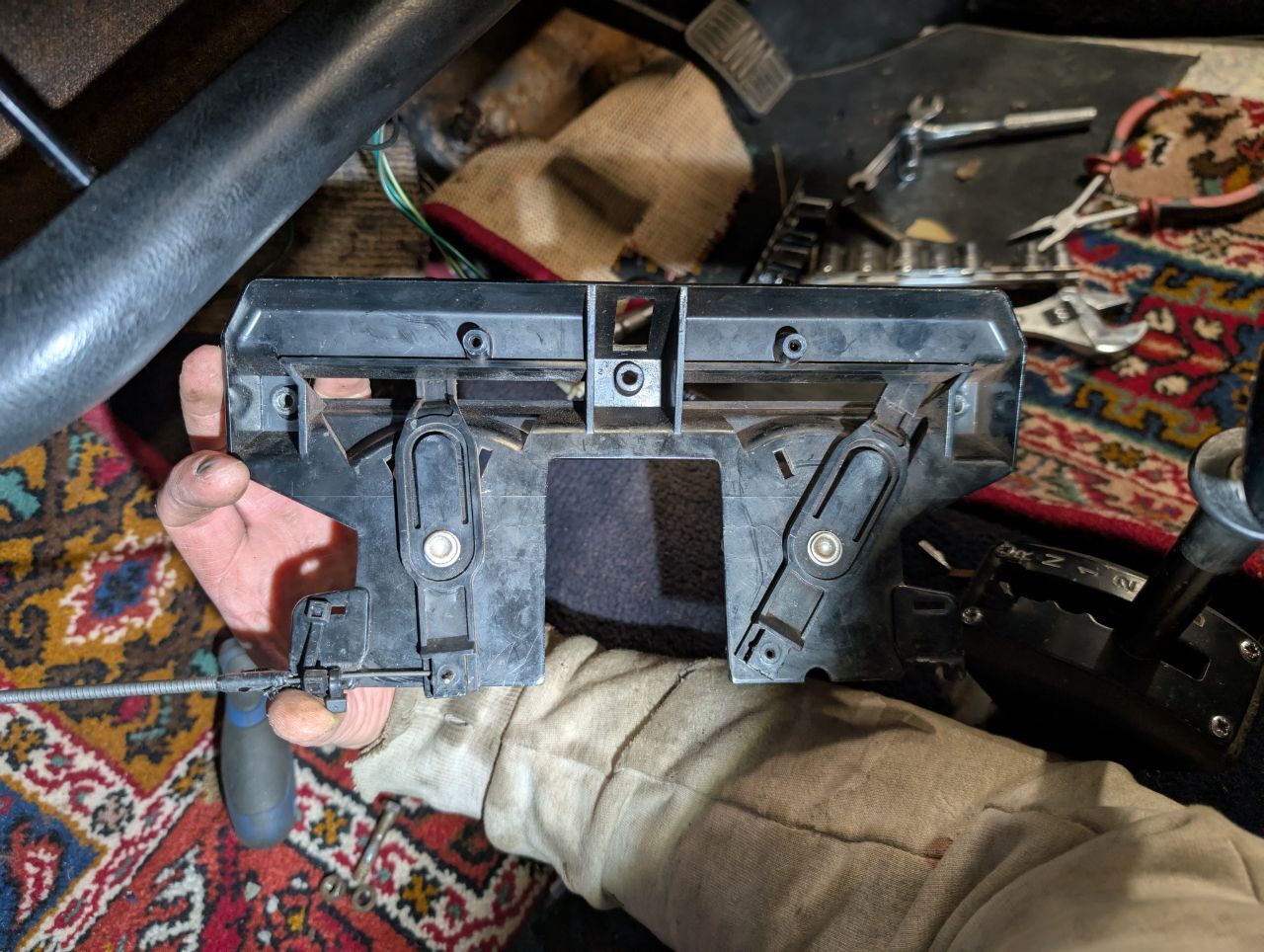

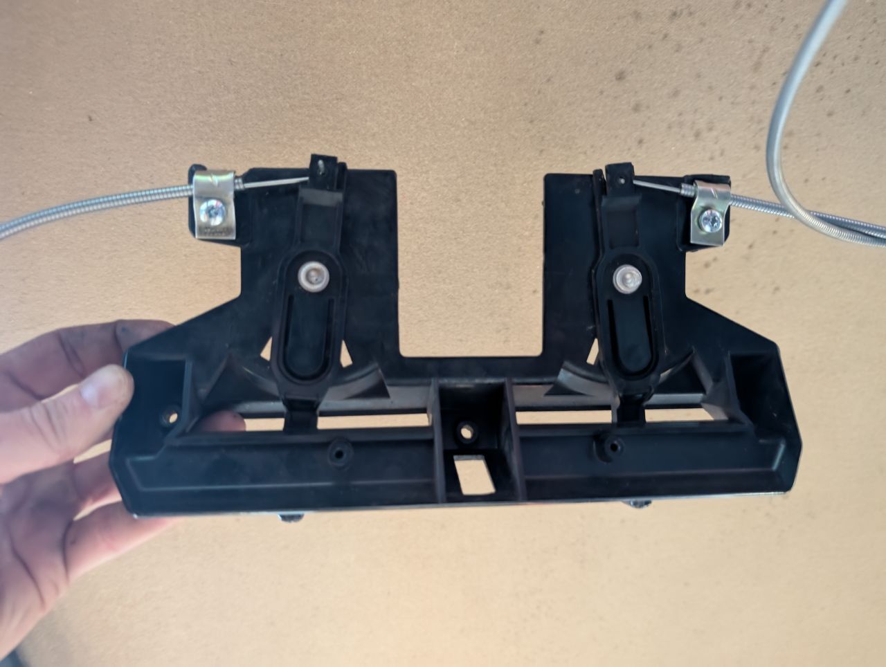

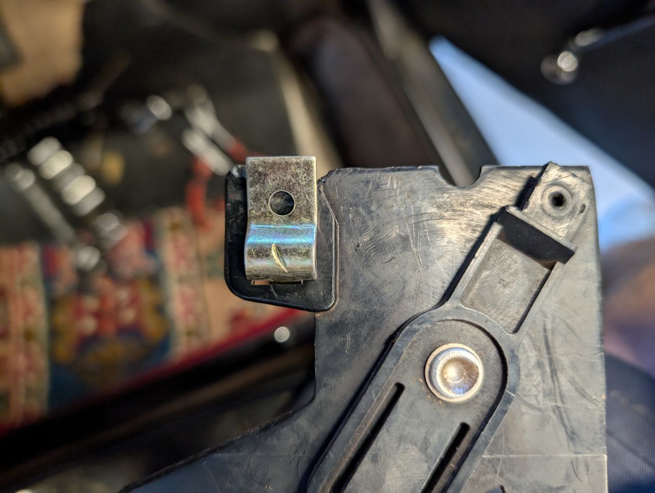

Started off by sorting the heater controls. Zip tie repair wasn't holding well.
Removed all that and decided to come up with a different solution.
Plan was to put these clips on. They're for a MGB/Midget but also used in places on this 1100. The left clip can't go in like that as the plastic is broken.
This way around would mean the angles are all wrong for the cable.
Other side is easier as it can hook through. Just needs a hole drilling.
After a bit of bending of the clip on the broken side, I hooked it around.
Other side was easier.
With new holes drilled for the screws and all bolted in, it was done.
Cable was too long for the under bonnet - I bought the longer one and should have got a shorter cable. However easier to shorten than lengthen. I used some bicycle cable cutters which give a very easy clean cut. I guess an angle grinder would have worked as well too.

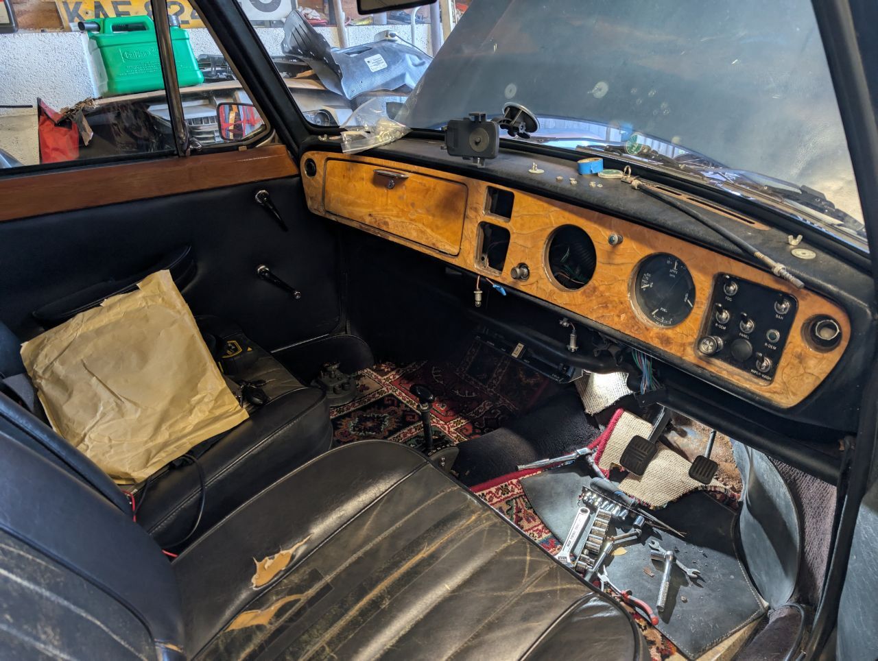

Decided to rebuild the column. These have two bushes. A top plastic and a bottom felt that is soaked in oil. Bit shite design but I guess enough for a few years till the cars rotted out. The issue with this one is the bottom felt bush was completely flat and the whole column rocked around. Apart from a very annoying rattle, it is quite annoying to have the steering wheel move around in your hands all the time when driving.
Not too tricky a job. Basically undo the wheel and pull apart. Plastic bush push in and the felt slips in the bottom after copious amounts of oil soaked into it.
Stiffer but still moveable. A lot less rattly though!

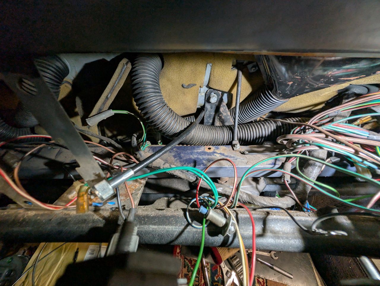

Put the dash all back together. Actually pretty straightforward job and far easier with the column out.

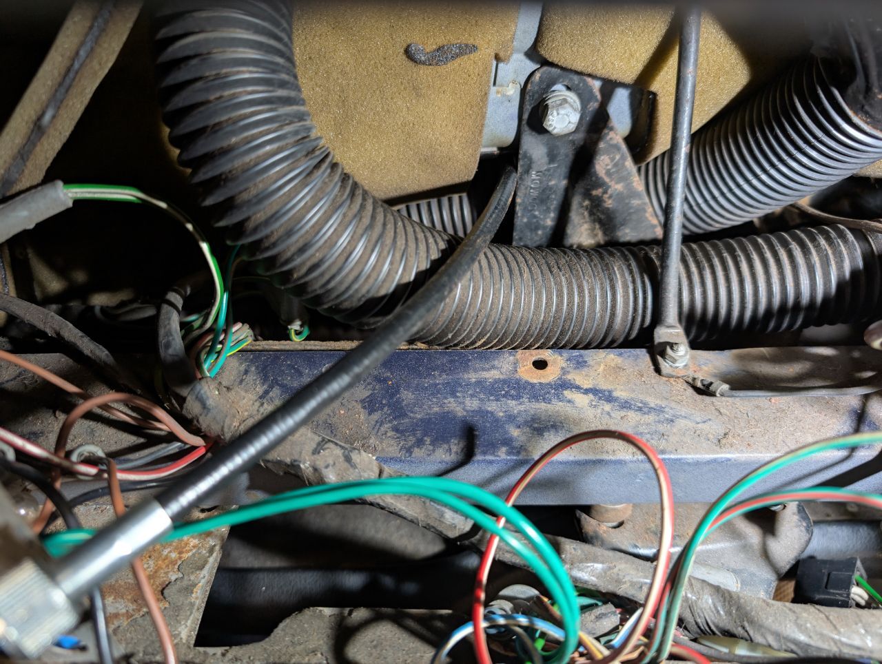

Behind the dash looked remarkably solid.
I would assume this is the original factory paint colour.
Test drive found the Speedo working again. About 2-4mph too fast on the Speedo versus actual speed up to around 40mph. Above that it gets quite a bit more inaccurate. That's fine for me and better that way around. More than good enough now and not worth sending it off tbh. 👌

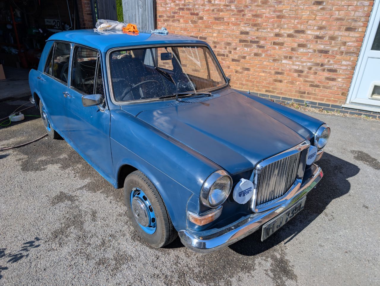

Going to give the car a quick going over with some t-cut this afternoon and see if the paint can be brightened up a bit.
A neighbour (who long since sold his blue car) gave me this:
Worked really well on the P6 - better than all my far more expensive potions.
Pre polish but post wash
Post polish front end.
So far it looks better...
...depending on the angle you look at it 🫣
I mean it's kinda better where I've gone over with it... Left is after, right is before in case it's not clear (probably isn't 🤣)
I think the heat and hot metal is not helping the front end.
Worst case I'll only just have to drive this on dull days.
Yeah, doing it in the sun never gives good results.
That blue polish stuff I mentioned covers a surprising multitude of paint sins, too.
My guess is that the paint was matt/ satin finish(Certainly looks that way in the old lay by photos) and not a poorly applied gloss. No amount of wet sanding or polishing could bring a decent shine to it and any oils in wax products just washes off. Like it's gone porous.

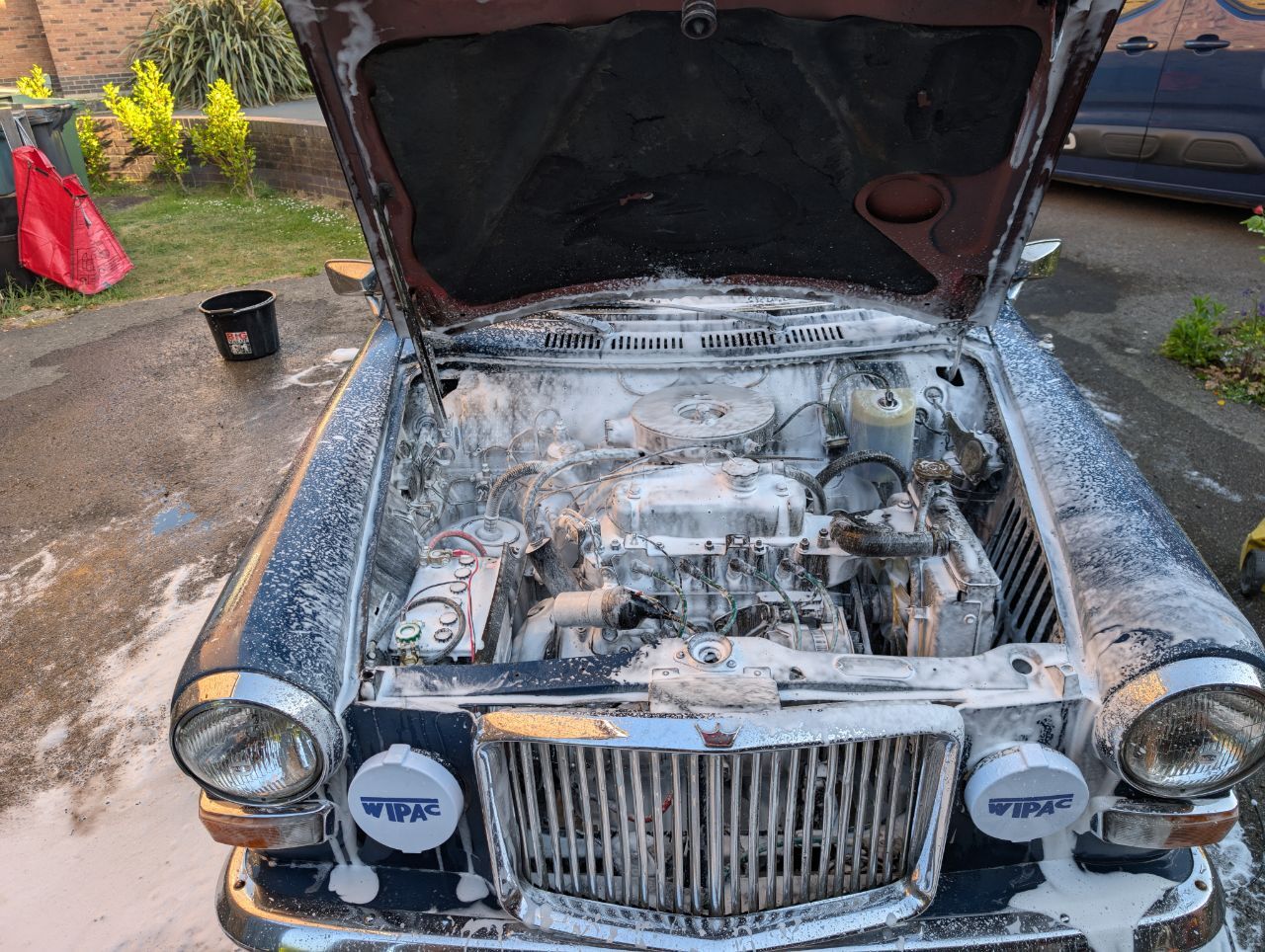

You flooded the distributer!
Don't be silly. That won't fill a distributor.
Doing this can though.
Especially when pressure washing it after
Is your cardboard cover in place?
No, it doesn't have one.

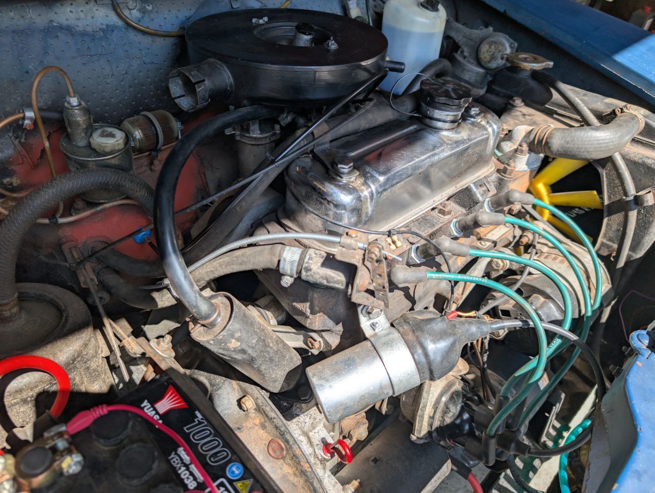

And yes it didn't start after. Water was mostly in the coil cover actually and the dizzy was dry. Also some water got through the air filter cover and into the carb too. Which suggests the air cleaner isn't actually sealing that well. 🫠

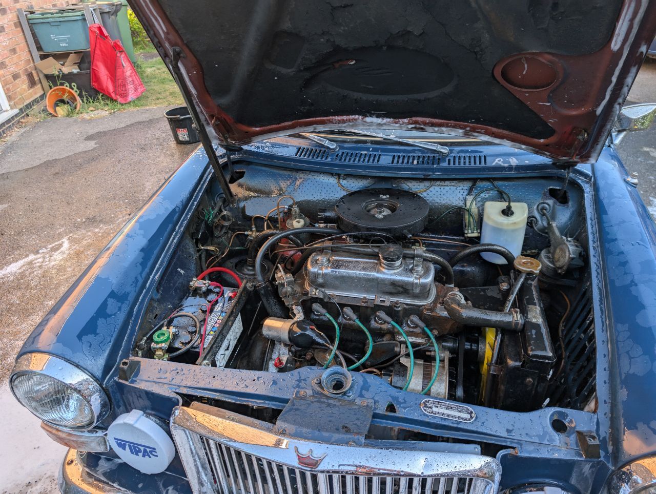

Why did I do this? This engine bay has been one of the worst I've had where every time I go into it, I get absolutely filthy. By far the worst even going by all the other old wrecks I've had. Probably not helped by the oil filter housing keep leaking.
Anyway apart from cleaning it up so I don't get dirty, it's easier to track and notice any new oil leaks if the engine bay is relatively clean.
