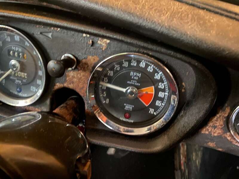

Popular Post Peter C Posted November 30, 2024 Author Popular Post Posted November 30, 2024 The other day I noticed a green cable hanging loose under the dashboard, below the rev counter. A bit of research revealed that a green cable connects to the back of the rev counter. I fiddled with the cable behind the dashboard, managed to plug it in where it belongs and hey presto, the rev counter is working again. I refitted the metal cover that goes over the brake and clutch master cylinders as without it, a cold draught gets into the cabin, directly towards the man sausage area. I have secured the cover with a screw and a cable tie as a temporary arrangement, as the brake master cylinder will definitely require replacement soon. I fiddled with the ignition timing and the engine is idling better now. Afterwards, I went for a quick test drive and was pleased to note that the exhaust and damper no longer collide. As it started to rain, I put the MGB into the garage. But after lunch the (light) rain cleared and I took the MGB on a 40 mile (return) trip to see my parents in London. The M40 is not the MGB's natural habitat so I stayed in the nearside lane and took it easy. As the overdrive is not working, at 55MPH the engine is spinning over at 3,500 revs. A bit much. I need to find out what is wrong with the overdrive. The traffic got heavier once I crossed the M25 but the engine was happy, no temperature rises and it continued to idle and pull nicely. Upon arrival in London I noticed that debris had been blown in via the ventilation duct located behind the bulkhead. To the best of my knowledge there is no way of accessing the void to give it a clean. Looking pretty in London. On route back on the M40, I focused my attention on the noise coming from the back of the dashboard. It's like a vacuum with a rough edge to it sound. I wonder whether it is related to the non-functioning oil pressure gauge. Must investigate further. Also, the backlight lights don't work on any of the dials. I managed to squeeze three large boxes in the MGB - practical car! The only fault that I noticed once I got home was a defective nearside headlamp. Maybe a loose connection? Or a blown bulb? Either way, doesn't matter as the MGB completed its first proper voyage and I absolutely love it! More soon. privatewire, Sunny Jim, Christine and 50 others 47 6

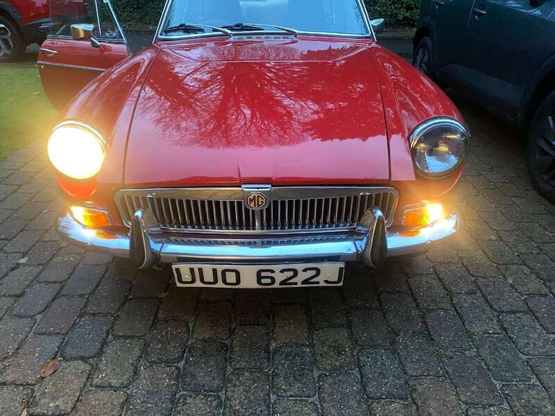

Peter C Posted December 1, 2024 Author Posted December 1, 2024 I investigated the defective headlight issue. Removal of the lamp unit could have been easier, the chrome bezel was a bitch to remove. I tested the wiring, no issues here. I tested the lamp unit and sure as hell, it's blown. Rather than replacing just the bulb, I now have to replace the entire light unit. Great. I wanted to investigate the defective oil pressure gauge issue and the vacuum sound that emanates from behind the dashboard. To gain slightly better access to the back of the gauge, I removed the radio and the console. I found an old V11 tax application form, which dates back to 2004, when a Mr David Ross Ashby owned the MGB. I searched for his property on Google Streetview, clicked on the old images but there was no sign of a shiny red sports car on the driveway. Or an MGB. The oil pressure gauge is definitely mechanical and I can't see anything wrong with the tube that extends via the bulkhead to the back of the gauge. The gauge / pipe are fed from the side of the engine block. I have no idea what could be wrong. Is the gauge faulty? Is there some of form of sender somewhere I can't see? I am not particularly worried about this issue as the engine starts on the button, runs well, doesn't smoke, pulls well and doesn't knock or rattle. If the engine was worn to the point where it has absolutely no oil pressure, it wouldn't be running this well. I managed 40 miles in the MGB yesterday, mostly with the engine revving at over 3,000 rev/min. If it had oil pressure issues, it would have said something. Even if the oil pressure is lower than what it should be, I wouldn't intend to do much about it. I certainly wouldn't be looking to rebuild the engine. The mileage reading is 93k. Is that genuine? Are the clocks original? Has it been around the clock? Maybe twice? Who knows. As for the vacuum noise, I have absolutely no idea what could be causing it. More soon. mercedade, danthecapriman and Marina door handles 3

LightBulbFun Posted December 1, 2024 Posted December 1, 2024 1 hour ago, Peter C said: Rather than replacing just the bulb, I now have to replace the entire light unit. Great. that *is* the lightbulb the light unit in your case would be the lamp holder, and the bucket the lightbulb is fitted too the lightbulb in your hand is whats known as a sealed beam lamp, a superior form of lightbulb over any separate bulb and reflector headlight unit, in a sealed beam lamp the the filament is directly and precisely focused in the precision reflector of lamp at the factory and the whole lamp is completely sealed and the inside is fill with an inert atmosphere to protect the filament as with any other lightbulb, the result of this is the reflector is sealed inside the lightbulb itself, so it can never get dirty or tarnished, and every time the lamp is changed you get a new fresh reflector and sealed beam lamps are made out of pressed glass construction so robust and precise mirrors and lenses can be incorporated in the design of the lamp and the filament is always focused within this at the factory, so there is no need to worry about alignment of the light source itself within the reflector they mainly fell out of favour because they are very much a function over form device, and car designs and fickle public wanted different shapes and all that, but in applications which demand performance, for example aircraft landing lights etc you will still find sealed beam lamps, these days ones with Halogen capsules sealed into the reflector for even better performance as can be seen in this aircraft landing lamp of mine kindly recently sent to me by another member on this forum it is 28V 450W PAR46 example (, PAR=Parabolic Aluminised reflector, 46, 8th's of an inches in diameter, the same as the 5.75 inch headlights found in a Rover P6 or such, normal car seal beams like your MGB are PAR56 aka 56 8th inches in diameter) (and as a fun fact its this technical superiority of them, which is why the US mandated their use for so long) Datsuncog, danthecapriman, cort1977 and 8 others 10 1
High Jetter Posted December 1, 2024 Posted December 1, 2024 AKA SBU 7002, 7004 etc, depening on whether they have a pilot hole for sidelight. The 7 indicates 7" diameter, 5000 (5") series are more for twin headlamp cars like Rover P6. & Triumph 2000 etc. Your lamp is £13.75 from the MGOC https://www.mgocspares.co.uk/product/13h3471/headlamp-unit-sealed-beam-65-55w-rhd-with-pilot?srsltid=AfmBOoq6Y9lxat1zqwealYe7SMOvAMdLCXNOg0uaRgTwv6X3JUYrHDdS Peter C 1
High Jetter Posted December 1, 2024 Posted December 1, 2024 Hang on, you've got separate sidelights - why the pilot window in your headlamp?
Zelandeth Posted December 1, 2024 Posted December 1, 2024 The needle in the oil pressure gauge isn't just stuck on the broken bit of illumination diffuser is it? As for the dash lighting, I'd be checking the rheostat first, they're usually scratchy as hell at the best of times, never mind if having not been used in years. Matty, Peter C, garethj and 3 others 2 3 1
