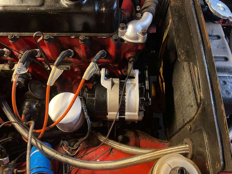

My auto electrician friend supplied me with a brand new alternator. Nice!
Fitting it was a doddle.
With the alternator refitted, I tried to start the engine. It wouldn't fire due to a complete absence of any spark.

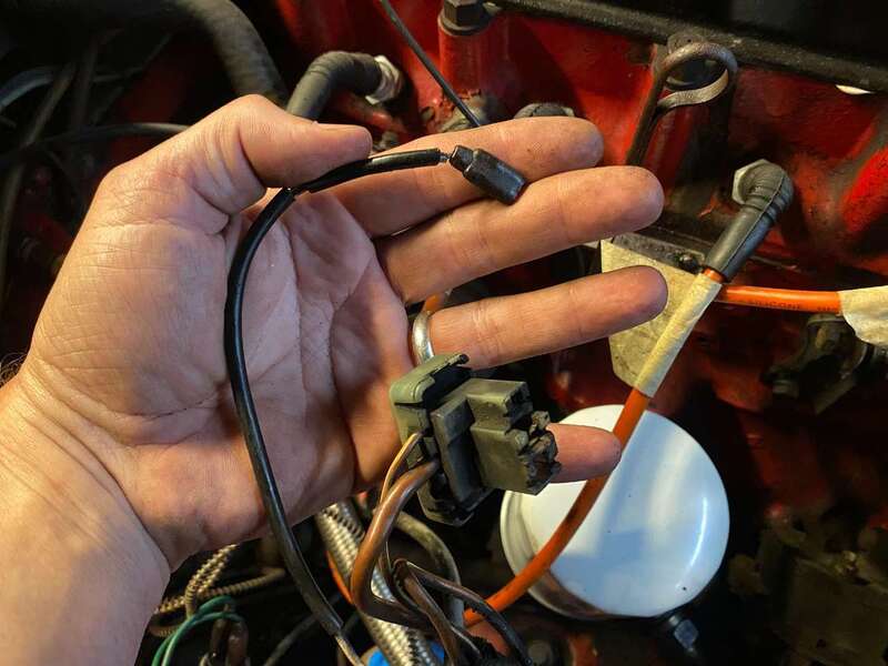

When my auto electrician friend came over to diagnose the electrical faults earlier this week, he disconnected the plug from the back of the alternator. At the same time, he pulled another wire.
A couple of days ago, I posted on an MG related Facebook group, asking what the spare wire is for.
One chap very kindly advised that it's for the coolant temperature sensor and 14 other lovely chaps agreed.
Seemed legit. Except all 15 of those lovely chaps were wrong. Turns out that the spare wire connects to the side of the distributor.
Once the rogue cable was reinstated into its rightful position, the engine fired up immediately and ran ok. When cold, there was a slight hesitancy when the throttle is opened but after a minute of idling the engine idled and revved up smoothly. The remains of the old fuel don't smell great and I suspect that the engine will run better with a tank full of fresh petrol. I didn't want to drain the fuel tank as it's 50/50 whether the drain plug will unscrew or break in some spectacular way.
With the engine running, the charging system seemed to be working ok as the ignition light was no longer shining brightly.

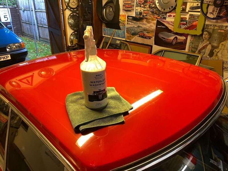

I cleaned the MGB with a waterless wax something or other, which I've had lying around for a couple of years. It actually did a decent job, the paintwork gleams again, although the MGB is still definitely a ten footer.

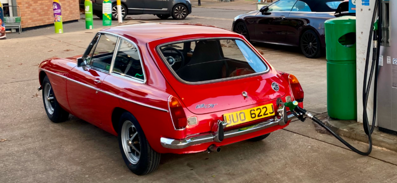

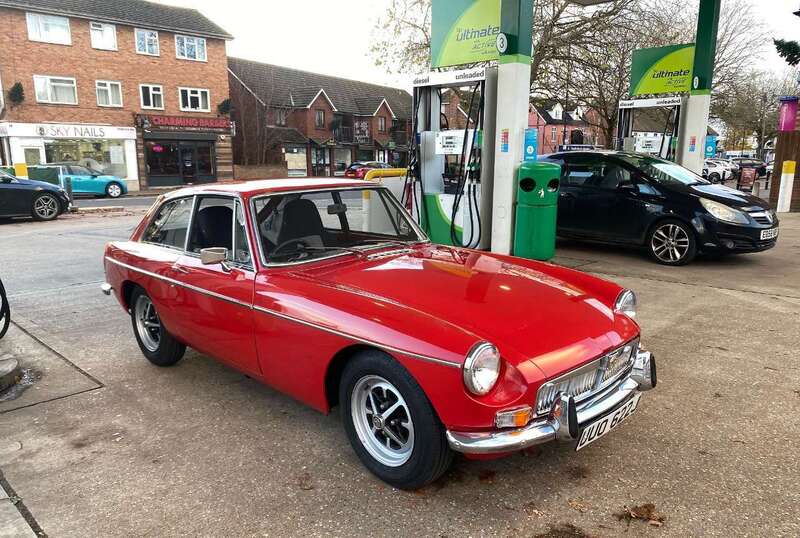

Test drive achieved! The weather has drastically improved since yesterday evening, the roads were mostly dry and I made time to pop to my local BP station.
Looking sweet (from ten feet)!
So, how does it drive? Better than I thought.

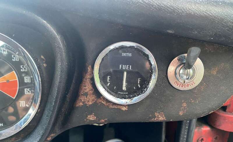

Engine - pulls nicely, doesn't smoke, sounds ok, maybe a bit tappety but that's easily solved. The oil pressure gauge doesn't work. The engine temperature gauge suggests all is well. The rev counter stopped working but I reckon that I didn't take the engine past 3,000 revs, no need as it has plenty of torque and old eight valvers don't like to rev anyway. When I got back home, left it to idle whilst I opened up the garage doors, the idle speed was too low. Hitherto, I set the carbs and ignition timing when static, more fiddling is required.
Once I got above 30MPH, there was a strange hissing / radio static sound coming from the centre of the dashboard. Not sure what's going on, there is nothing rubbing or leaking. Needs further investigation.
The fuel gauge came to life on route home, which is odd as one of two cables that extends from the sender unit is disconnected (damaged terminal). Perhaps the disconnected cable is an earth and the sender is earthing itself via the tank? Anyway, nice surprise.
The gearbox works well, all gears go in smoothly, no crunching, all synchros are good.
The overdrive is supposed to work on 3rd and 4th gears. I flicked it on, whilst in 3rd gear, at about 35MPH, nothing happened. I didn't go fast enough to try it in 4th gear. Electrical issues? Or a knackered solenoid?
Clutch take up is nice and smooth and the biting point is about half way up the pedal travel. Nice.
Steering. What a surprise!!! I was expecting heavy and vague but it isn't. Even with the smaller steering wheel, it is perfectly manageable and has no slop whatsoever. Nice.
Brakes. A bit shit. The pedal still feels soft and has too much travel but once pressed down fully, the brakes work well, pull up straight. Maybe more air in the system? Maybe the master cylinder is not happy?
Suspension. Another lovely surprise. The ride comfort is great, it doesn't crash and bang down the road. All feels tight, with no rattles or knocks. Very nice.
Bucket seat and small steering wheel work really well together. The driving position is great, low but not sitting on the floor low and the steering wheel is placed perfectly at the right height.
Overall, LOVE IT!!!! Yes, there are a few things that still need TLC but I managed six miles to the BP station and back without breaking down. Result.
I took a few more photos outside my house. What a lovely looking motor.
More soon!
