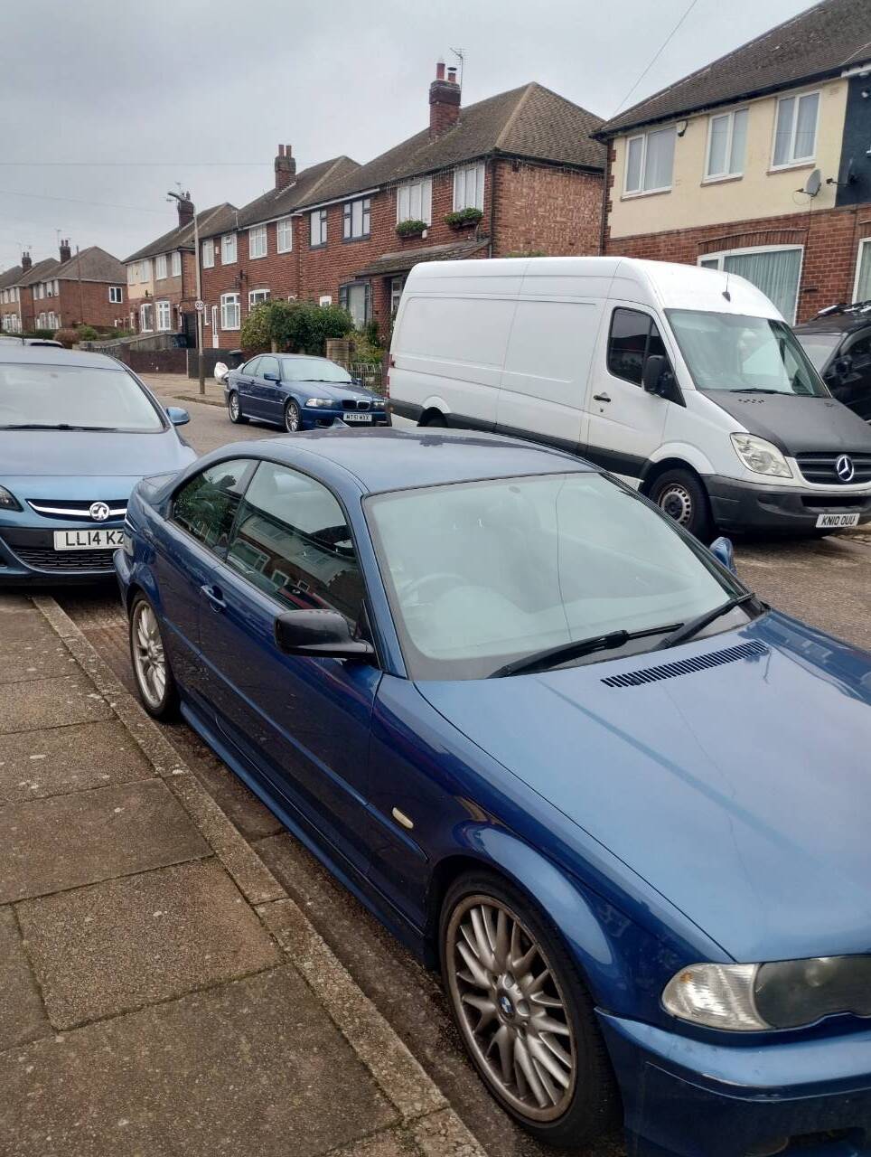

The 330 is a different car now. Before, the box was strained, held gears uncomfortably long, take off was jerky and delayed and it wouldn't lock up on motorways. And of course went into limp mode (stays in 4th) after 10 minutes. The car was also quite slow.
Now, it's smooth, changes up gears quickly around town and uses the torque of the lazy 330. On the motorway it's now very relaxed, the box locks up and importantly, cruise works again. It was a long drive home, the roads were busy and wet but it was a pleasure to drive.
36.5mpg achieved, not bad for a big old petrol.
Let's hope it continues this way.

I haven't used this in a good while, it's been tucked up in my garage.
An old Vauxhall pal had a bonnet for me, in colour and free as I'd given him the Android unit a few months ago.
The plan was just to swap it over at his garage. 4 12mm bolts and a few pipes eh? Well yes and no:
As you can see, how the fuck are you supposed to thread that loom back through? There's no join anywhere, it all just goes into the main loom so pulling it through the void is the only way. So we patched that as his garage is very busy and I didn't  want to take up too much of his time. He's going to drop it off for fuel money at the weekend and I can fuck about with it at my leisure in my garage with no time limits.
I also got a washer bottle for nowt out of a 320d he was scrapping. Unfortunately it wasn't a posh model like mine with Xenons and washers so the tank didn't have the 2nd hole for the high pressure pump for the lamp washers.
On inspection though, it looks like the original tank on mine is fine and it's been leaking at the pump seal.
So I took both out, cleaned them and put red rubber grease around the seal. If it still leaks I'll drill a hole on the new tank to accept the 2nd pump.
I'm looking forward to getting the new bonnet 😀
It's driving very well, no issues at all. I'm having a bit of trouble getting past how much it's kicked my ass though. I totalled up the cost of the gearbox replacement and it came in at a cool £950.  I'm also wanting another Saab and for what I could get for this (the same as I paid for it) I could get quite a nice one.....
I should really keep this for a while at least though I suppose.
