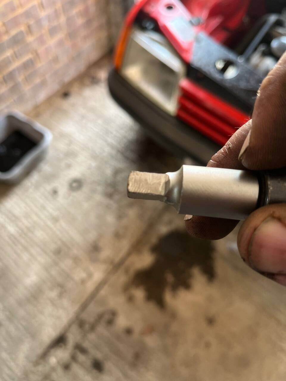

Sod waiting for oil to find a level. I grazed the sides of the sump plug square thing with the angle grinder.
Which meant this:
then this:

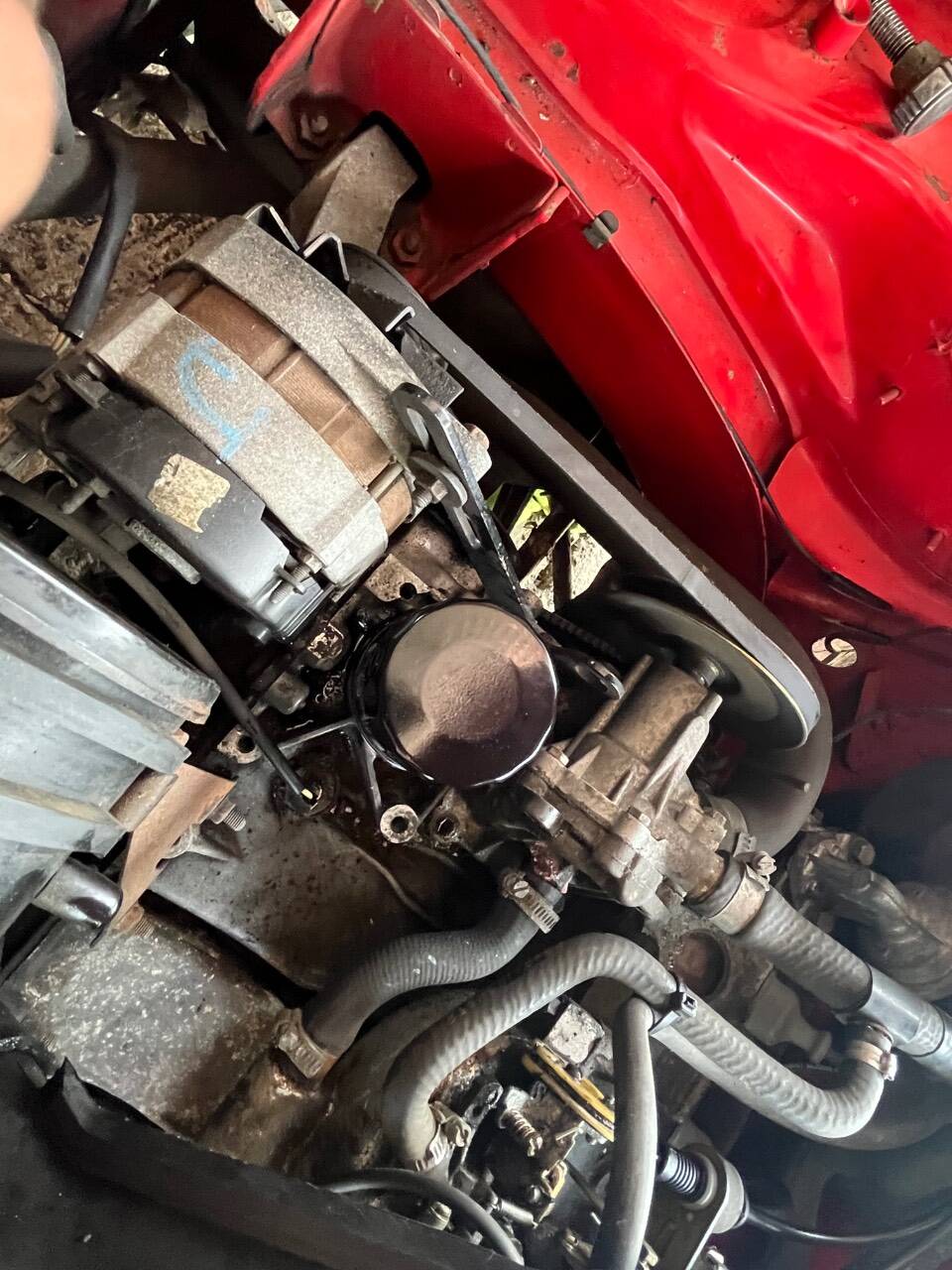

Some swarf on the drain plug, but not worrying amounts. Every suitcase engined car I’ve owned has some small amount of swarf on the sump plug, possible due to gearbox-in-sump design.
Oil filter was properly tight. New on on right. Different sizes but the thread matches and as shown below it fits.
The disadvantage of this engine is you can’t prime the filter with a glug of oil, so I disconnected the coil and turned the engine over for a few seconds. Not having a working oil pressure light is a bummer.
Coil reconnected and we have lift off. Sorry for potato cam, I had a smear of muck over the lens.

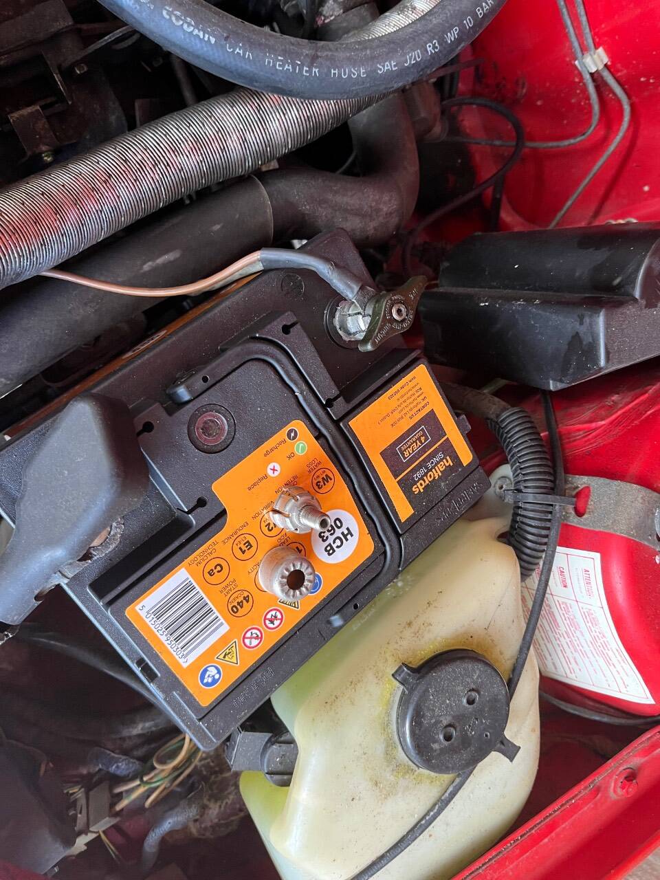

This morning a proper tap-type battery terminal arrived for the 205.
IMG_4857.jpeg.06b3219a5e178c9082763f006ee89a94.jpegIMG_4858.jpeg.fc28dca599fbea1dcbb543c72215f1b0.jpeg
The one on the car was missing its cup. Swapped over and we have a secure negative connection. Next I was greeted by this:

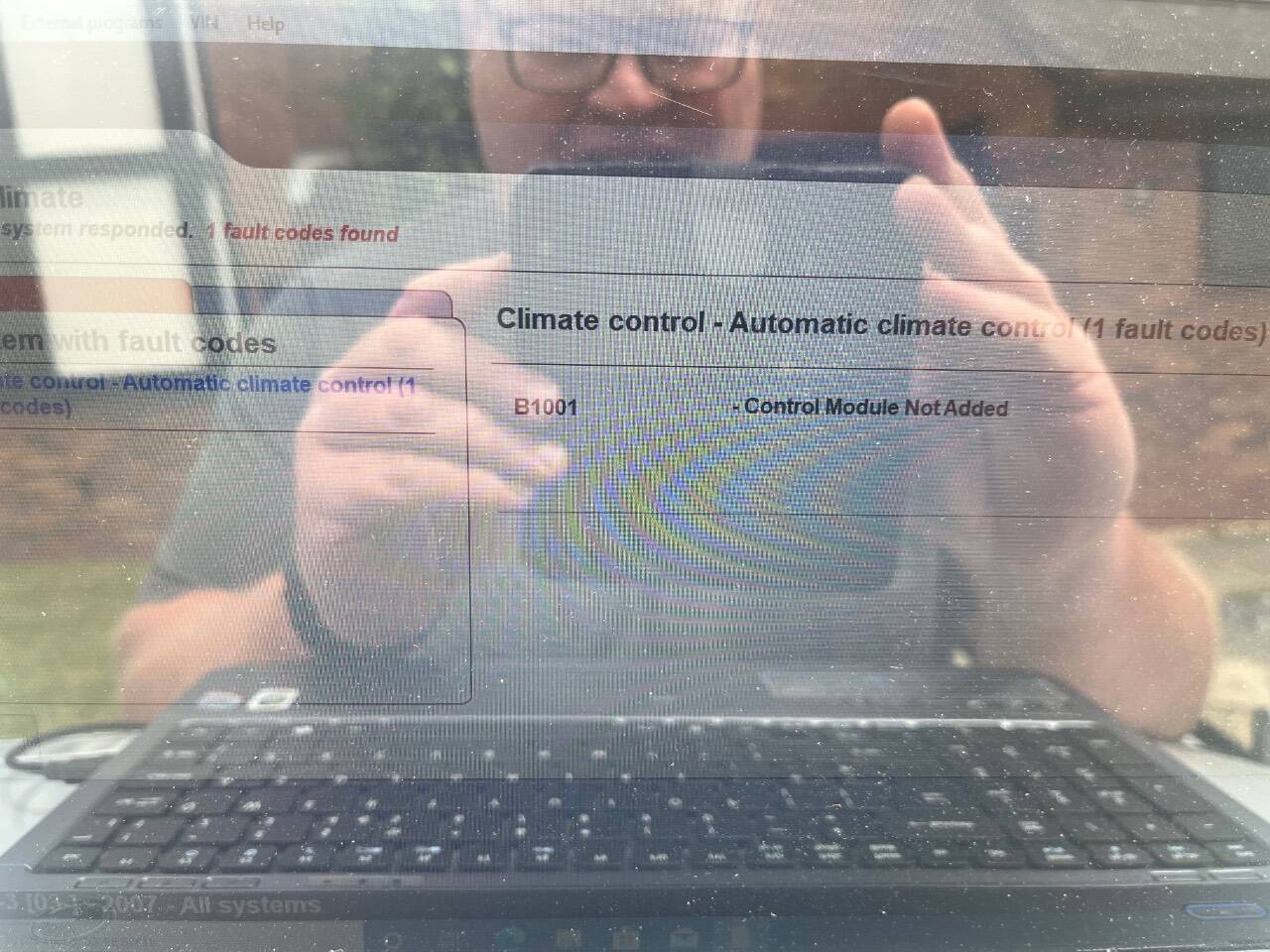

These are what showed up. Despite having continuity when I disconnected the ECU to test the wires to the fan relay, when it’s connected there is no circuit. I have no idea what control it’s looking for so I’ll have to have a search on Autodata shortly.
The parking lights have also gone open circuit so I think there are a couple more breaks I need to find. Unless the LED strips have packed up.
Stanky managed to get Delphi running on my gifted laptop and has loaned me his USB to OBD cable until I can get one. Thank you for your help today!

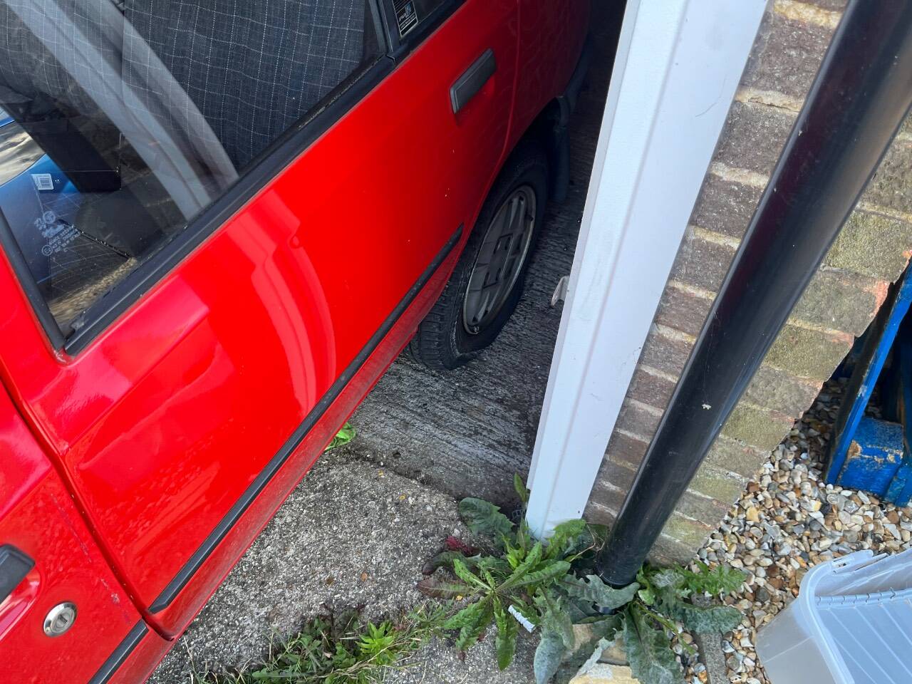

Having moaned earlier on grumpy thread I couldn’t get the jack under the Citroen a neighbour of mine has a C3. The jack is identical as to what should be included with a C2 so the car is now on stands.

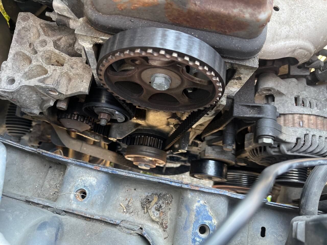

Gotta nip out for a T50 key as the last engine mount bolt is in too narrow a space for my 3/8th Torx set.
The belt is not in the best of health so I’m glad to have started this job now. I have seen worse on cars but as we intend to sell the C2 once this job is done it’s all adding value. There is no history of this car having had a belt done so I’m banking on this being the 2006 fitment from new!
At the point of no return now.
I do think this may have had a belt in the past as the tensioner hex hole was mangled, however I think only the belt was done as the pump is dated 2006, same age as the car (see below)
The is a little play in the spindle so it’s a good job I have a pump, tensioner and belt ready to go on. Just waiting for the last of the coolant to drain out and then I’ll refit stuff.

I turned it over by hand 5 rotations on some marks I had made and they stayed where they should be so I bit the bullet and cranked it over. It runs.
Just the ancillaries to bolt back on then job jobbed. I can then have a shower, some dinner and get it valeted for sale.

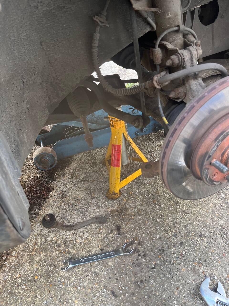

We hadn’t realised until this morning the Kia ran out of MoT yesterday, and not booked in until Tuesday 1st.
I had an examination of things.

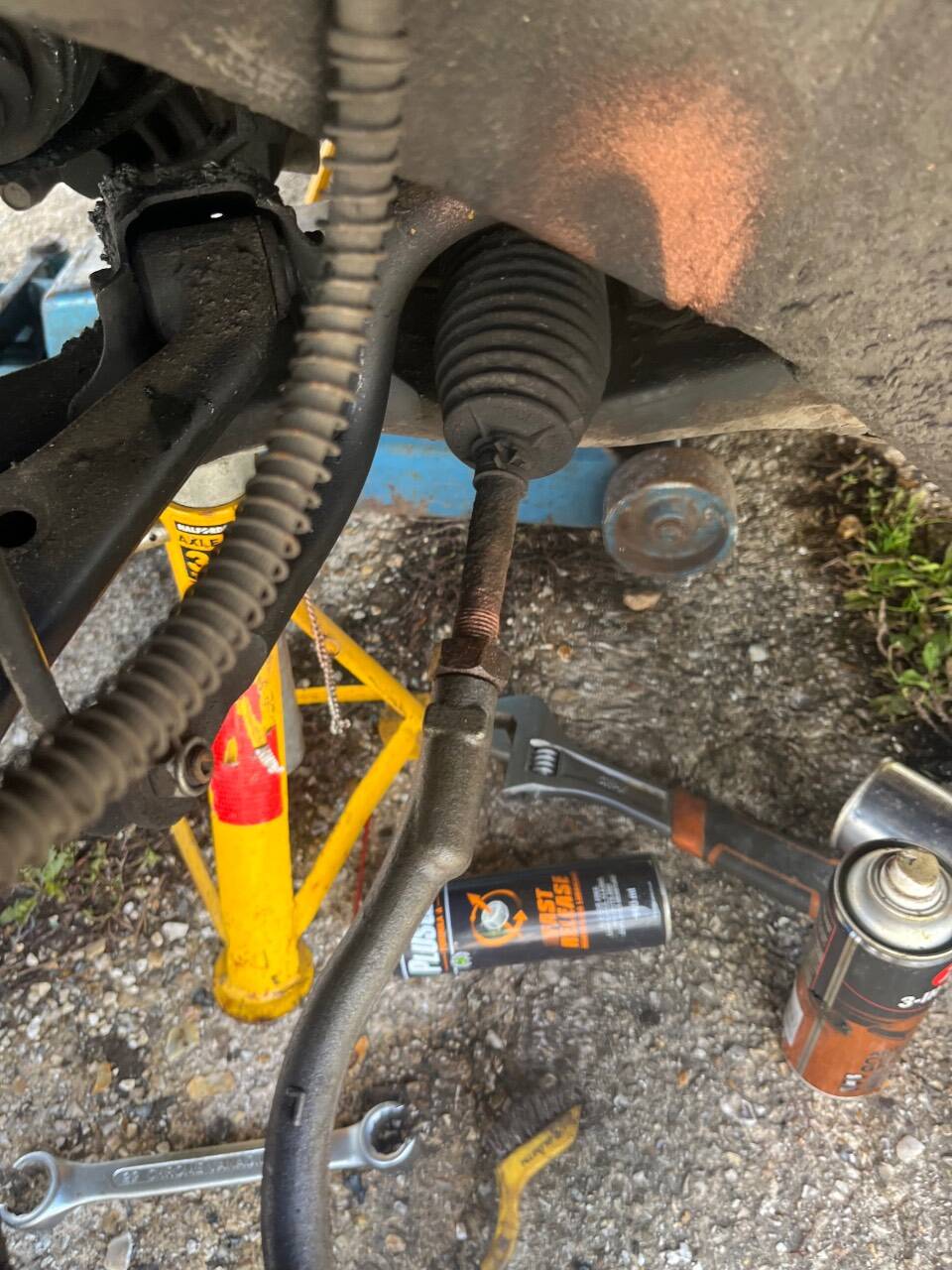

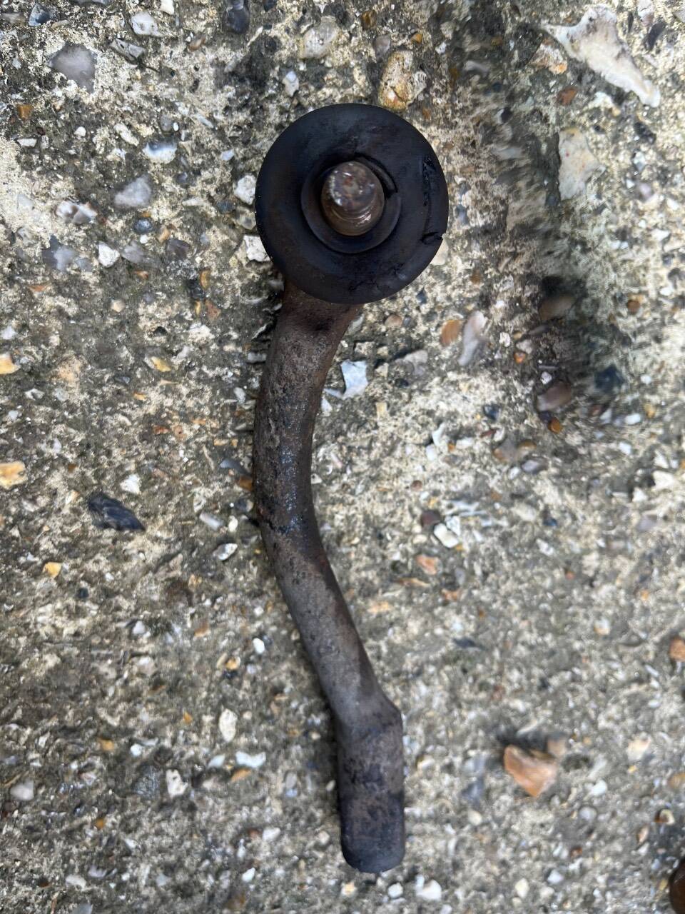

Thankfully TRE and not the strut top, bottom ball joint or wheel bearing. I don’t know where madam has been driving it but for a taper to break with the nut & split pin retaining it must had taken some doing.
After a lot of heat, plusgas, swearing, plusgas and more heat, I finally got the seized TRE off.
IMG_5113.jpeg.9dc9a59d14182d12ac2af3f6603d7501.jpegIMG_5114.jpeg.8c8bec884e3deb7b4866938374d8ab53.jpeg
I’ve wire brushed the threads clean and applied some anti-seize. Other side is now waiting for the plusgas to seep in and I’ll do that. I can then straighten up the slightly wayward steering this car has had since we got it. With grandchild cooking nicely this car has got to be bob-on.
