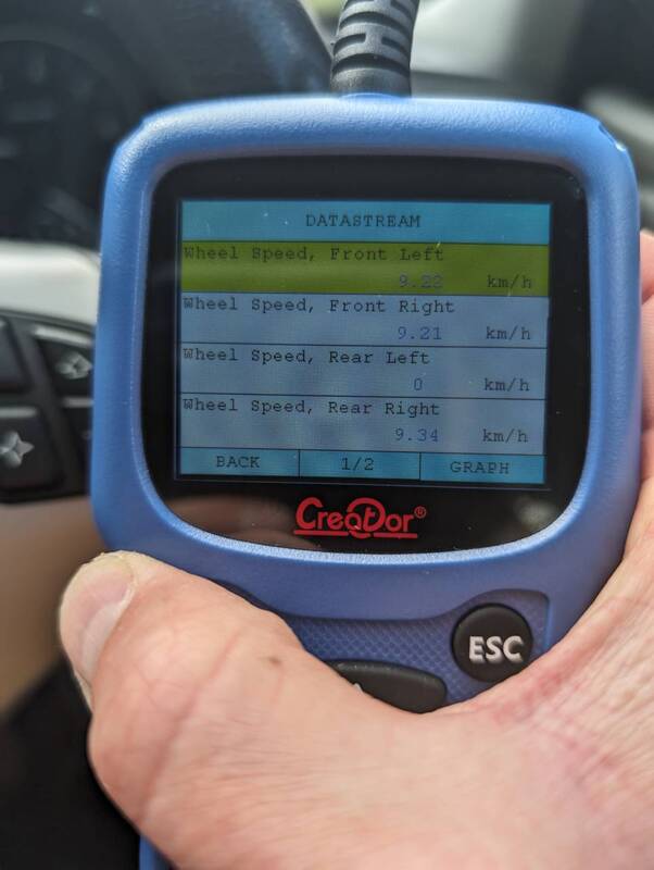

Just went out for a quick drive. ABS pinged up again. Rear left wheel speed sensor this time. Front right looks to be working perfectly fine after disconnecting/reconnecting it.
Maybe that rear left might come alive if I disconnect and reconnect it too?
Debating whether to just replace that front right sensor anyway and maybe that rear left too. But for now I'll see if I can get them working. I need to spend out on tyres, service and maybe a CCC if my rework skills aren't good enough to revive the original unit. Then any other bits and pieces it might need.

I replaced the rear left ABS sensor on my 325i a few weeks ago.
My old Creator whatever-the-number diagnose thingy couldn’t read it or tell which sensor, the BimmerLink app could.
Being able to leave the car running but locked without a key in the ignition, is great for defrosting on cold mornings. A bit annoying you have to start the cold engine twice (also, doors need to be shut or it won’t do it).

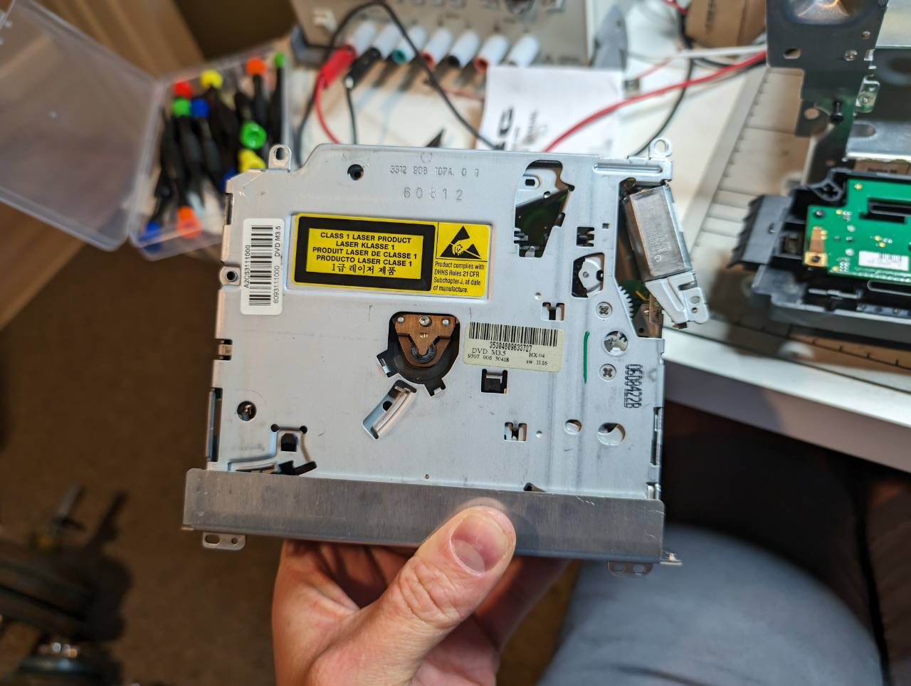

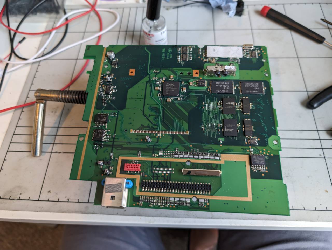

This E90 is really fighting me.
I bought some fresh liquid flux and reflowed the PCB on the BGA packages. This era stuff is when they moved to lead free solder and had varying levels of success. Inadequate cooling in these things and vibration really kills them. My CCC (iDrive) is hw 9.8 and apparently the most prone to failure.
I got the devices up to around 160c surface temperature but underneath will be a lot higher. I don't really want to get it much warmer than that and damage the parts.
However it didn't work and still exhibiting the same issues.
I strongly suspect the flash memory has been corrupted on the main application storage. I can see the CCC gateway through OBD but no other parts of the unit. The bongs to tell me that the ABS light is on, oil level is low and brake pads are knackered all work. So the sound generation must be fine. The display I can talk to over OBD which suggests that is fine too. I can hear the CCC dvd drive cycling every couple of minutes which suggests it's booting cycling.
Unfortunately it appears the only way of sorting that is removing the devices entirely. Not trivial with BGA packages. Plus I don't have a programmer suitable for these type of devices.
I have also read that a damaged navigation DVD can do it. It doesn't respond to the eject button. I removed that by pulling apart the unit and manually winding it out.
Bit of a crap shot and it didn't work either.
So what is the next step?
I might take it into work and get one of the technicians to look at it. We have a fancy IR automated rework station that I might jump on to reflow the device. That you can draw what parts of a PCB to heat up and it'll only do those areas. Serious piece of kit that is seriously expensive.
There is a recovery image that I've found which may be able to restore it. However I think it's not even starting up to that stage where it can read a disc. I.e. the bootloader is corrupted.
Might just call it quits on this unit and buy a replacement CCC. They can be had for £200 or so. I'll get a newer hardware revision so the chances of this should be reduced.

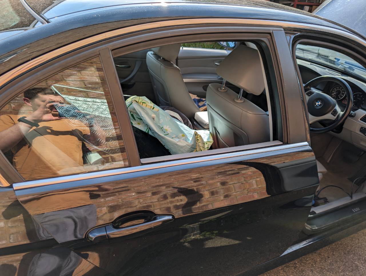

While outside fitting this, being a nice day, I had the windows open. When I went to close them, the rear right didn't want to close. Low and behold another common BMW issue - Window Bounce Back apparently. Never had this before on any other car.
Anyway after repeatedly hitting the up button, I got it out of the stuck spot and closed it with a fight.

 - iDrive replacement. I had hoped to get this fixed first as an easy moral booster! Looks like it's going to be a fight instead.

I have nothing to add to all that, the like was for the effort you're putting in, not the grief its causing you being an obstinate bugger.
It seems like you're getting through the niggles or know whats needed to fix them. Some very indepth and impressive ecu action going on too - well beyond my understanding but great to see you having a go at it.

Tbh I'm mostly in a grump as I'd thought the iDrive would have been an easy fix but it's not. 😂
The easiest fix is to just chuck a replacement unit in and code it up. Just there are different revisions with different joysticks and I'm not sure what is compatible with what just yet. I don't want to change the joystick as that means replacing trim.

You’re really in at the deep end with the Zed and E90. Just a couple of points also:
5w-40 will be fine. I’ve run 5w-30 in all of mine but it doesn’t use a sickening amount of oil (maybe a litre every 3,000 miles now). LL-04 any stuff will be alright. I’d recommend a MANN HU-816X filter though.
Your car doesn’t have rear reluctor rings. They use the wheel bearing as the pickup for the speed sensors. Also has a larger diff that doesn’t blow up like 4cyl models.
Otherwise you’re spot on, and hopefully once you’ve taken care of the big stuff you can forget about it. Headlight washers can be coded out btw, silicone spray helps them retract. As does door handles.
Interesting. Reverend Bluejeans formerly of this parish says they have a castillated rings. Looking at different parts databases shows two different types. Presumably one is bearing and the other is tone ring. RealOEM isn't completely clear either and does vary between engine type and year. I've ordered two different types of cheap sensors off eBay and we'll see which it is.
Problem is, if it is the bearing then I question what has failed. Ime the sensors on them rarely pack up. At least on other brands, BMW seems to have everything as a possibility... 😅
I'd rather it be just a sensor tbh. Much easier than getting the axle out.
So, it’s a bit of a minefield but reluctor rings are fitted to the smaller driveshafts on things like 318s and 320s. 6 cylinder cars did it like the older stuff and use the bearing as a magnetic pickup. 6 cylinder cars also have a different ABS module to include nicer features like cruise control that can brake, hill holder, brake drying, smooth stop assistance and brake fade compensation.
Agreed! Even if the sensor is a git to remove.
